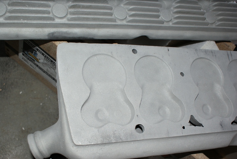

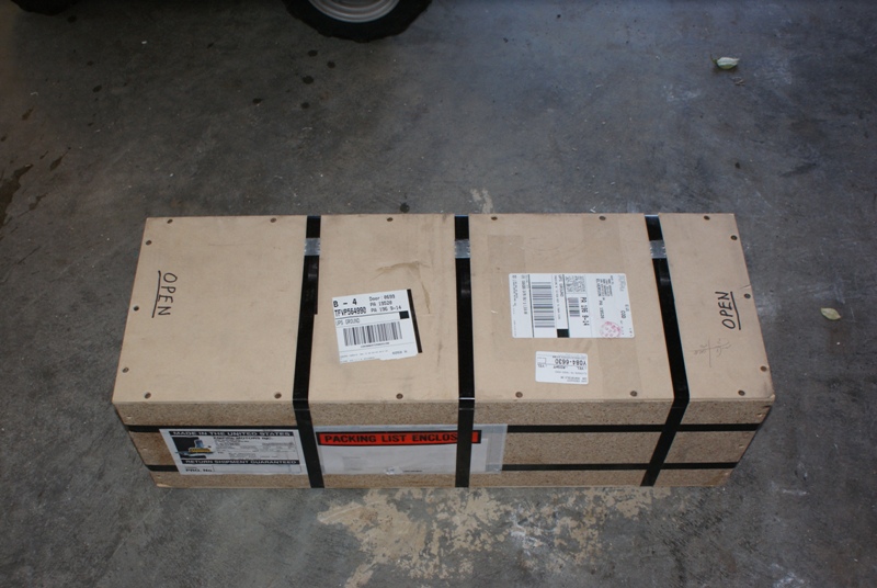

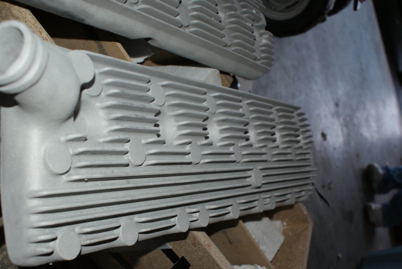

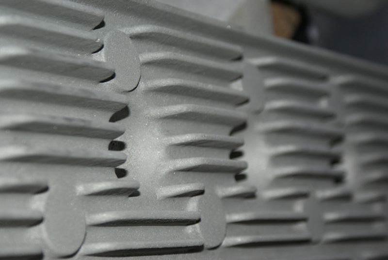

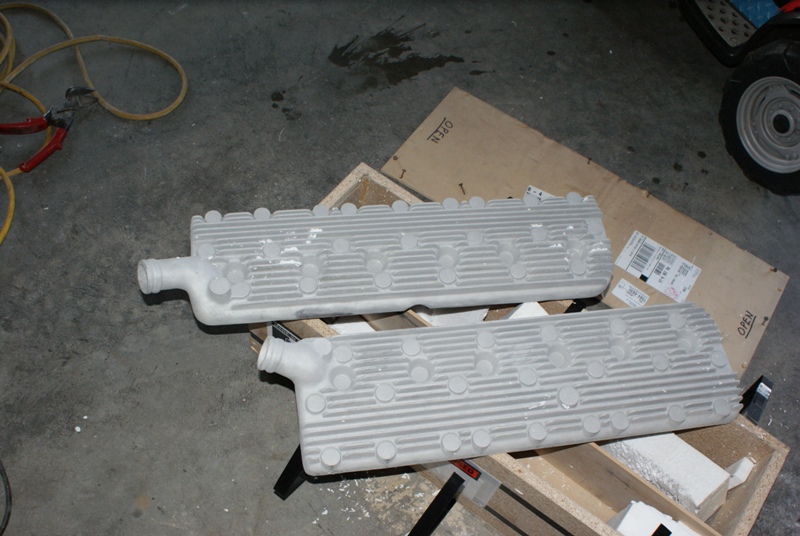

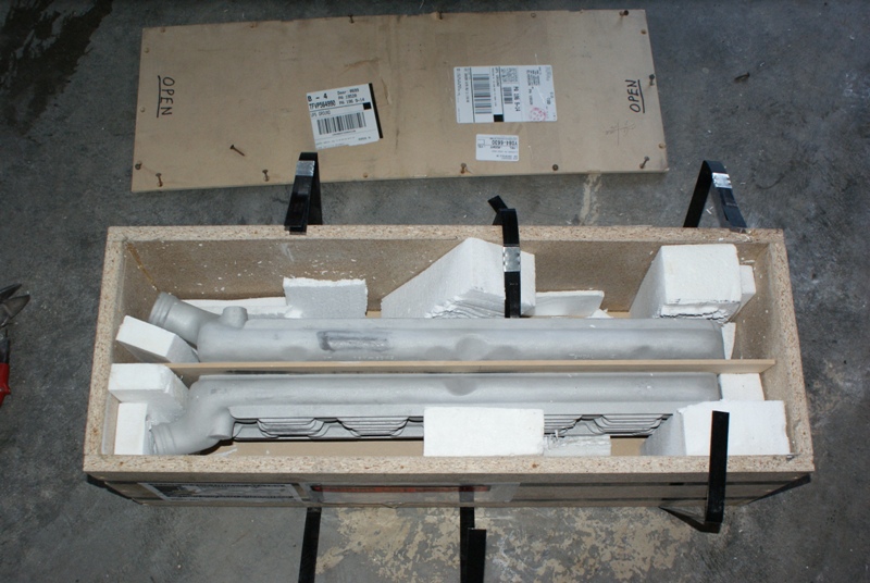

    The heads came today....and they look really good. :)
    They were created so that explains some of the highish shipping cost.
    There is a touch of porosity on the as cast gasket surface but the castings are designed to have 1/8" removed during machining so that would probably clean it up.....but I want all the height I can have in the chamber so I'll probably weld up the couple little areas. The side that shows is nice...some sand gain size dusting of aluminum here and there, but that will clean right off.
    over-all very good.
