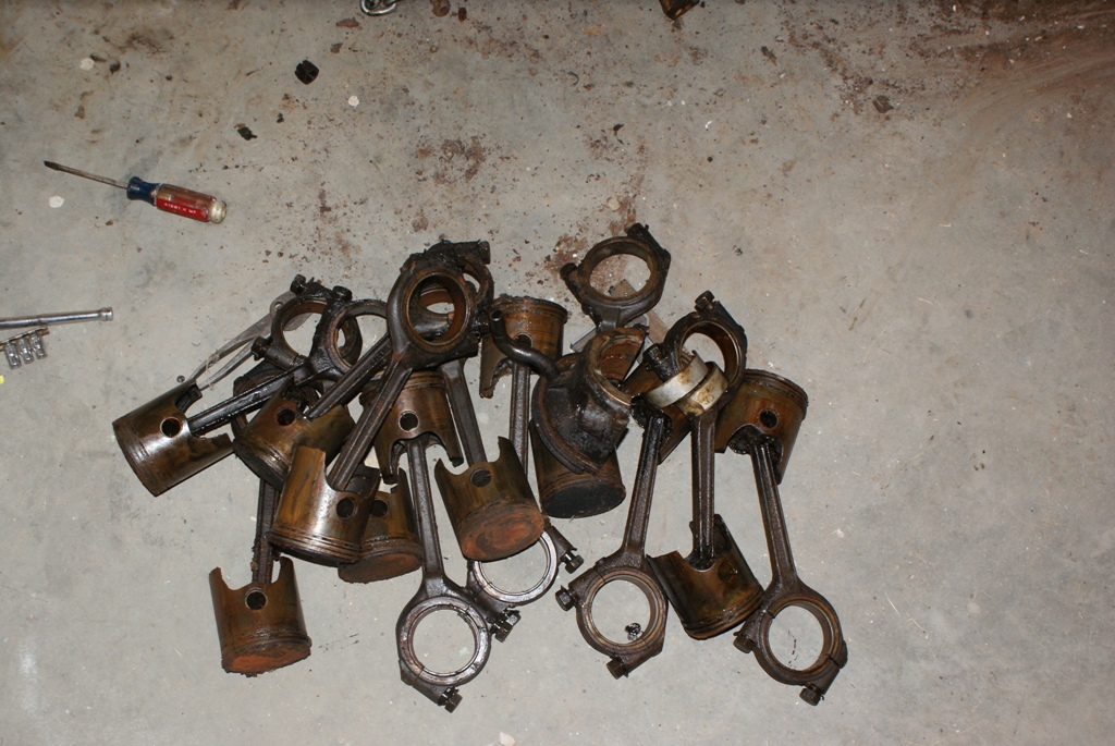

    I finally popped the pistons out last night. I'd been putting it off because looking at the condition I was expecting a multi-day battle involving a big hammer and probably a chisel and grinder......so it was a very pleasant surprise when the whole process was over in under 1 hour with 0 drama :)
    After they were out though and I actually had a look at just how frail the rods and wrist pins are....WOW :eek:
    This all got me thinking a bit. I'd been going round and round thinking about having the stock crank offset ground since the journals are so large and it's SOOO much cheaper than having a crank made......but it kept bothering me that the factory increased the journal size in the later engines and the thought that un-standardizing is just NOT the ford way...so why do it?

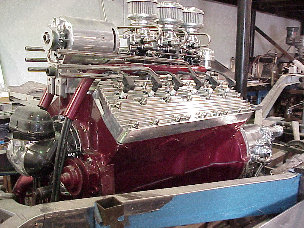

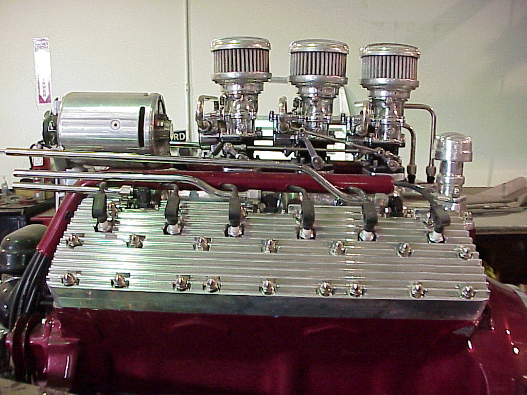

    Here is mine, I have a extra set of billet heads, 4x2 Ken Austin intake and N.O.S.(as in never bolted to a motor) complete distributor if you are interested.
    kidcampbell71 likes this.
  6. roseville carl
    Joined: Dec 29, 2008
    Posts: 5,218
    roseville carl
    pure flathead ****
    Atwater Mike and grapeboy like this.

    I haven't decided what I'm going to do about ignition so I might be interested in a distributor at the right price.
    Heads I have and it will be getting a blower and I'm trying to figureout how to remove the 90 turn from the intake track so most likely a custom intake.

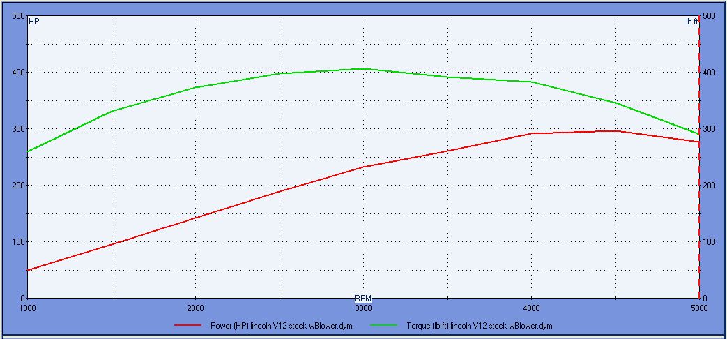

    So here's what I get out of the simulator with a pretty mild build at 7 psi....300hp/400ft-lbs. This basically matches what I see quoted from H&H on there blower builds..they say 250hp but I'm pretty sure they told me 5-6 psi so I've probably got the boost a bit higher and I specd a smallish screw type blower spining fast not a biggish roots blower spinning slow.....so that is probably 50 hp the difference.
    But it looks pretty good for my application so I'm now really torn on how much effort to put in on the flow stuff.....some for sure but I"m not so sure about all my plans to split and fill ports and other ***orted craziness.

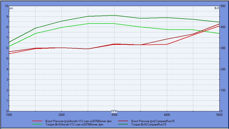

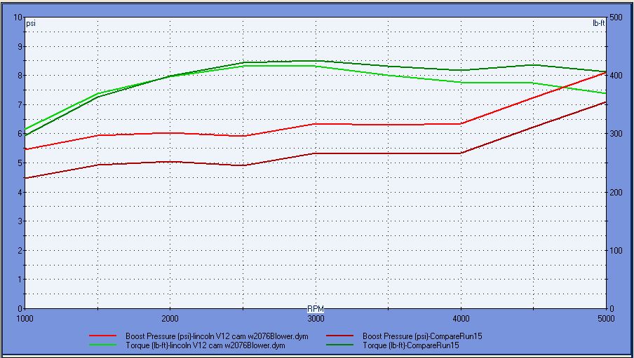

    For anyone intereste.....here's a graph showing a 1.6 liter/rev screw type blower compared to a B&M 144 roots blower.
    The green line is torque, red it boost . I played with drive ration to get the boot matched at my 4000 rpm redline. Notice there is a CLEAR winner performance wise.
  11. mk e

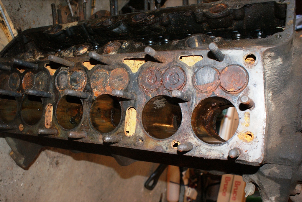

    I'm supposed to be working on finally finishing the stupid ferrari engine and I did some of that last night but....I also popped apart one of the piston/rods and had a look at the combustion chamber on the lincoln.
    You guys used to this stiff know this but to me these look like 2 stroke pistons...they are so long. It's also surprising to me how far the wrist pin is from the rings.....it could move up 1/2" and cut 1-1.5" off the piston length....which of co**** got me thinking about stroke again now that I know for sure cylinder/piston wise I could add 1+" of stroke with no issue .
    Tonight I need to drop the crank back in and have a good long look......

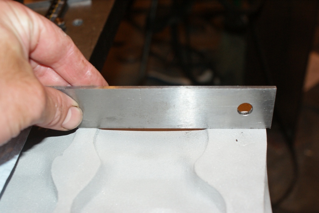

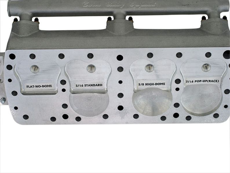

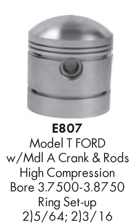

    I also took a quick look at the combustion chamber to start getting my thoughts in order.
    These heads have stock chambers, but the rough castings about 1/8" of extra metal on the deck surface for finish machining......but the surface looks pretty good and with a little press and tig work I'm thinking I can get them clean with under a .030 cut....so a net gain of about .095" -.100".
    I'm pretty confident that I could cut 1/8" into the chamber with no issues.
    I can fill anything I like with no issues.
    So what to do exactly..........
    My thought at the moment is I'd like this build not to be the 6 year ordeal the ferrari build has become so I'd like to stick to known good options.
    M***ive pop-up pistons have a race only reputation with pretty much everyone I've ever run into and while there may be a way to make them work on this build it just seems like way more risk than it's worth.
    Flat top pistons are pretty much the norm for the flathead world so I'm EXTREMELY tempted to fill in the chambers and use them.
    .....but I also know a lot of people have messed with this stuff over the past 80+ years and the fact that there is no "you must use this chamber" answer
    The hot head these days seem to be the Navarro with the 5/8" dome so I'm thinking I'll do something like that....and while digging though looking at stuff I found some so pics of performance model T pistons....which look su****iously like the Narvarro design....and every old is new again :)
    I have to think its not quite as critical as some would have you believe but it does make sense to me that rounding the back of the chamber is going to make the air flow better and it is a well tested and proven design so I'm leaning heavily toward doing about a 3/8" dome.
    Right now the heads are at about .330...they will drop to .300 when I cut the decks then I feel good about going up to another .125....so .425" max

    I couldn't help it....I had to make another gragh :)
    4.5" stroker (light green/red) vs blower at 7 psi (dark green/red)....pretty much a draw.....but I know the blower is possible a 4.5" stroker crank in the block....I'm not so sure yet.

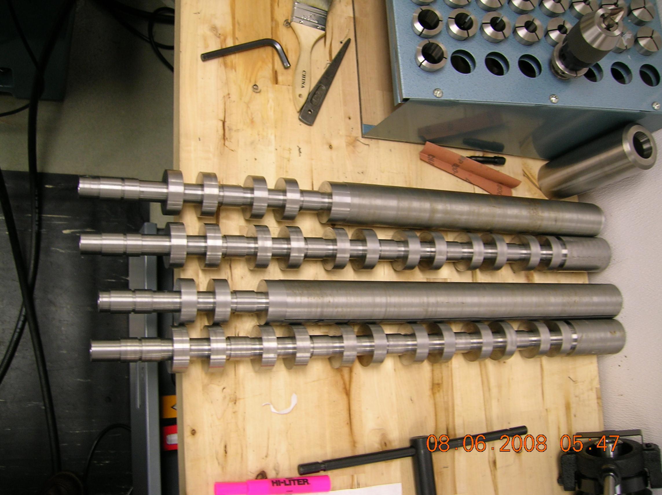

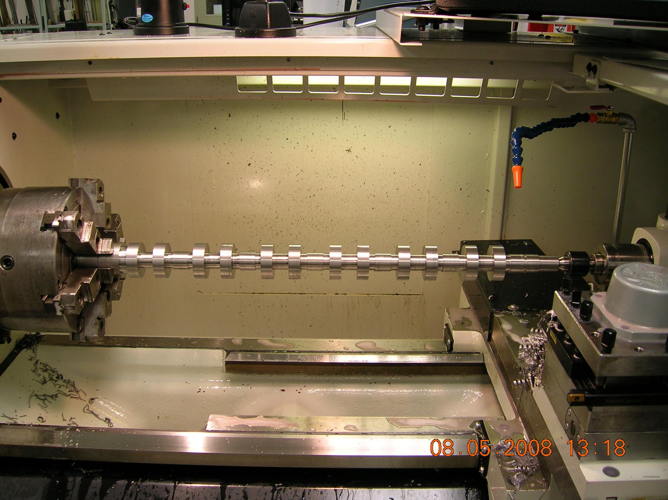

    Yeah...last I knew Web gets about $100/lobe to weld and grind to whatever spec, $60/lobe if it's just a regrind with no weld so $1500-$2500 depending.
    I don't see any need to do a billet cam for this build but I did have made billet blanks for the ferrari build....and then $100/lobe, (4 billets, drilled end to end, 48 lobes) to get them finished.
    Deuces and kidcampbell71 like this.
