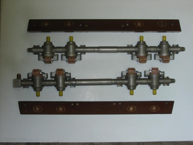

    I'd particularly like to see pics of how you mounted the injectors. I was considering putting the injectors in the valley but had honestly decided it wasn't practical and was planning to just spray into the port while the valve was open and hope most of the fuel go into the cylinder......but pointed at the valve what I'd prefer.
  2. I actually tried to attach some pics to my post but for some reason it didn't work. I'm a bit of a klutz when it comes to things like that. I will figure it out and put some up. Meanwhile, there are some photos of my other tuned-port engine on another thread about flathead EFI. If you search my other posts you'll find them. There aren't that many. Mounting the injectors in the valley is a real squeeze and I don't know if the Lincoln has as much room as the 59A. I think some modern engines have smaller injectors than I used though so it might still be possible. I drove that tuned-port engine 40,000 miles over eight years in my '36 coupe and the installation was trouble-free so I guess I can say the concept is proved. Fellow HAMB brother Vergil has also done a similar installation.

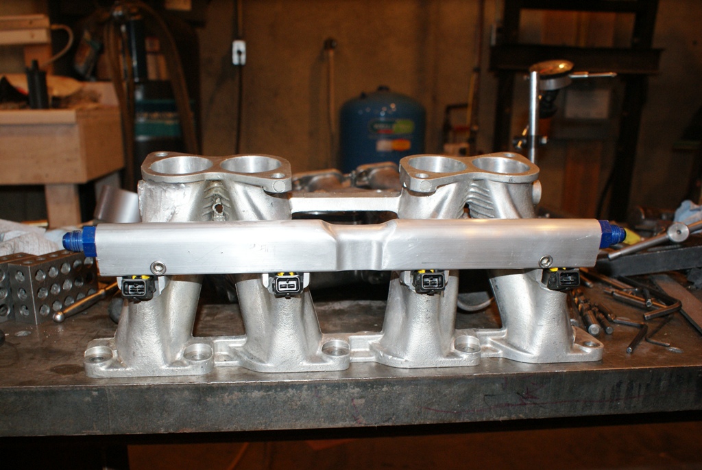

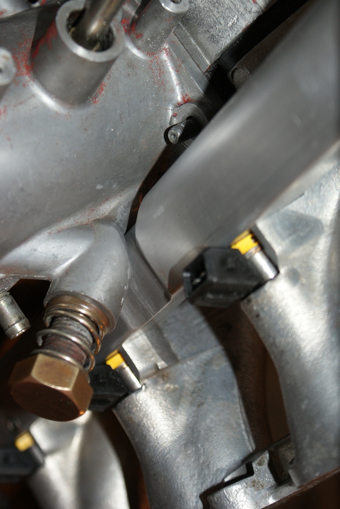

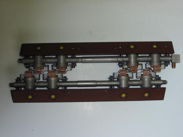

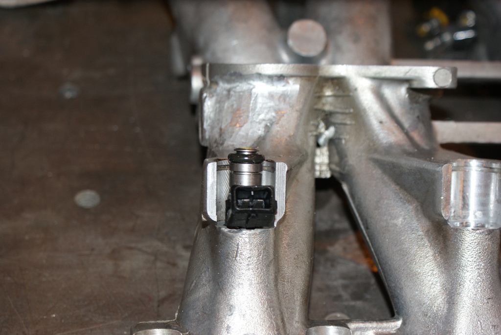

  5. Here are a few pictures of my injector mounting system. Not great shots I'm afraid but they should convey the general idea. The mounting blocks are made of Tufnol (fabric reinforced phenolic resin) for its heat insulating properties and proven ability to "live" inside an engine. It's the same material timing gears are made from. Injector wiring is stainless steel with PTFE insulation since ordinary PVC insulation will soon go brittle in that environment.

    Very cool!
    How did you machine the block to accept it.....go in through intake port?

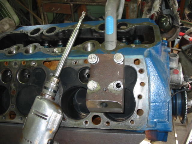

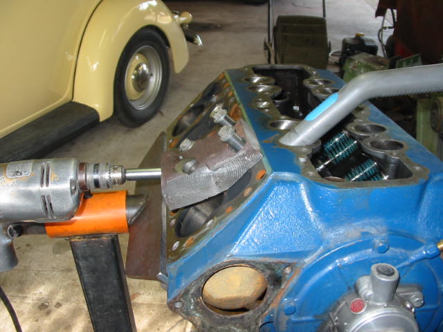

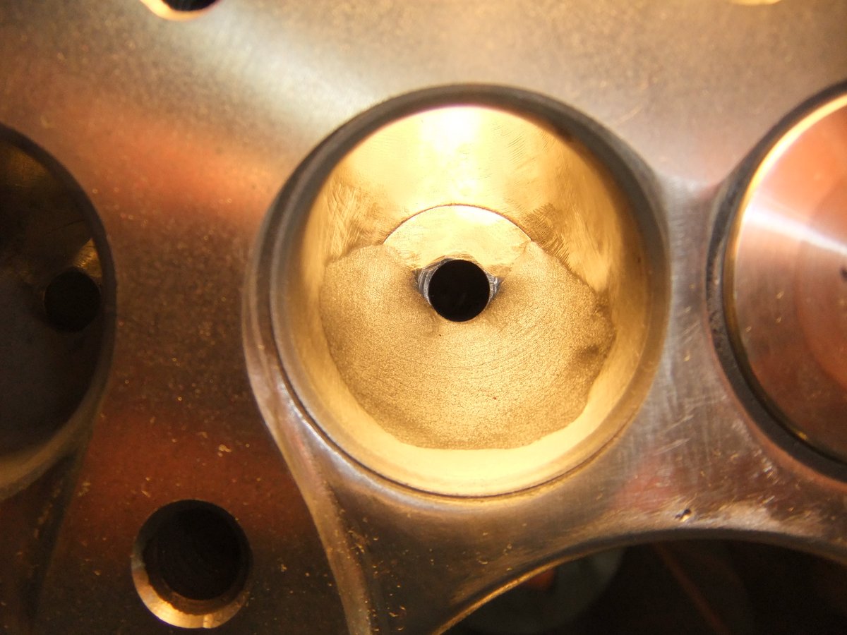

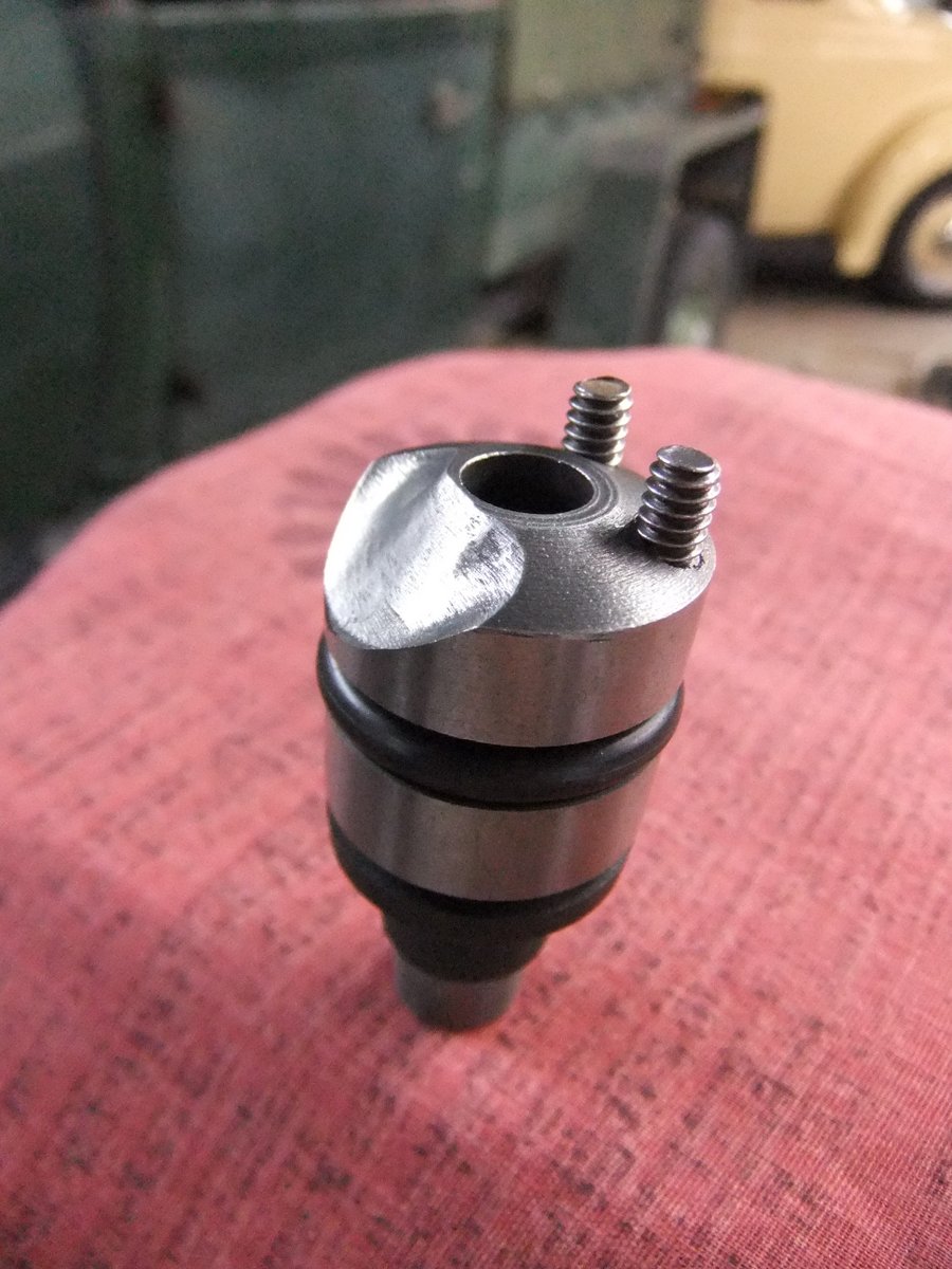

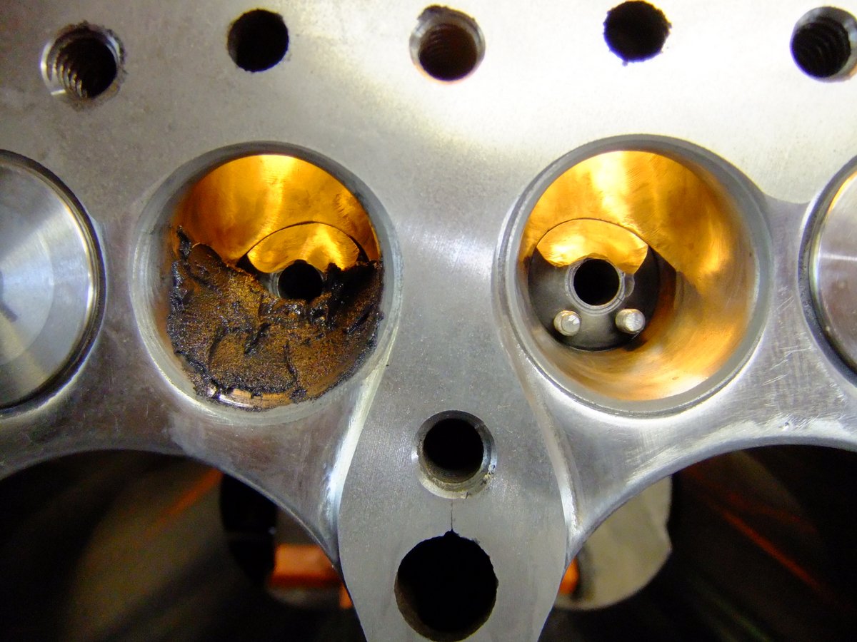

  11. I did my first one of these on an ***embled engine so any major machining was out of the question. I drilled a hole in each port for the injector to squirt through using the jig pictured. It's a lump of cast iron from an old railway brake shoe machined to do the job. I've loaned it to someone so don't have it here to refer to but I think the cutter is a 10mm end mill pressed into a piece of .625" steel bar. A vacuum cleaner shoved down the port ****ed the swarf away. I needed to create flat surfaces in the valve chamber for the O-rings in the injector blocks to seal against so oil wouldn't be ****ed into the ports. To achieve this I applied a "doughnut" of Devcon plastic steel to the engine block around each injector hole and then clamped a smooth steel bar in place while the Devcon cured. I wrapped the steel bar in cling film to act as a parting agent. This worked a treat.
    For my next engine I mounted the bare block on the mill and machined the sealing surfaces flat but I was afraid of breaking through into the water jacket and they didn't quite clean up before I chickened out. I ended up using a little Devcon again to fill the low spots.
    The injector blocks are held in place with 3/16" cheese head capscrews in holes drilled through the bottoms of the inlet manifold bolt holes. The screw heads will just fit inside the root diameter of the 3/8" UNC threads. The screws are not perpendicular to the mating surfaces - not ideal - but the caps on one set of injectors **** up against the caps of the opposite set so tightening the screws produces a wedging action.
    One of the neat things about this whole setup is you can use any kind of intake at all from a stock single-carb setup, using the carb only as an air valve, to a blower as on my later version.

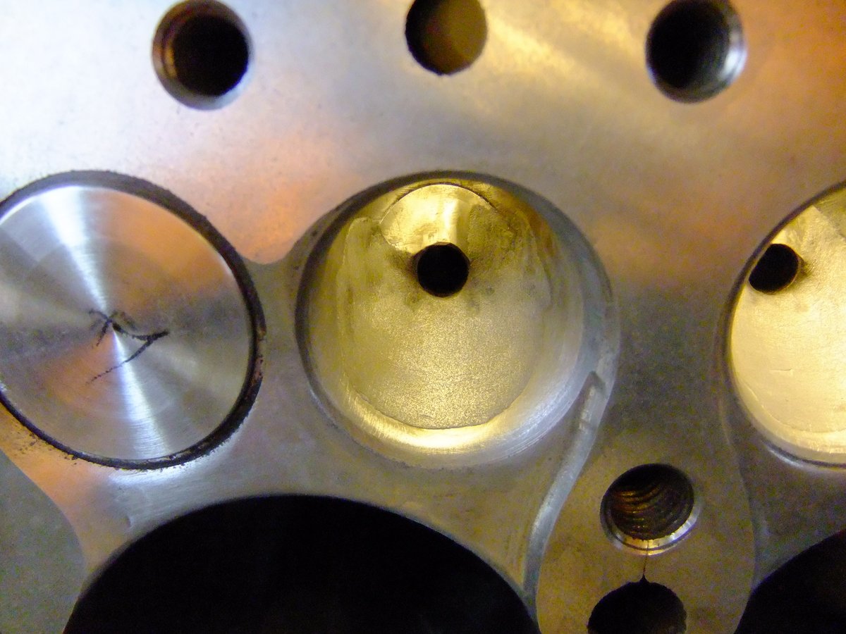

  13. I reasoned that flathead V8 ports would flow better if the sharp corner of the bowl behind the valve stem was filled and blended into the bend in the port. I don't have any data to prove this - it's just a theory. Twenty-something years ago I tried putting some Devcon in there but one piece came loose after a couple of hundred miles and went through the engine so I dug all the others out too. About ten years ago I tried again. This time I drilled and tapped the tops of the guides and screwed a couple of 3/16" studs in there. Once I'd Loc***ed the guides in place I moulded Devcon around the studs to hold it in place. I recently pulled the heads off this engine after 40,000 miles and was pleased to see the Devcon filler has remained in place. The paper-thin edges where it meets the port walls have crumbled away, leaving maybe a 1 mm step in places but I think there is probably still a net gain in flow by having it in there.
    Again, I have no evidence that this works but if anyone has done some flow testing on filled bowls I'd love to hear about it.

    I've bee trying to figure out how to do something like that by bolting in aluminum or maybe with just plain old solder......something like that. But first up will be testing it on the flow bench to see what really helps and what doesn't much matter.....but it will be summer at best before I can get back to this project I fear :(
