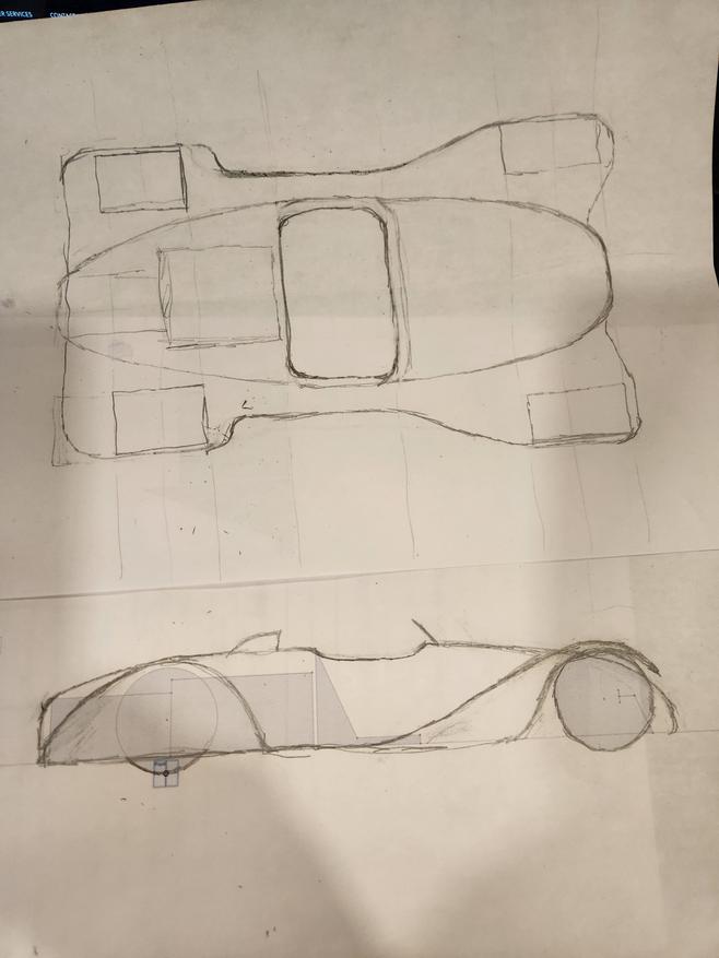

    Did some mindless shop time tonight on the ferrari V12 and while there got to thinking about early mid-engine setups like the 1938 miller gulf specials....so now I'm trying to sketch something that looks of the period but 2 seats and a little prettier (to me). Kind of keep the back but drop the nose a bit.....and I was thinking I want fenders to make set-in entry easy.....I turned 60 a couple months ago so....yeah. once there is a body plan I'll know if I can plan on mounting the blower on top or I need a different solution. The general focus will be very light weight, birdcage space frame and I'm **** with sheetmetal so composite body work. Like a 1500lb target so 250hp is enough to make it snappy...but I do think I can wring 300@4500-5000rpm out of it. We'll see how much I post here without breaking any rules.
  15. mk e
    Joined: Sep 12, 2012
    Posts: 241
    mk e
    here is what I kind of came up with...I'm not much of an artist but its kind of 30s looking and 2 peolple plus the Lincoln engine fit
