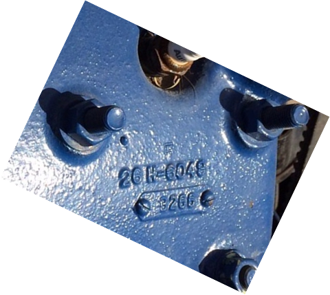

    Good morning, i buy this engine. I din’t understand if is a 267 or 306, can you help me?

    The date code on the intake appears to be November 22, 1945. Is there a serial number stamped on the bellhousing or anywhere else on the block, it may ***ist? Someone else should know how to date code the heads?
    Also check out the carburetor tag
