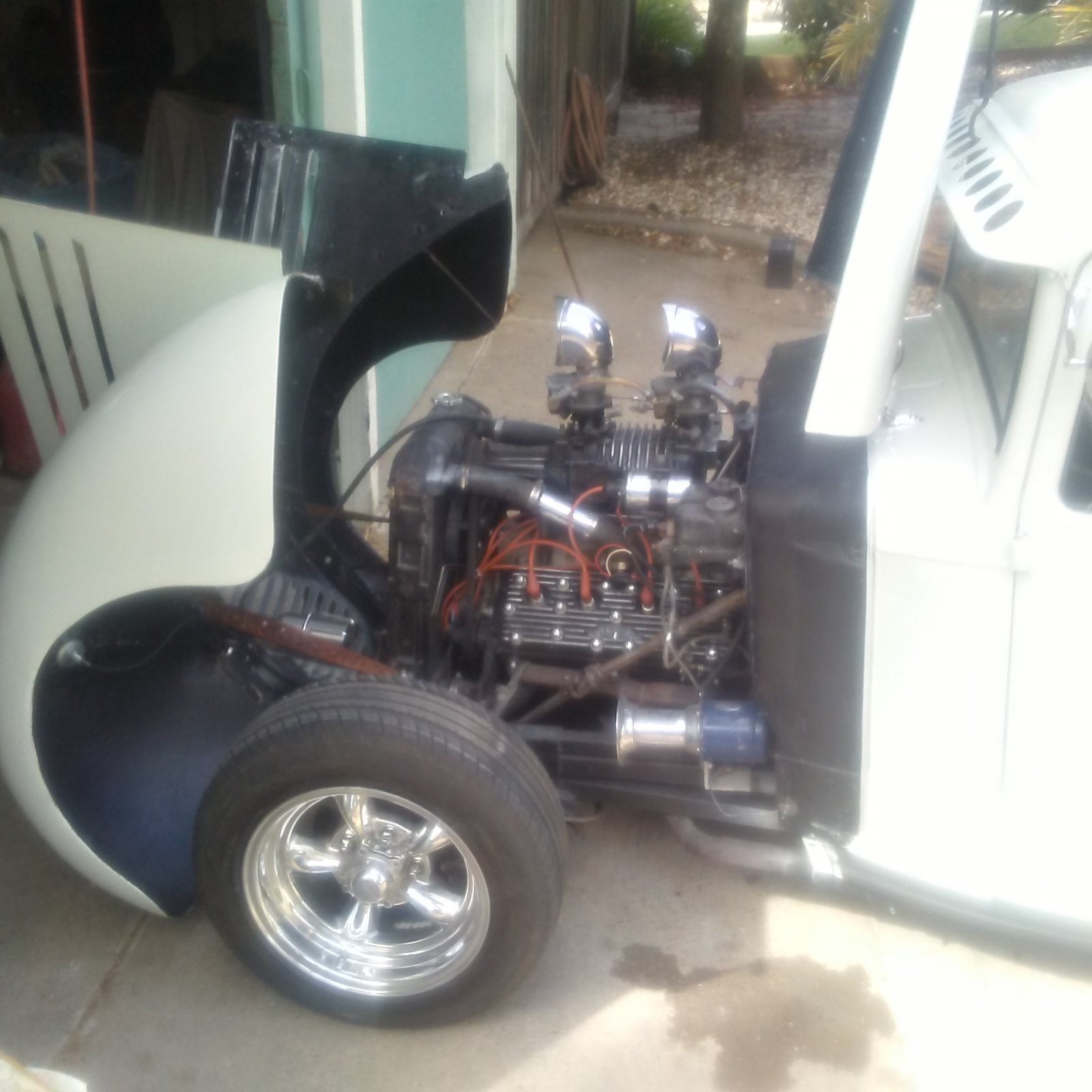

    My Bantam goes great. 1,500lbs, 4:11s and some squeeze. But even off boost it'll accelerate from stoplights as well as the average new car.
    Toms Dogs, mgtstumpy and Stan Back like this.
  10. Blues4U
    Joined: Oct 1, 2015
    Posts: 8,221
    Blues4U
    from So Cal
    Not to derail this thread, but that blower look interesting, looks like one of the Eaton superchargers, modified to accept downdraft carbs. Would like to hear more about that.

    Sure is, here's my thread on it, been on there almost a decade. Too small for anything more that the 60 but there are larger ones.

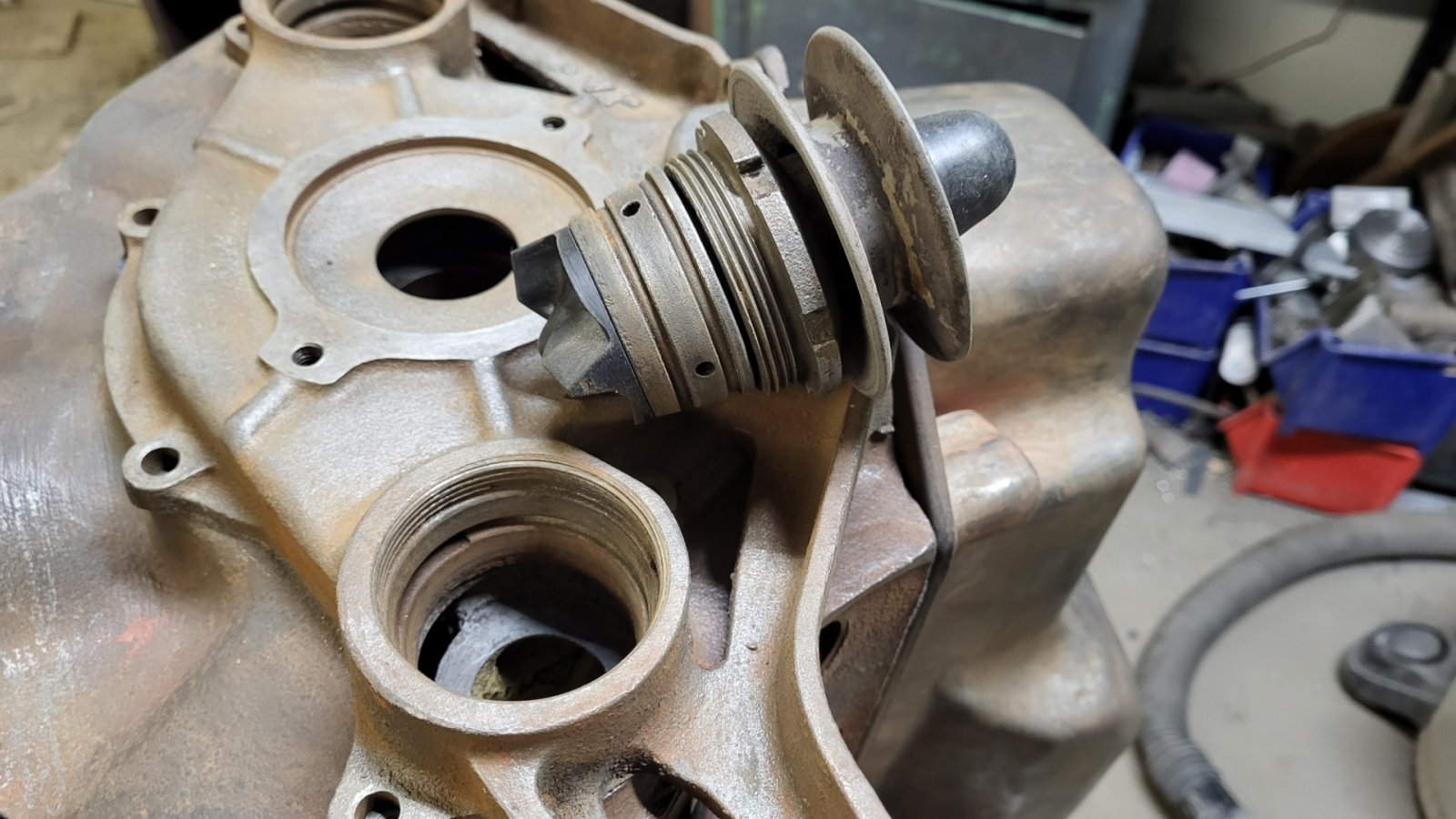

    Had a water pump go bad. Grabbed another off a spare engine but I can't get it to start the thread, something inside is catching just before the threads hit. Does this look right? upload_2024-1-2_15-54-52.png

    Will the one off the good engine screw into the donor engine ? You might have tried that already.....had something simular on a 5/8 fuel line.....

    I'm ***embling my V8 60 so I took a shot of my water pump. I rebuilt it, and without the O ring seals, it went in without the impeller contacting. My engine is a '38 or '39. Yours looks different. Could it be from a '40?

    Hmm, your pump looks different than the used one I'm trying to fit, visible in my photo above. I don't know the years, and my old pump is gone, did the design change in '40?

    I'm not the expert on these engines, but they did change the crankshaft diameter in 1940. There were some changes in the water inlet in maybe '38 and '39. My inlet threads in and I have a junk block that has provision for a three bolt flange inlet. Since the pump body seals in the front motor mount, that could be a design change for certain vehicles.
    The rebuild kit is very complete with bearing, shaft, impeller and o rings.
