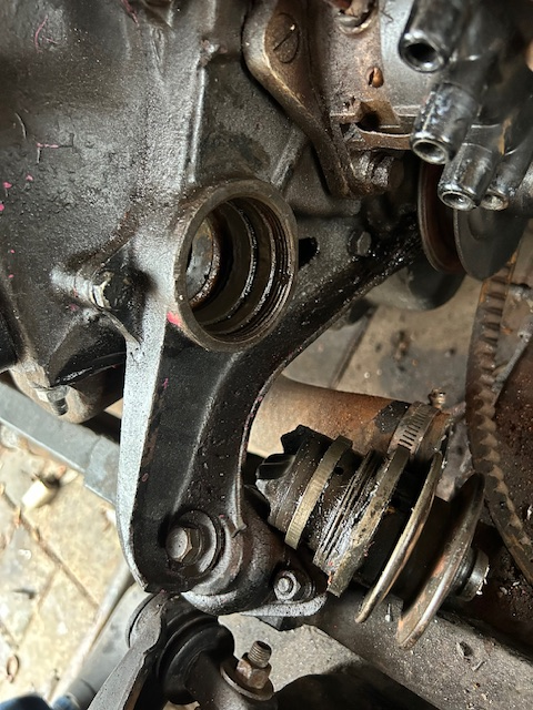

    The area between the impeller and mounting flange looks different on yours than mine, see that (that's the new/used one in the photo)? I would take my other one out but I broke the old one beating on the flange (and threw it out), don't want to do that again!

    Issue solved, partly..
    Samdcrab brought his pump over and sure enough, most places just advertise ‘v8-60 water pump’ but there are two types: early tapered ones, like he pictured on the previous page, and the later type which I pictured, which won’t fit my early mount.
    I now have the option of finding an early tapered pump (and rebuilding my other pump, most likely), or taking the front engine mount off my spare engine (which I have the later pumps for) and going through the trouble of swapping that in.

    They have a tappered and straight type water pumps, different years. One will not fit the other, new to v8 60's but learning and trying to build one now

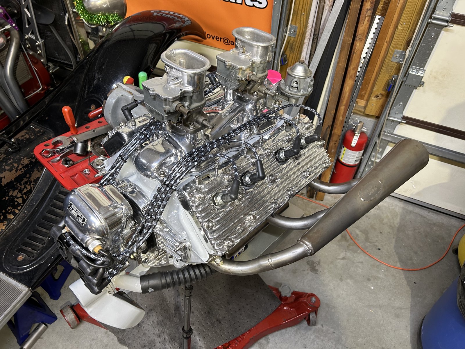

    Picture of V8-60 taken this past Spring. It was in an English Ford Thames if I recall correctly.
