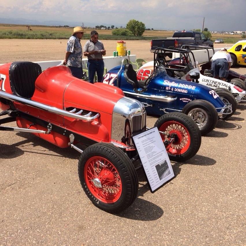

  5. 29 Speedster
    Joined: Aug 2, 2011
    Posts: 197
    29 Speedster
    from Colorado
    image.jpg Our Flat Tail Race Car (and others like her) has a Tube Axle with Split Wishones. Seventy Years and counting.
    volvobrynk likes this.

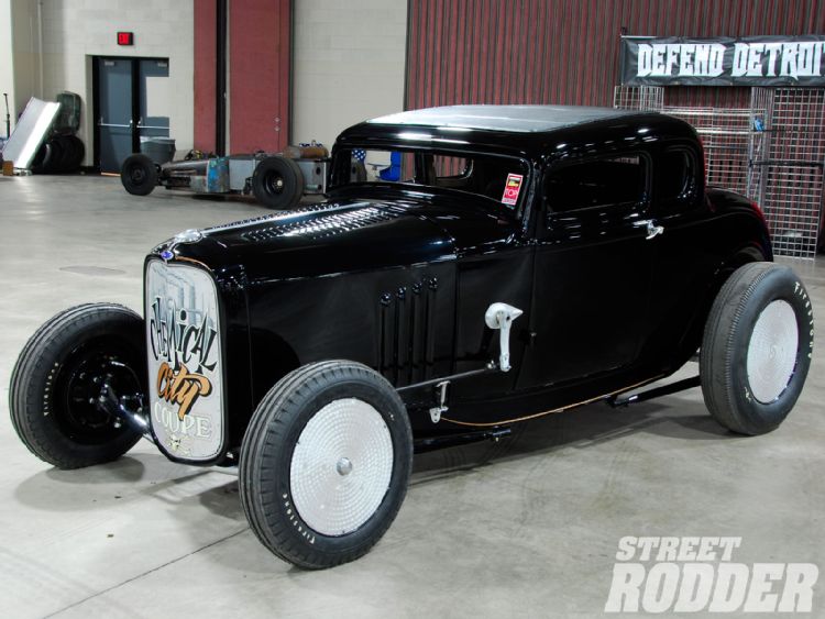

  11. Lots of miles on mine, V8/60 with split bones IMG_1993 (2).jpg 1307sr-01+dave-grays-1932-ford-coupe+driver-side-front-view.jpg IMG_20130929_143702.jpg ...
