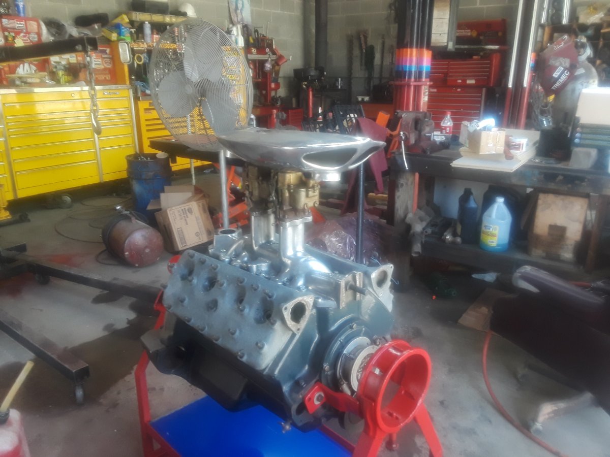

    48fordnut likes this.

    You can start them on a couple of tires so why not that stand.
