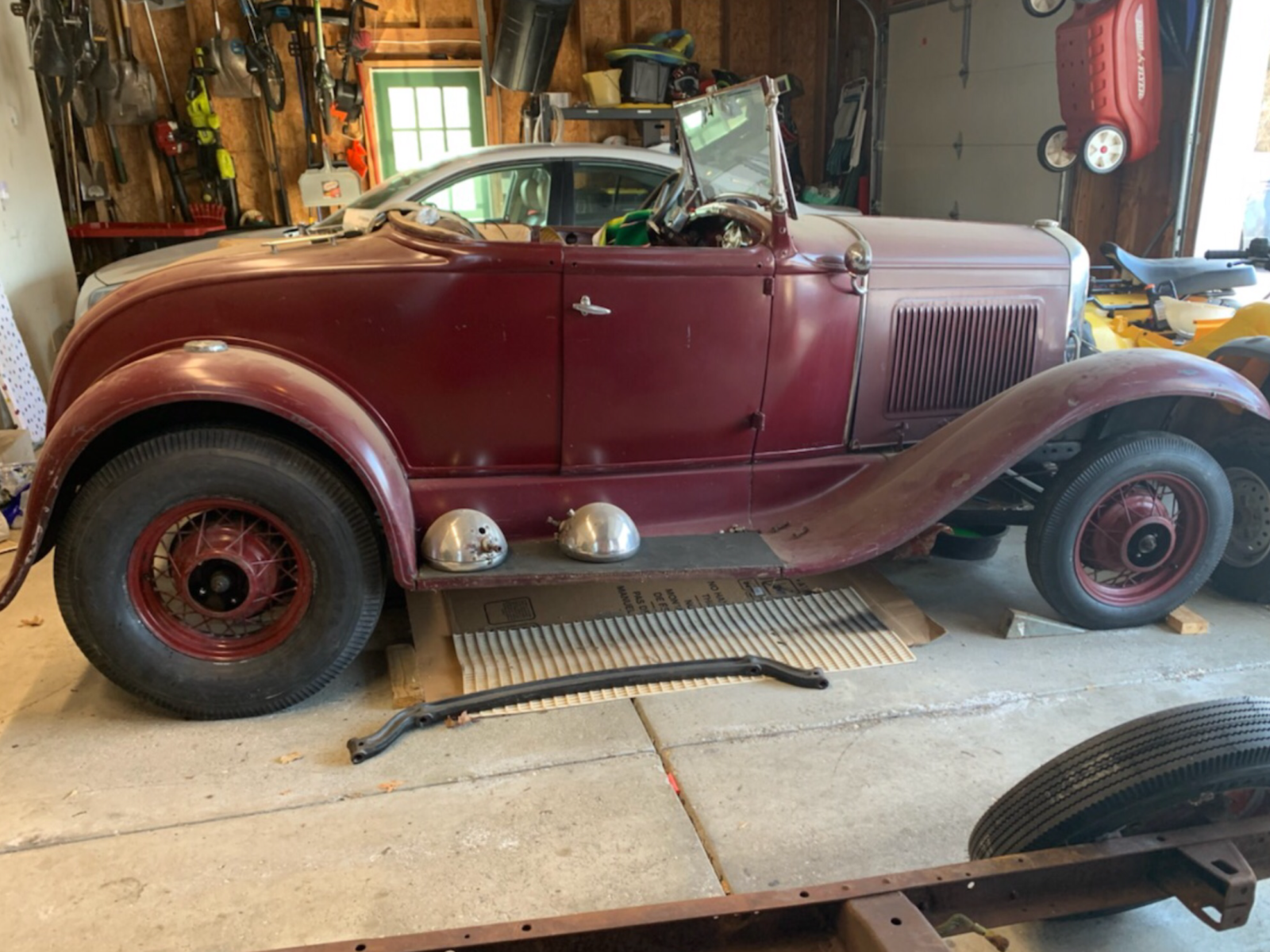

    It’s for my son’s 31. Will be running a 283 with a 39 trans. He acquired a super clean 42-48 rear end with the torque tube and wishbones, so he would like to use it if it isn’t too wide. If it’s 3/4” wider per side that doesn’t sound like much, but would really like to see some pics! Hopefully the tread on the 7.50’s would be in the fender…not too worried about the sidewall bulge not being in the fender.
    Before pic…we are building a different A chassis, and will swap the body over.

    Fendered car you might not be happy on the wide width.

    Not too crazy about the wheels way in the fender either. I’m sure way back when, they were built both ways!

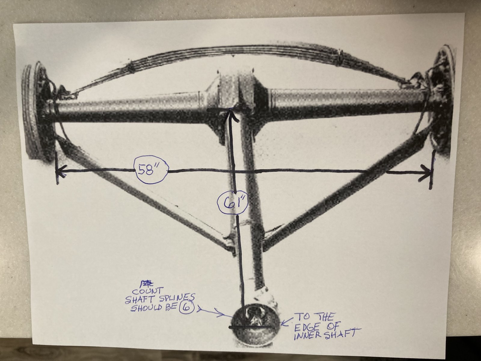

    dwollam likes this.

    I got my 9” rear from Pete& Jakes for my 31 coupe. It was 56”. But I did get some tire rub and put 1/2” spacers on both sides. 57” might be good.
