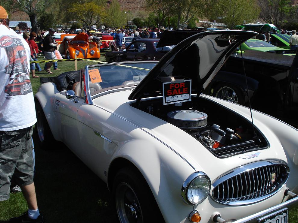

    This is a fiberglass kit car but the sbc seems to fit nicley.
  10. Thorkle Rod

  14. Thats an Austin Healey 3000-alike - not a Sprite. Different animal entirely.
