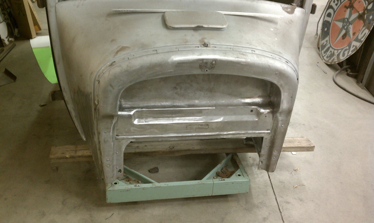

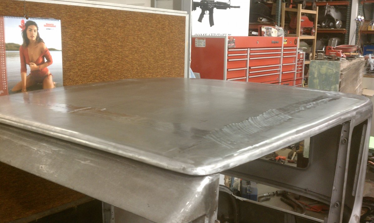

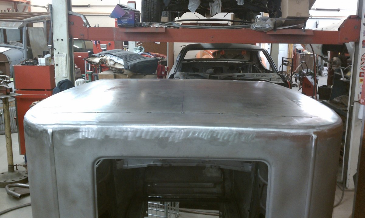

    I cut my original firewall out and reversed it and added a strip of sheet metal about 2" wide around the sides.
    However do the maths first.
    I also put a sheet metal roof infill in.

    I like your idea. Thanks for the pictures.
