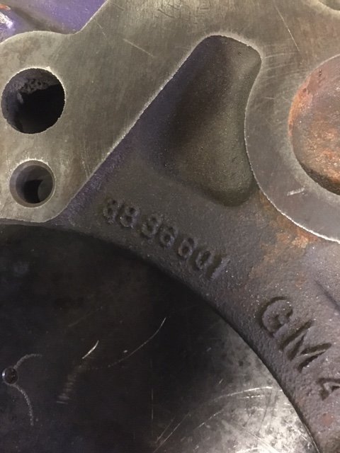

    The repaired ring is a 6 cylinder easily seen by the engine block side. The cast iron V8 Powerglide also bolted to a mounting ring and not the block as I remember them not like any modern transmission.
    Lars stated in the first post his 265 had a Powerglide bell housing. I’m thinking it has the ring needed to bolt to the circular torque converter bellhousing of a Powerglide. What he has may work which is his original question.

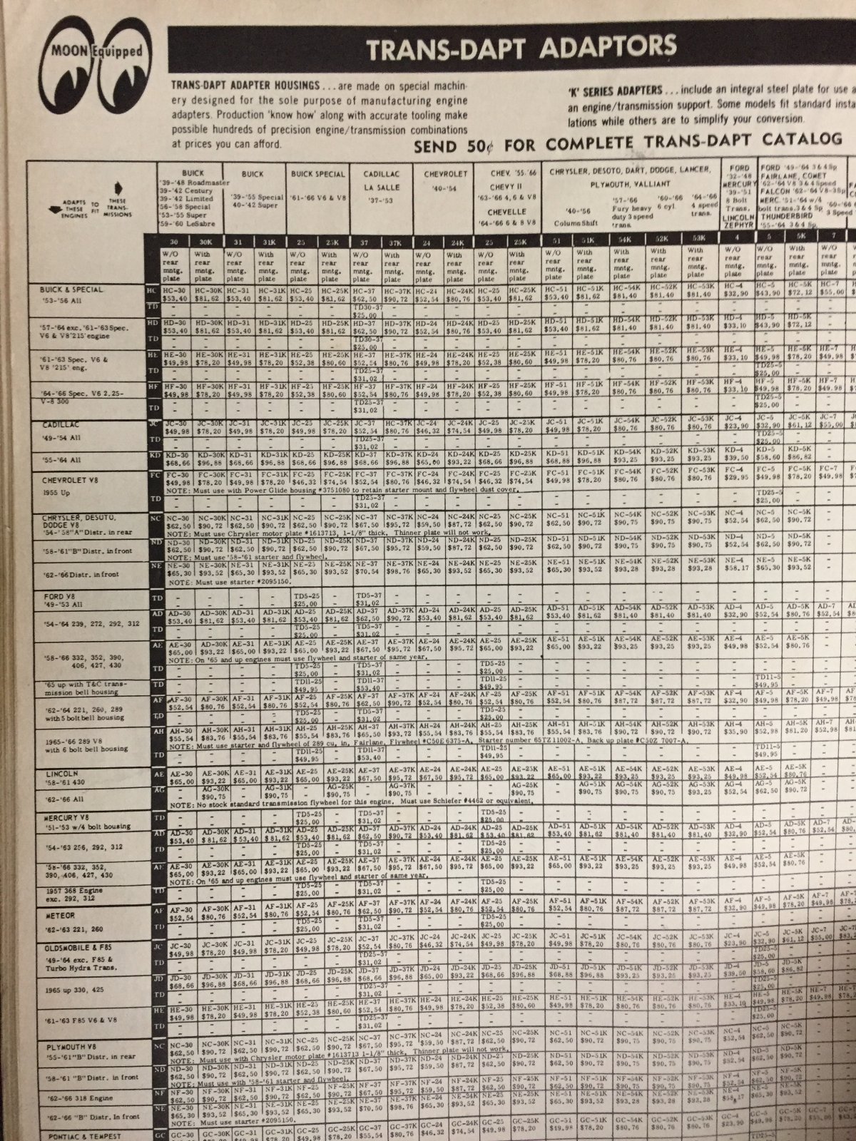

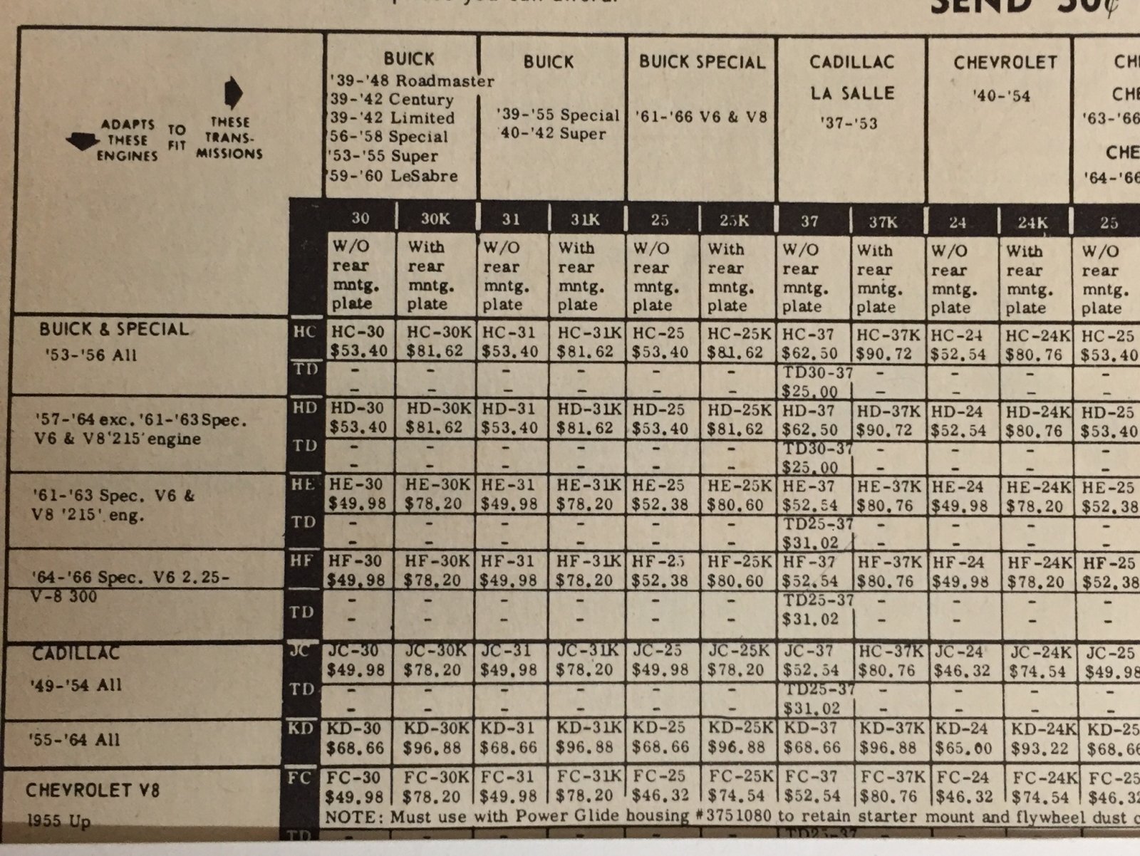

  30. I learned that lesson the hard way. I bought a TransDapt Chevrolet to early Ford transmission by using the Chevrolet Power Glide adapter, to go from a Blueflame to a 39 Ford transmission, and wouldn't work.
    [​IMG][​IMG]
