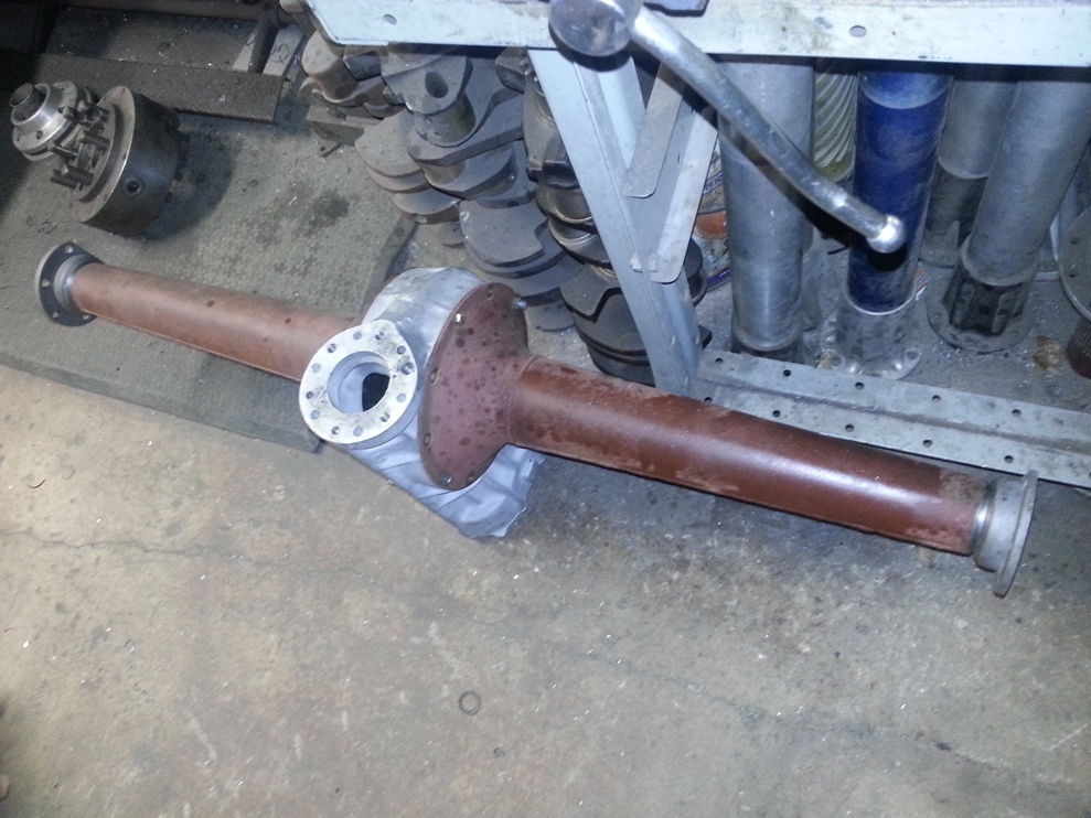

    In case there is still interest...
    Side gear cut down, teeth sanded and polished.
    axle tubes cut and new flanges to weld on.
  22. badshifter
    Joined: Apr 28, 2006
    Posts: 3,588
    badshifter
    Axles cut for re-splining, old axle from the 60's next to it.
    ring gear stock, and bored for side gears. Welded spider out of the 60's built QC. Now has an open diff again. I used 11 tooth spiders and cross out of a 40 ford.
    Clarktm likes this.
