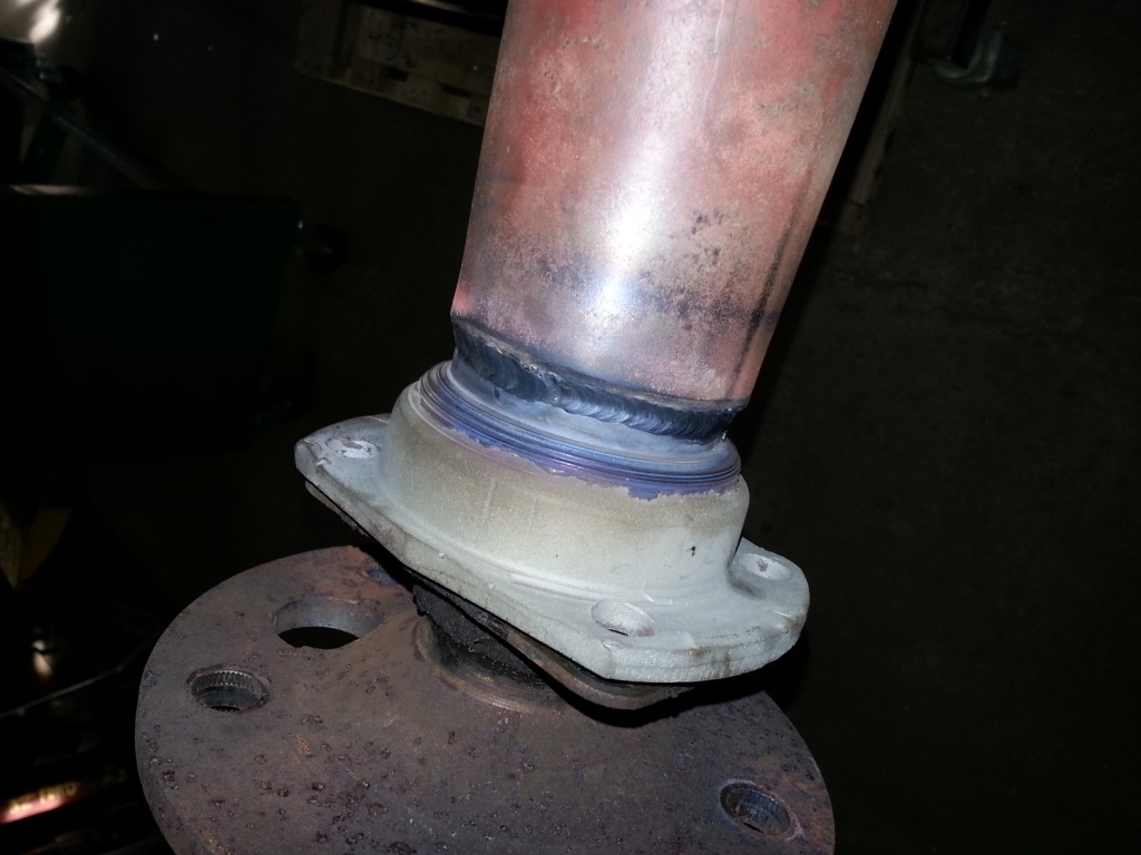

    Jseery is correct that the 7.5 Ford side gears will fit and they work very well. I have over 15,00 on my roadster with and early Hildabrand mag quick change with zero problems. I converted my axle housing to full floating bearings and drive hubs from Coleman Brothers Racing and use their 28 spline axles. I have attached a couple of pics.
    There is also a conversion to the Ford 9 inch axle that requires no machining. I have included a couple of pics of that conversion also.
    Rex
