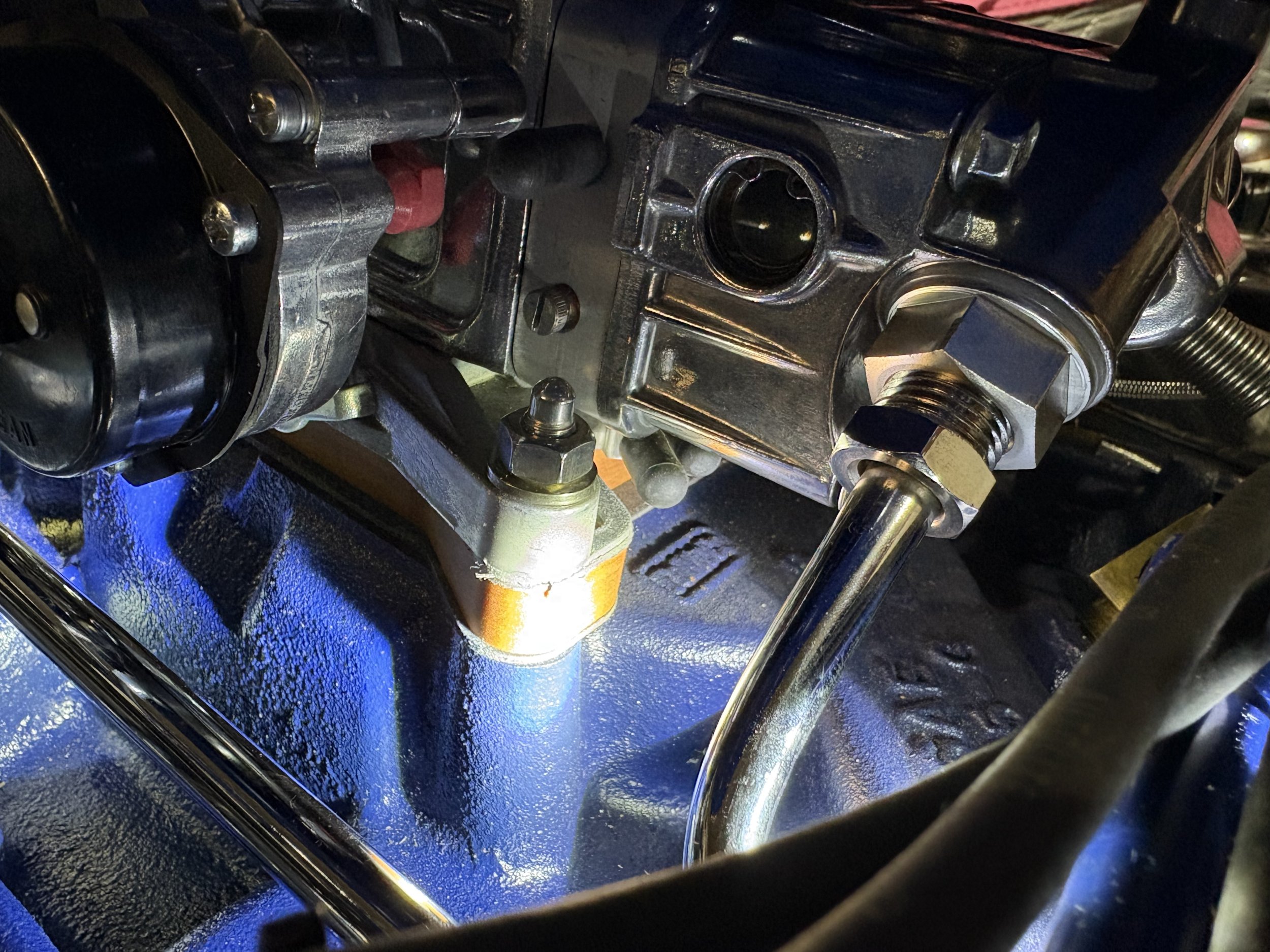

    Putting a Quick Fuel Slayer 4 barrel carb on a big block Ford custom I am doing and I see I have 2 vacuum ports on the front right side of this carb. Which port do I hook my distributor vacuum to? Pic of carb and front plugged now … ports attached.
  2. seb fontana
    Joined: Sep 1, 2005
    Posts: 9,298
    seb fontana
    from ct
    The one to the left of fuel level sight gl***.

  7. Oneball
    Joined: Jul 30, 2023
    Posts: 1,913
    Oneball
    You’ve got 3 vac sources in that pic
    the one on the metering block is ported
    the outside one on the throttle plate is manifold
    the inside one on the throttle plate I think is ported.
    if you turn the carb over you can see the drillings on the throttle plate one will come out under the ****erfly one won’t.

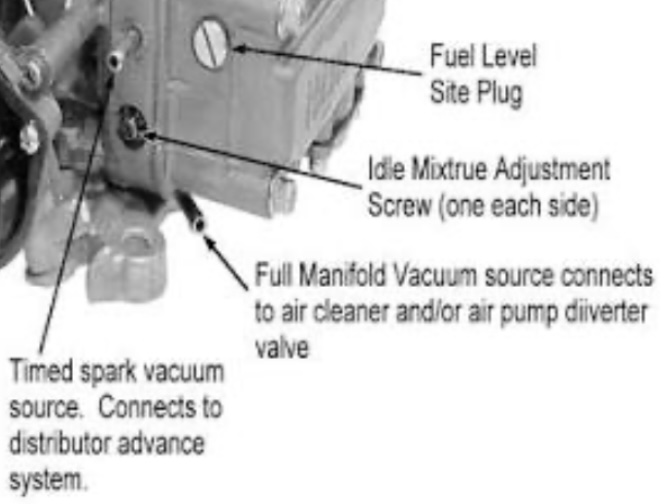

  8. Johnny Gee
    Joined: Dec 3, 2009
    Posts: 14,998
    Johnny Gee
    from Downey, Ca
    pprather likes this.
