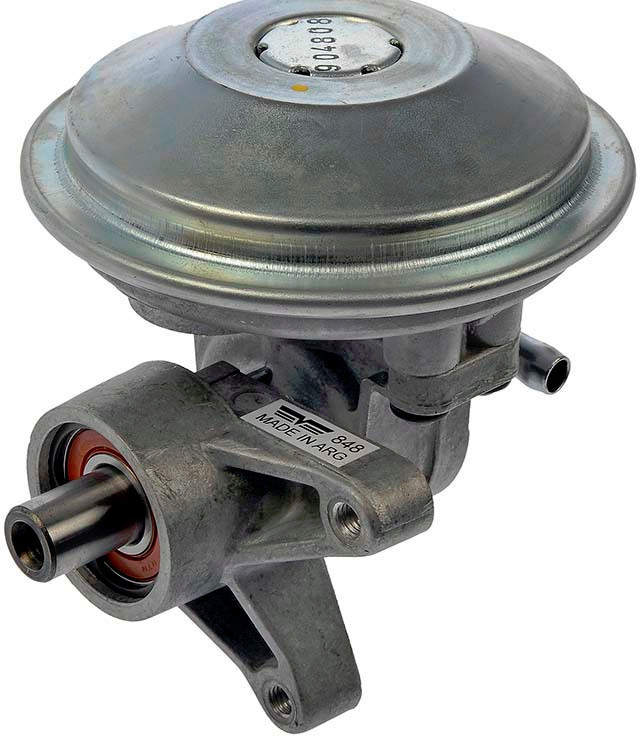

    As Joe H said, the early diesel pickups have an engine driven vacuum pump. It was needed because the HVAC system and primaily for brake booster were same as gas trucls that had readily available vacuum. Diesels don't run any engine vacuum, so the external pump is required.
    I have an 88 F-250 diesel truck; 7.3 IDI is the engine. Pre-Powerstroke, it's mechanical injected. The vacuum pump has no noise, at least compared to the rattling diesel engine. Never measured the vacuum level.

    Vac pump from a ~98 GM 6.5 diesel will get you ~ 20" at idle & ~ 25" above that. Very little noise, (flat/multi-rib)belt driven, mounted on block front, low under alt. It may be(probably is) rpm sensitive, so just gear correctly via different pulley.
