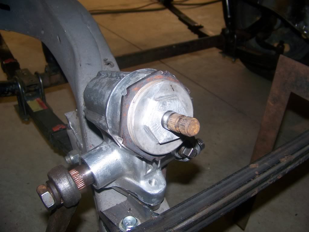

    ok, it's been a while and we have made some progress. also, thanks to some good friends here on the H.A.M.B. and original builder Wayne Shosie we have a little more of the story to tell.
    and some more cool parts
    Steering...
    we settled on the choice of an early aluminum Corvair steering box both to keep the lightweight theme and to keep the sixties vibe going. the car was set up originally with cross-steering with a box of now-unknown origin. Rich Bickle Sr. gave us a sweet deal on this one. it's nice and tight too...
    the Corvair can't be a rear-steer and a cross steer without steering backwards. we decided to reverse the Corvair gear and make a straddle mount to mount atop the frame rail
    here are the parts required to reverse the box.
    the freeze plug is a 15/16" driven thru the old input hole from the inside pushing out.

    the aluminum end frame was tig welded solid in the cross-hair webbed area inside the hex and rough bored in a lathe to allow the steering input shaft to p*** thru for mock-up. later on, we will bore a 15/16" diameter, 1/4" deep step in it for the new seal.

    here are the beginnings of the straddle mount. we used a couple of existing threaded holes in the frame for the trans crossmember for the main angle iron bracket
    another tab was drilled with a 1/2" hole and another hole was located with a transfer punch and will provide a mounting point on the outside of the rail
    a 3/8" thick steel plate was drilled with the Corvair triangular pattern and bolted onto the box, then tacked into place. note that the steering shaft is mocked into place to check angle and steering wheel position. the shaft is early ford with the Corvair stub temporarily tacked just to get the mock-up done. a step will be turned on the Corvair stub and it will be pressed into the shortened ford shaft and tig-welded
    some gussets were made to support the 3/8" plate and tacked into place

    I never realy thought about doing a steering box like that.Is that a standard kit only for Corvair ? Do they make them for other makes? Also realy good work,cool car great save,good luck.........................YG

    yardgoat, to my knowledge there is no ready-made "kit" to reverse a Corvair box, although for a LOT more $$$$$, one can purchase an already-reversed new unit from Flaming River. we just jumped in and came up with this on our own but i'm sure it's no different than anyone else has done. it is common practice to use a reversed Corvair in T-buckets, track-T's, and other light-weight hot rod applications.
