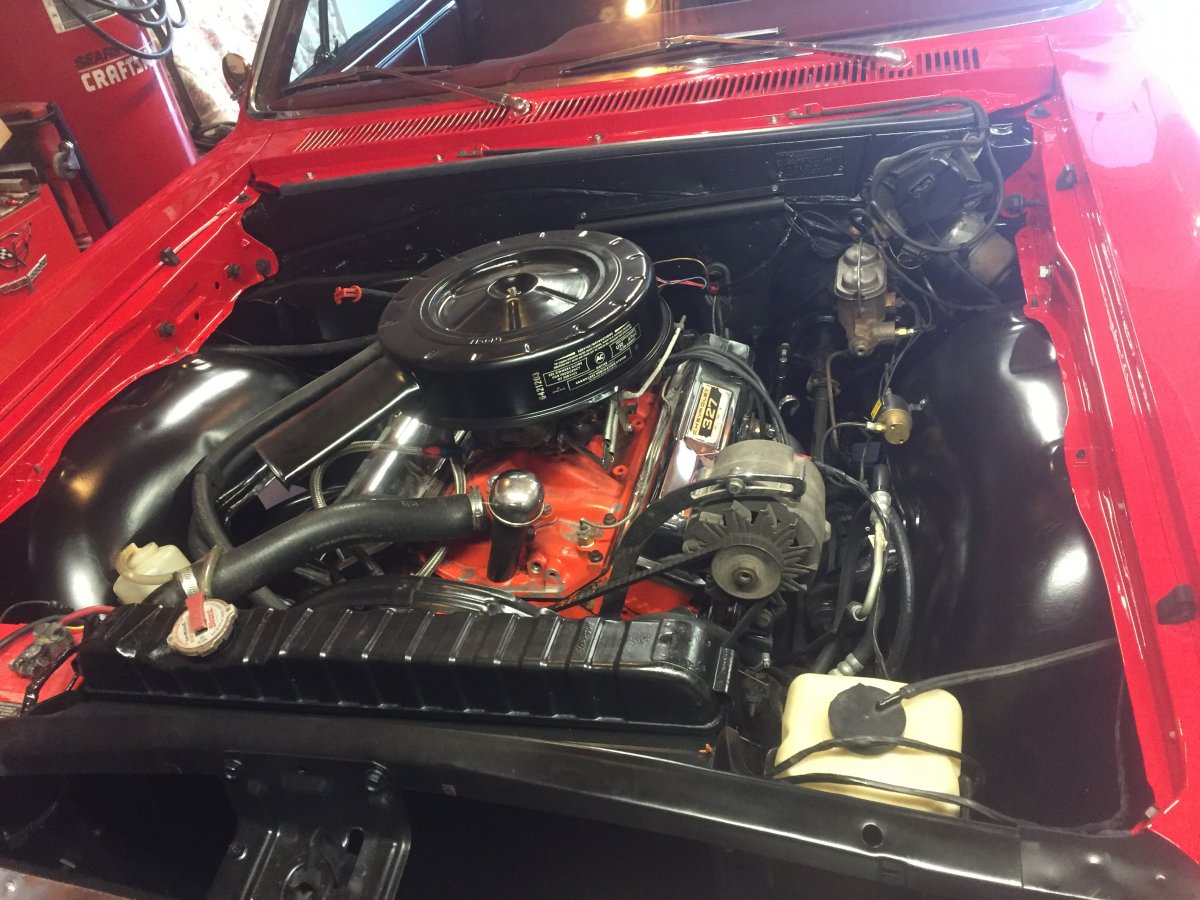

  14. missysdad1
    Joined: Dec 9, 2008
    Posts: 3,307
    missysdad1
    I've run adapters for several years on my hot rod, early staggered hole Corvette covers on Vortec heads. They work fine and are really convincing. I only ever had one guy notice that the motor isn't an early one. Mine had breathers in both valve covers with the PCV valve in the oil fill hole in the intake manifold which also served as an oil fill. Worked great.
