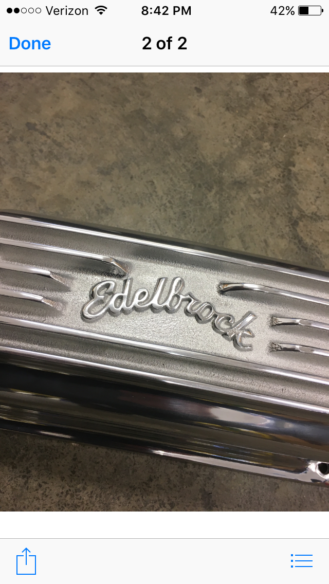

    My Edelbrock SBC polished valve covers just arrived. I've always planned to fill the gaps between fins with black paint or powder coat. Whadda say fellas: fill the fins or leave 'em raw? If the answer is to fill the gaps, please give painting tips? Or take to powder coater?

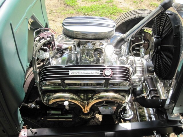

    I did mine in white, matches engine block. I used OneShot paint, it has been on there for 14 years, and still looks great. WIN_20150308_151841.JPG

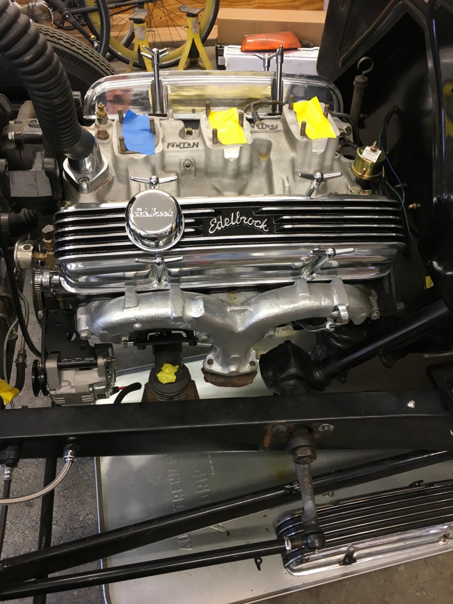

    Choppedcoupe
    Used gloss black Rustoleum Primer+Paint from Walmart. The valve covers came in plastic bags which I used as masking with some masking tape at the edges. Two heavy coats about 1/2-hour apart. Wiped down logo and fins between coats then again after second coat with a T-shirt stretched over my finger with some acetone. Turned out great. We'll see how it holds up.

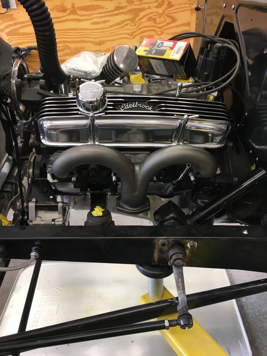

    Gonna add some Tru-rams to make motor favor a Y-block and look a little more 40s than 60s. Gonna have them ceramic-ed in satin black to not steal attention from the valve covers. Only other polish will be scoops on 97s.
    What is great about the Fenton manifold over other 3x2 manifolds? The oil fill tube conflicted with the high-rise water pump and was never gonna work. That's why I switched valve covers in the first place-I needed valve covers with breathers that I can add oil thru. This motor looks fresh-shame it's a 112hp 307! Still more power than most stock flatheads or a 4cyl, so it should still have a little pep over "stock."
