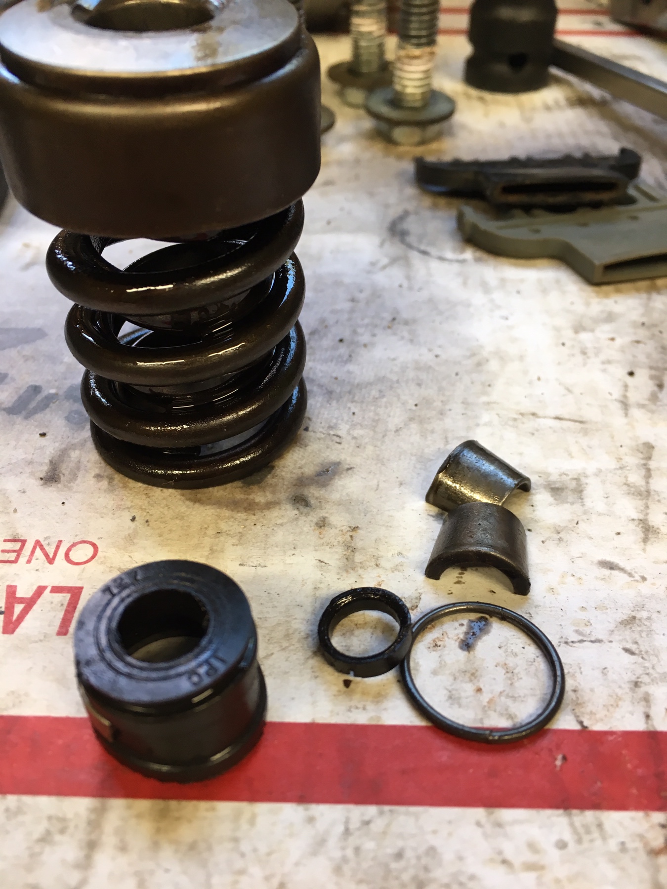

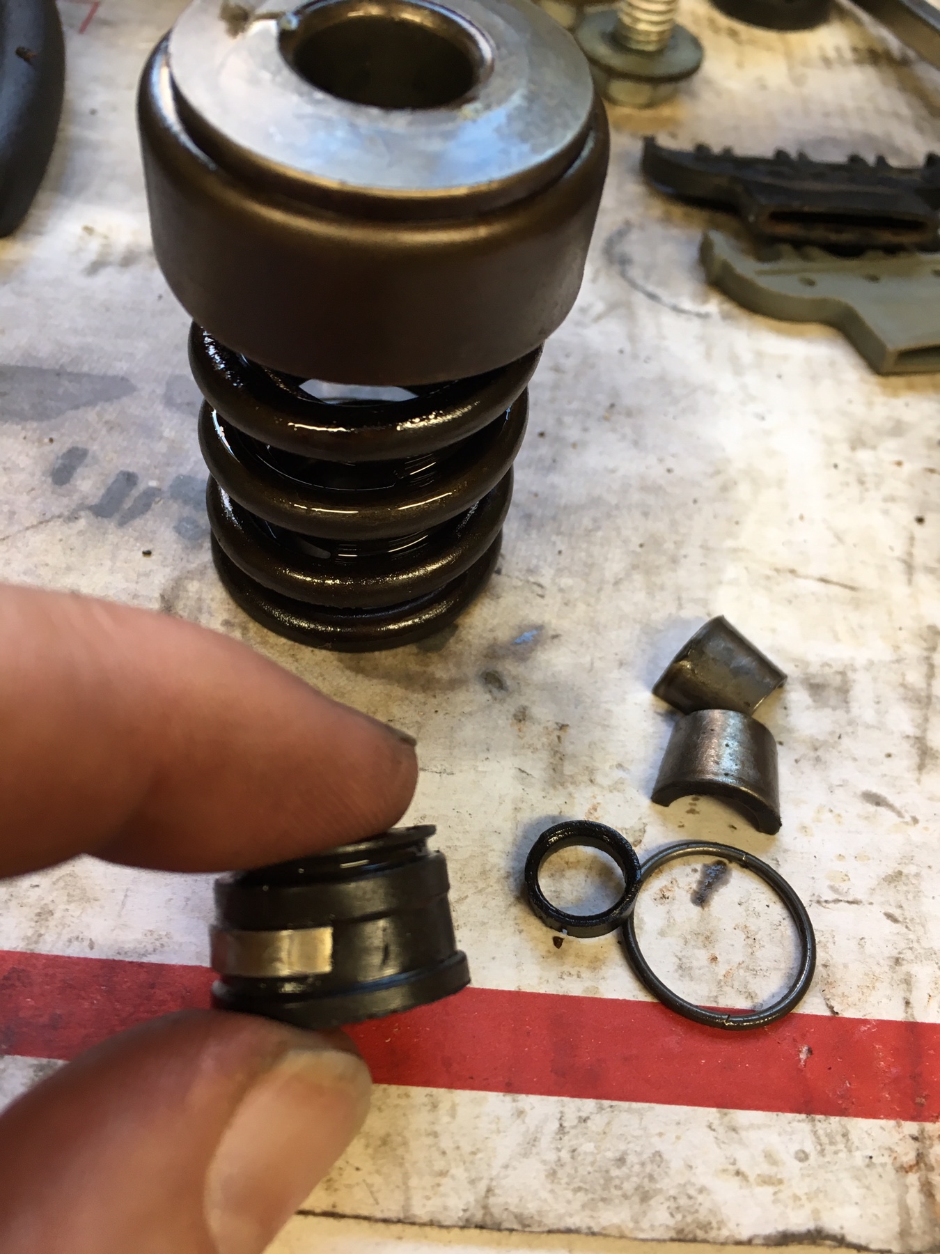

    You can’t see the valve seals without removing the valvesprings. Mine, on a ‘74 SBC 350 looked like this.
    I did like Squirrel suggests, with the hose from my compression tester, remove the schraeder valve, and hook up the air compressor to keep the valves from falling. A cheap and kinda ****py valve spring compressor from Hazard Fraught worked well enough.
    A set of new seals from NAPA are in there now. Not hard to do.
