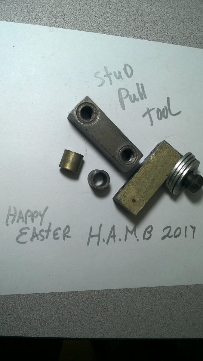

    I wanted screw in studs BITD but didn't want to spend much money (cheapskate) so I did it like this. Take a piece of 1" square bar stock, measure the center to center of two SBC rocker studs and drill the bar stock with one 3/8 hole to pilot on a stud and the other hole 7/16 to guide the tap.
    Place the block on the head and pull a stud using washers, or even old rocker balls to jack it out of the casting. Now turn the block to the 7/16 side and your tap is perfectly aligned to thread the hole. I used to buy Dorman Products studs, the bin number was V-6 and there was another catalog p/n but I don't recall it. The stud had a raised area to lock it down against when it was tightened in the head, no other machining necessary and at .50 cents a piece a lot cheaper than Mr. Gasket studs.
    Place block on new stud, pull next one and repeat until finished. The most important thing is drilling the holes in the block on the proper C-C distance, but this whole thing is probably not important anymore, I don't think Dorman catalogs those studs now. If you do find some old stock somewhere only the black oxide V-6 stud is Grade 8, don't use plain ones.

    Stud pulling tools ----one picture shows that you can still buy them 14bucks.
    The other picture is from the don't use obsolete tool drawer.

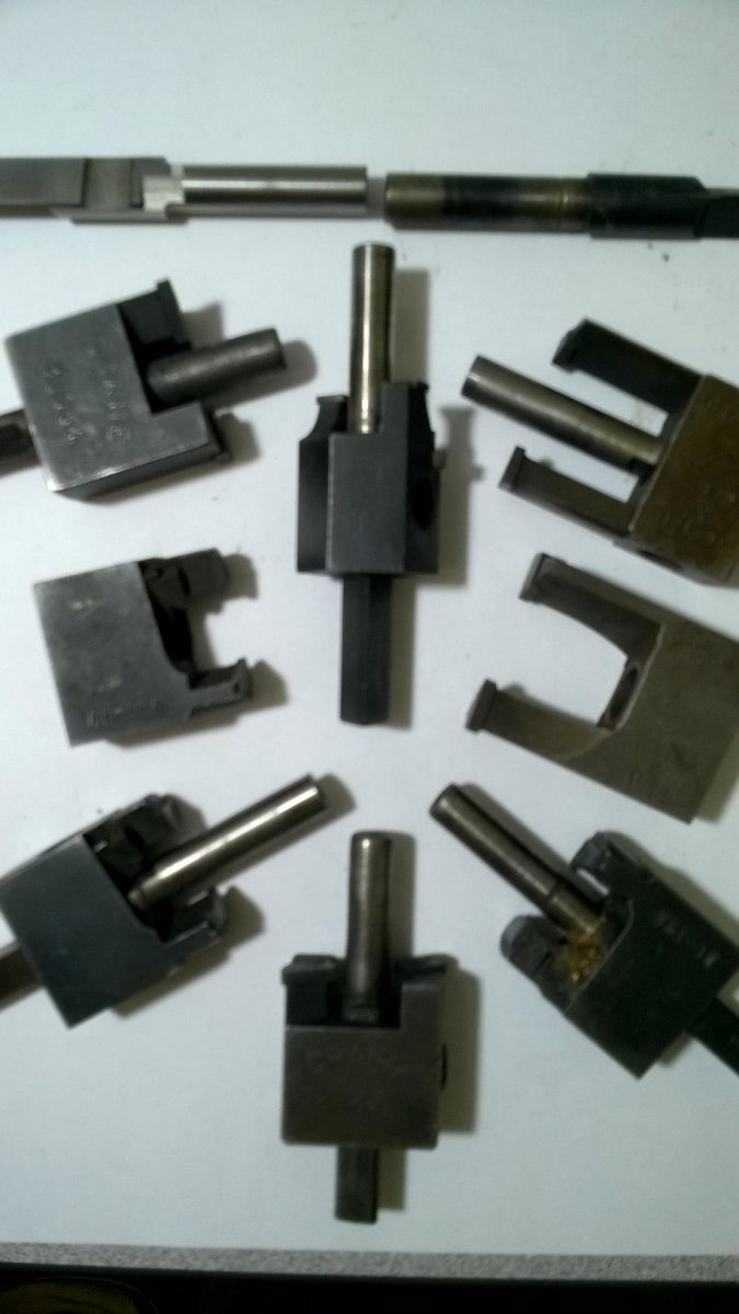

    Larry , like these ....? not much call for their use , when you can buy heads ready to go.
    Larry T likes this.

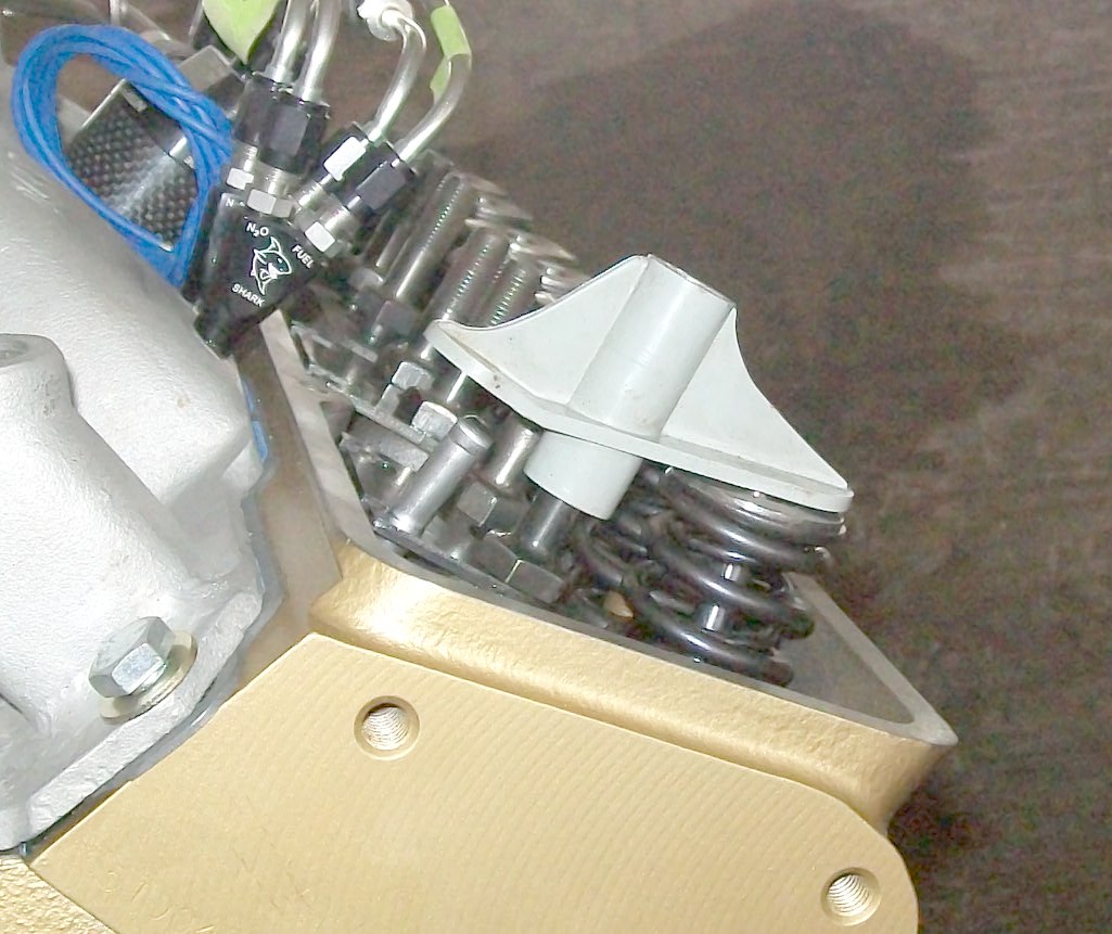

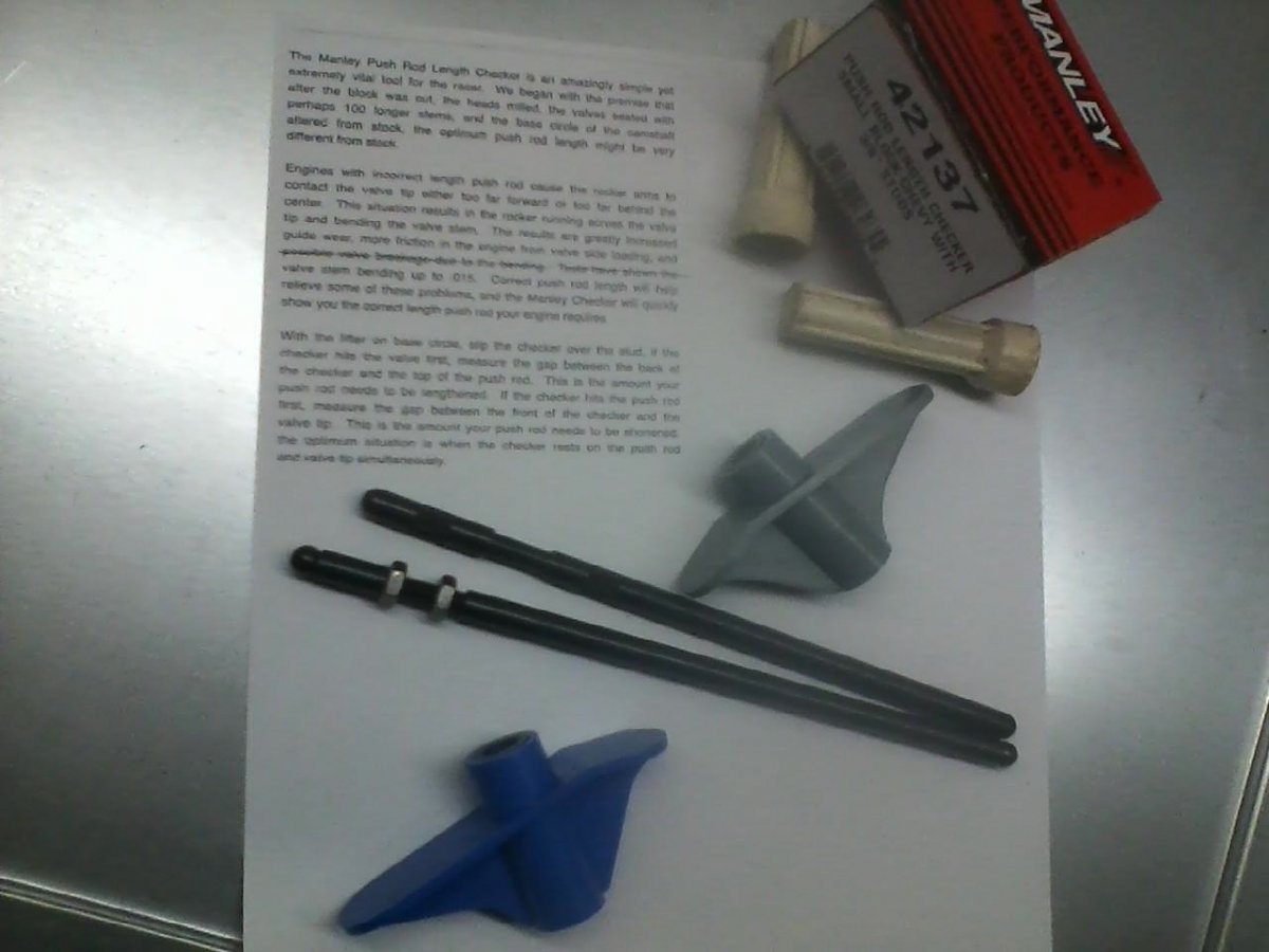

    As long as we're talking tools, how about pushrod length checkers. I've had pretty good luck with this one from Manley.
    Stock pushrod was .200+ short for this set up. (Dart heads/.100 overstock valves/Bullet cam).
    Also in the picture, 7/16 rocker arm studs. Cam is .540 lift, solid lifter cam, and he didn't want a girdle. Since it's a street engine and doesn't have a really radical cam with roller cam valve springs, I figured we'd use the bigger studs, matching 1.5 roller rockers and call it good.
    And while standard guide plates worked on most of the cylinders, I had to use adjustable plates on a couple of them for geometry and clearance problems.
    henryj1951 likes this.

    Yes two stud sizes ... and lets not forget those, COMP Cams Hi-Tech pushrod length checking tools see pic--->
