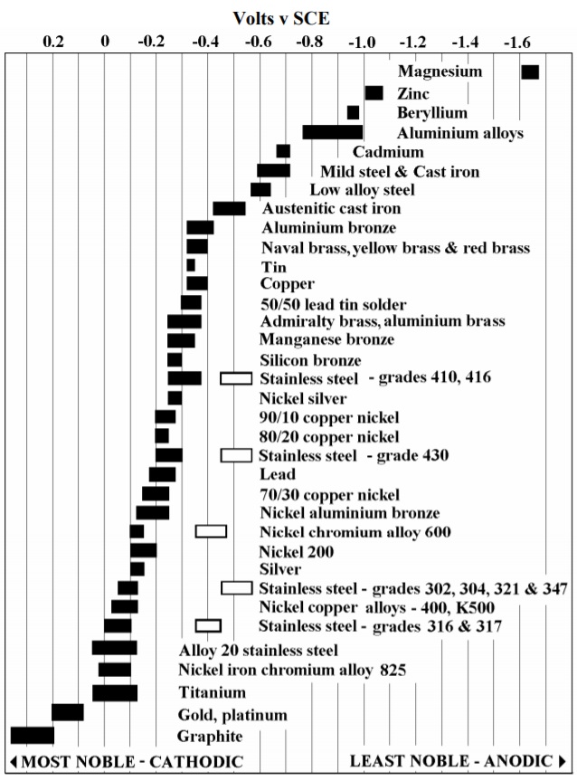

    If you are going to use a sacrificial anode to protect your cooling system (which is a good idea BTW), make sure you do it the most EFFICIENT way. First, DO NOT go to your "local BOAT shop and purchase a sacrificial anode and drop it in your water supply". If you do that, you will most likely get a zinc anode, which is much less effective in protecting your aluminum heads. Instead, go to Amazon and purchase a magnesium anode which is a much better choice. If you can read a "Galvanic Table", the reason for this should be obvious. Also, just dropping it into your cooling system won't do a lot of good. The damage to the heads is a result of electrolysis where your engine acts like a giant, weak battery in which the anode (the heads) is eroded. The whole idea of a sacrificial anode is to provide something more active for the "battery" to erode. If you just "drop it in" it is not connected to this battery circuit and won't do a bit of good. Sure, there will be some electrical contact from the anode just lying on the bottom of the radiator tank. What little electrical contact there may be initially, will rapidly deteriorate while the anode does it's job. Also, the advice to "retrieve it once or twice a year and s****e the “barnacles” off of the anode and re-insert back in2 the water supply" goes against the whole concept of sacrificial anodes. The whole idea is for the anode to give up it's m*** instead of your aluminum heads. They don't pick up anything (certainly no "barnacles"), so there is nothing to s****e off.
    To see more detail on the proper use of sacrificial anodes, check this thread : https://www.fordbarn.com/forum/showthread.php?t=301796&highlight=anode.
    For those unfamiliar with them, here is a copy of the Galvanic Table. Probably the most direct way to understand it is to compare the potential voltage for zinc (-1.1) and graphite/carbon (+.4). Zinc and carbon produce a voltage potential of 1.5 volts; sound familiar? HINT : Think "D" cell battery.
    Any time you have two dissimilar metals in an electrolyte (the coolant), it makes a big (though weak) battery.
