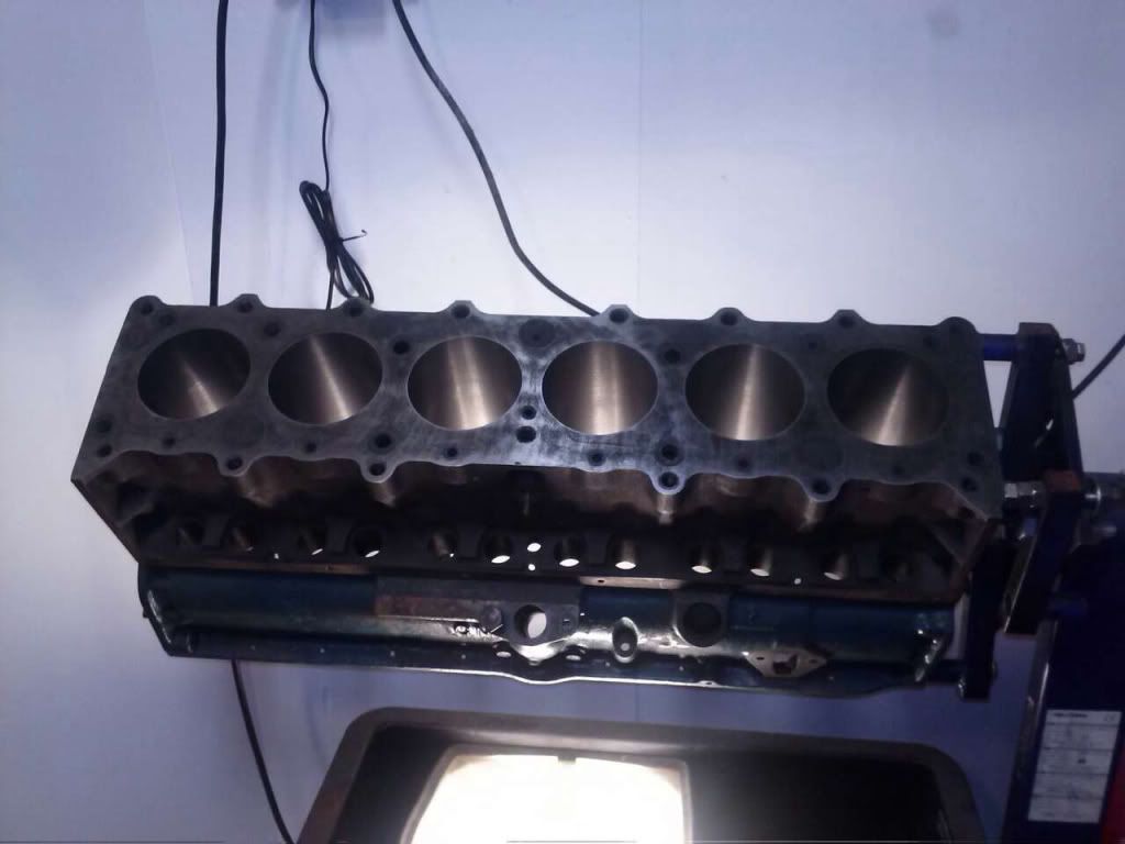

    Hi!
    I found a solution for my last question regarding my boring bar, but as i go forward i run into other things as well so instead of posting another thread regarding this bar i took the freedom to edit this first thread.
    So here goes, ive started testing my bar now and i think it runs great, but the motorcase got a little hot, at least hotter than other motor equipped tools i have, i meassured outside the casing and i got about 40 degrees celcius on the surface, this was during a low speed, low feed cut of 0.015" in a smallblock 350 chevy, is this normal temperature? I have just tested this on one cylinder and i will clean it up and make an oilchange before further use because i dont know its previous history, other than this is a quite old machine. :)
    Does anyone have recommendations for how much to cut at the time when going 0.030" over for instance? How much cut is to much in each pass?
    Ive made a temporary solution for clamping down this bar but im waiting for a used kwik way boring bar table to put the machine on.
    Im going to rebore a 1938 gm six cylinder so i made an improvised clamp with an aluminium roundstock, an m14 threaded bolt and a stainless steel bar with a nut welded to it. Any thoughts about this solution?

    Just wondering how do you know that you are boring the cylinders straight and not at a very slight angle ?
    Do you check that the deck is straight where the boring bar mounts ?
    Just wondering what it is squared off of or lined up with?

    I tried to meassure my bores using a stainless steel axle clamped along the main bearings and a machinists angle in the bores and a set of feeler blades but i couldnt meassure any angle of the new bore.
    My main concern was discoloring and slight pitting on the bottom of the boring bar when placing it on the block but its pretty clean and seems straight. Another concern i had was wether to surface the block before or after boring, so far ive just scraped the gasketleftovers on the deck and sanded slightly with fine grit paper until the deck feels smooth and even.

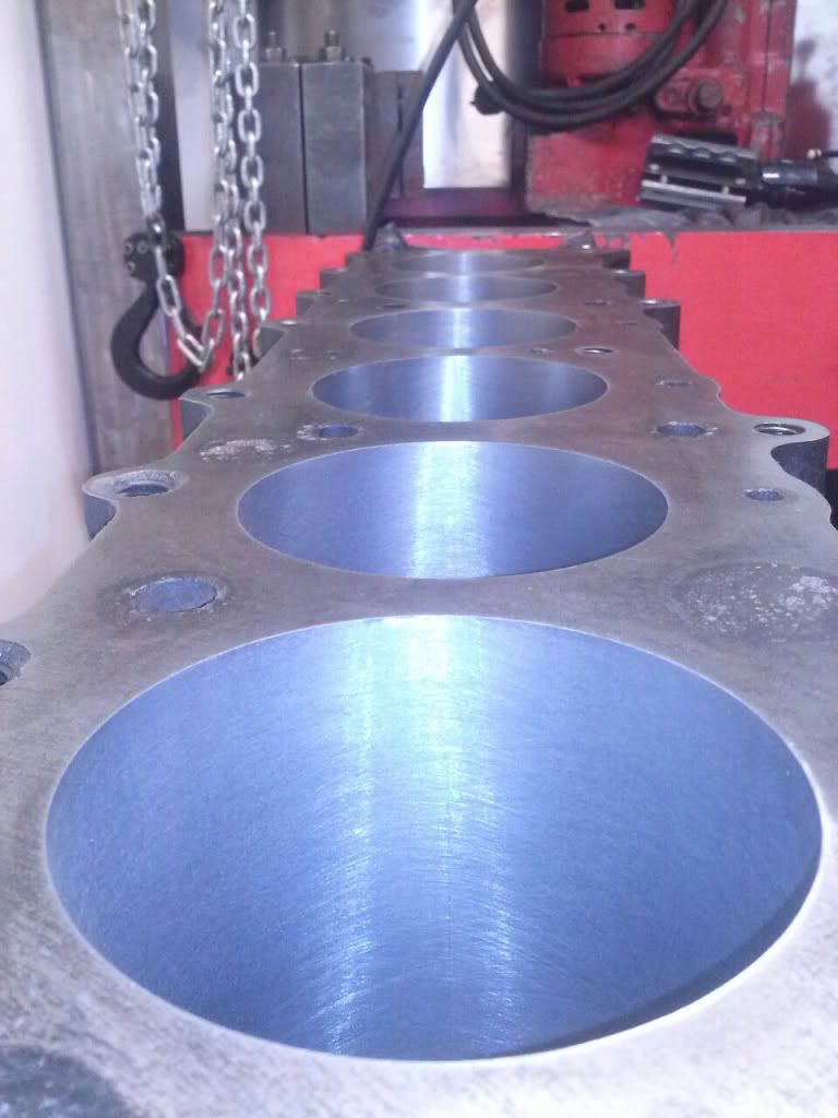

    Anyway, i bored this 216 block from 040 over to 060 over, and all the meassuring and converting from inches to mm and mm to inches and different piston materials etc gave me some other questions regarding boring, like;
    What guidelines should i follow when determinig clearances between pistons and bore, how much is recommended in stock builds and performance builds?
    How much is to much and not enough clearance?
    Today i put back the 350 block in the stand and it got me to think of the sleeve i want to try to install, any thoughts about clearance and should i hone the block before i press the sleeve in, or should i leave the bore unfinished?
    Pretty happy with this finnish
