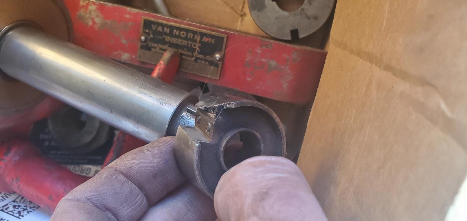

    Hi all - so i dug out the van norman inserto valve seat tool yesterday and decided to give it a try-
    the main cutter head got broken out by the ebay seller and of course i only noticed this 6 months down the road - anyway managed to get threads cleaned and new machine screws-
    I need to weld a small section behind the cutter and mill it back into spec-
    does it matter which rod i use? its just a filler section behind the cutter that takes a compressive load i would imagine-
    i was planning on a 7018 rod-

    well managed ok with the 7018, milled it down pretty good enough, only to find the little fixed cutter for the valve size I need has been custom ground down - i did get 4 valve seats in the kit that are a perfect size but the OD is odd -
    what are the common valve guide sizes - in this case a 1.6" chevy exhaust valve- the van norman shows fractional steps, is that still the case today?
    I think this system was designed for flat heads because the cutter is almost the size of the valve and the set screw hit the cylinder head :/ guess i threw $500 down the loo on this lot..
    ill keep messing with it and see if i can get it to work somewhat ok-

  8. Fstarocka
    Joined: Mar 29, 2013
    Posts: 233
    Fstarocka
    best i could come up with, im going to try and make and adjustable head but these are the 2 set screws i put in.. ill have to turn them down and cut slots i think..
    this system is from the 30s or 40s - no cutters available si will have the grind and try make my own.. still learning how to use the lathe and mini mill.. and forgive the porous welding i was using a damp piece of cement to shield the original surface and threaded holes and it caused a mess but protected them well despite spitting..
