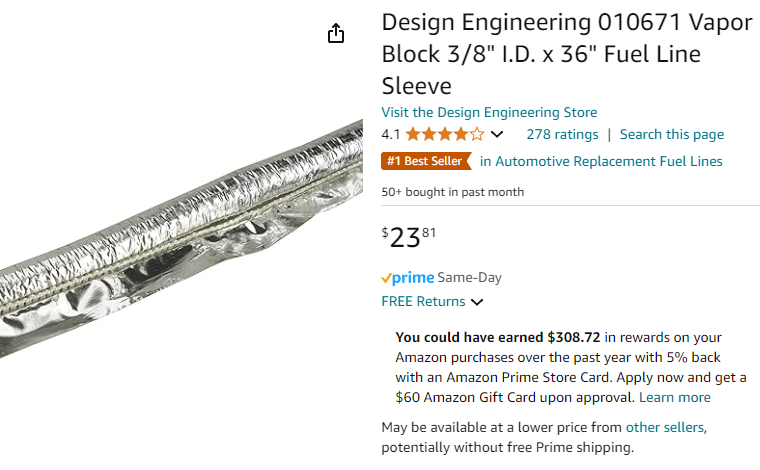

    On my 442 I removed the fuel line from the carb (double pumper) and installed it backward, facing the firewall. Re-routed the hard line up the firewall rather than to the front of the engine, put an electric pump in the tank and never had another issue. That was 10 years or more ago. Still running like a champ. That fuel line up the front of the engine on a Pontiac should at least be insulated with a sleeve like this

    Billy. I have the insuation like that from the pump to the carb. But as you know on a pontiac that fuel line is right over the water pump so Im sure that doesnt help. Ive also got the heat crossover blocked on the manifold. Its an aluminum edelbrock manifold. I have thought of adding an electric pump in place of the mechanical and running the fuel line like you suggest. May try that soon. Thanks
