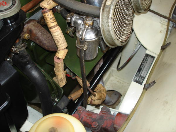

    > > Wood is an insulator, there's no way adding them to a fuel line could help cool the line. > >
    Sure it can. Insulators help keep things cool or warm, cold or hot. Lotsa clothespins needed. Cork's good too. 8^)

    Most people put 1 or 2 on the fuel line.
