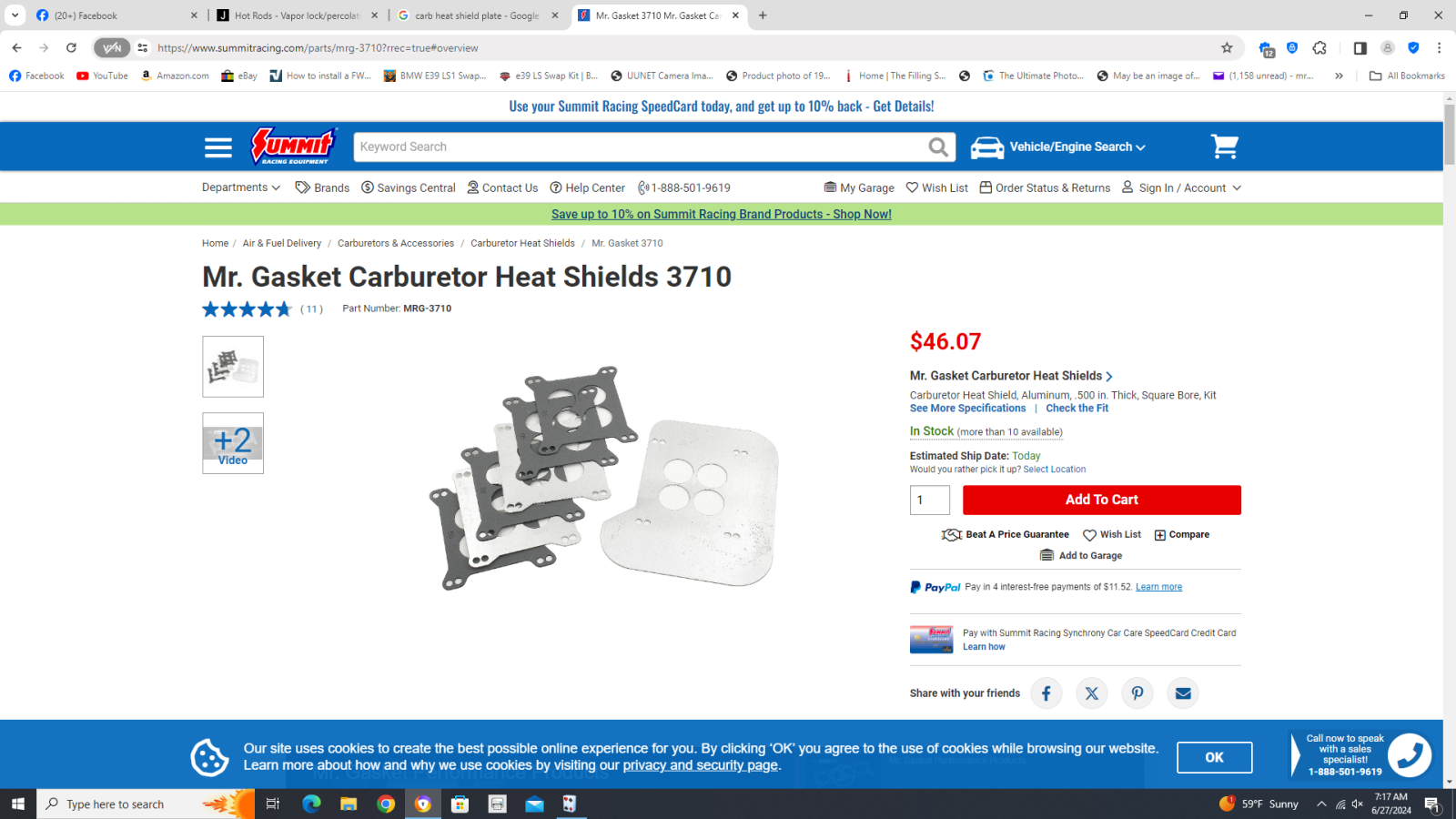

    Great advice and suggestions here! I have similar a thing going on. My 31 model a has side louvers in the hood with a Spal 16" pusher fan and a smaller 12" pusher in the front of the condenser with a gm 350 motor. No overheating has happened, but can drive down the road for a bit, then the car stutters like it's outa gas, which I make sure I always have plenty of. Then the car dies, and I coast off the road, saying not so good things. That's when i changed the the 2-month-old fuel pump and lines. The carb has had all the gas boiled out of it, won't prime back up, always have had to pour gas down the carb then it starts. I put a heat shield and a phoanic plate on it too but still didn't help New 500cfm Edelbrock carb, cleaned the tank, and blew stainless fuel line out, changed the fuels line hoses, put 2 new fuel filters on it, and still, it sputters, and carb gets no gas. No vapor lock either. Do I need to put an additive in the gas or run a return line and or put an electric fuel pump on it? Afraid to drive it for fear of it quitting on me. And sorry for the lengthy post but I ain't much of a mechanic, I do more body work and painting.

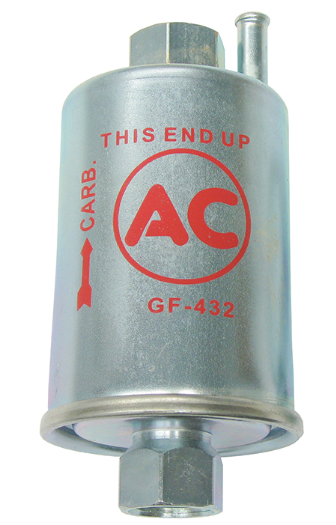

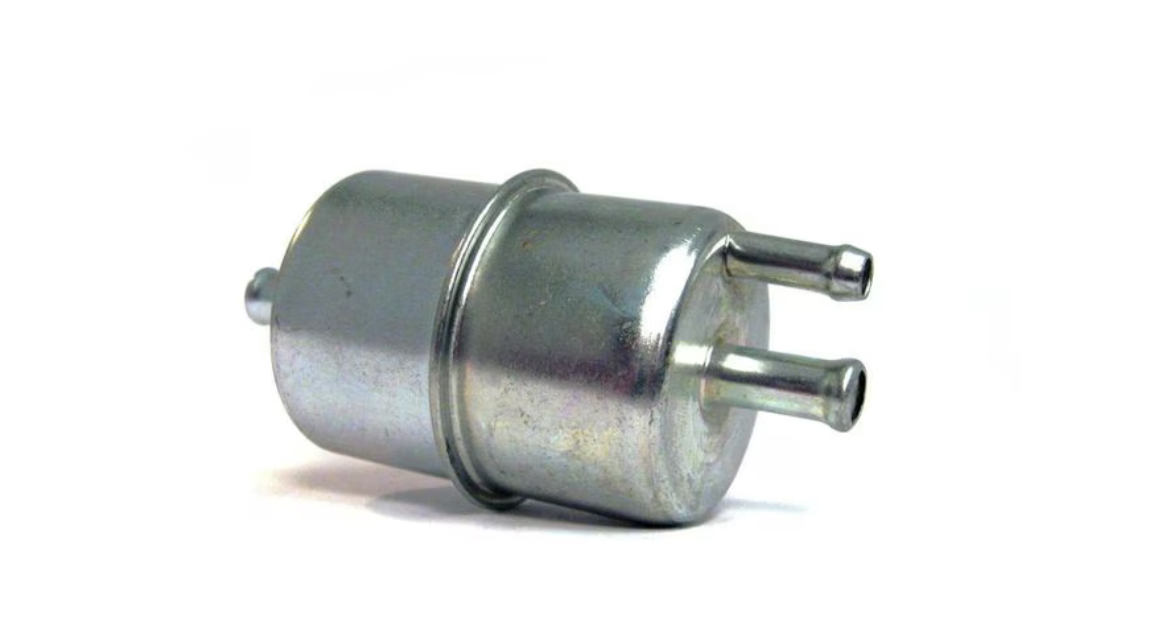

    do these work ?
    all the ones that I have seen are advertised as the third outlet is for a breather, which doesn’t make sense to me either.
    Or is the term breather just another way of saying ‘over flow’ ?
    If some of the fuel bi p***es, do you lose pressure at pump/carb ?
  8. Haven’t ran the filter.
    Bought a fuel pump with a built in return. Works great
    clem likes this.

    I'd try the spacer first just to see if it relieves the problem. If you go with an electric pump, the best set-up is an intank pump and the return line....but that adds to the degree of difficulty. I would buy your pump from a reputable source like Summit as there are conterfeits out there that look like good pumps, and also fuel regulators that are copies. One other thing to consider is that the fuel pump will place an additional load on your electrical system, so you might consider whether your alternator is up to the job.

    I agree with phenolic spacer ( mine is 1/2 in. open style on a Edelbrock C4B ) . If you were using a Holley carb. I would suspect the power valve leaking or wrong PV. Also, as mentioned , float level may be too high. I found that todays fuel likes more initial timing, however, I run pump premium because I have over 10.1 CR. My sbc runs 180 deg. on a 180 thermostat (+/- 2 deg.). Maybe adjust idle screws to get around 13.8 on afr after adding spacer.
