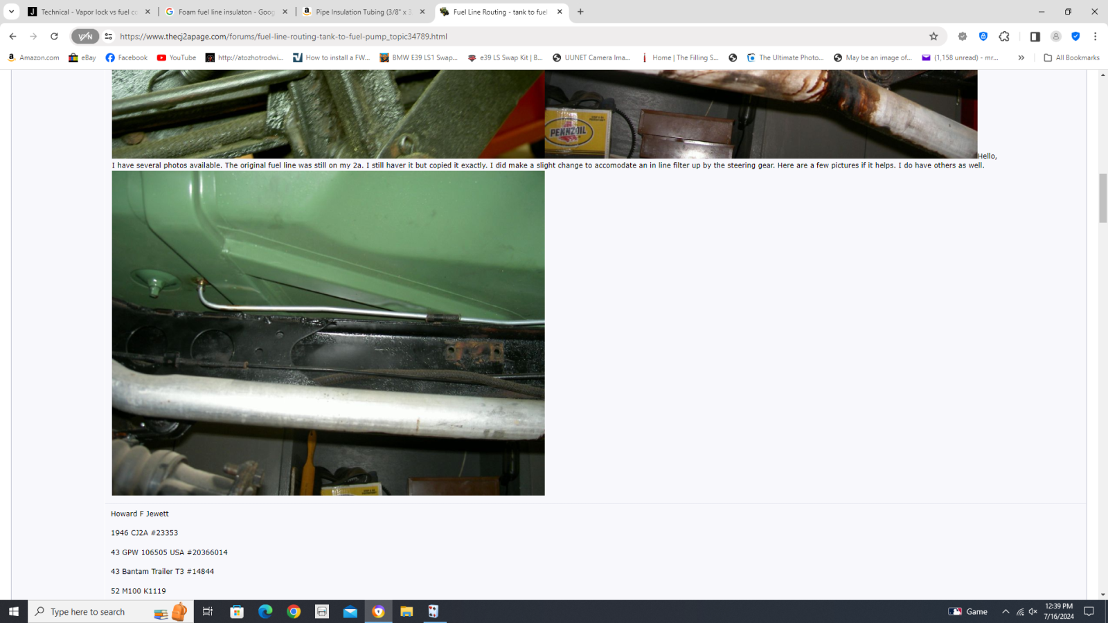

    First thing is to figure out where the heat is affecting the fuel in the line the most. On that Jeep there isn't much line so it should be a pretty easy task and if you were to insulate the whole line it wouldn't take a lot of insulation.
    ***uming that you have a CJ rather than a Pickup or wagon this page shows the fuel line routing real close to what it was originally according to the gent posting it https://www.thecj2apage.com/forums/fuel-line-routing-tank-to-fuel-pump_topic34789.html
    In the photo off that page note that there is a pretty good clearance between fuel line and exhaust. someone at some time didn't tuck the exhaust up closer to the floor and in turn the fuel line by chance? Screenshot (569).png

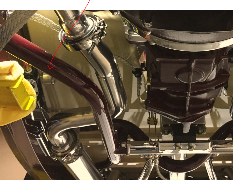

    Out of curiosity, how close is your fuel line entering the carb to the radiator hose? Some checking with your laser thermometer might help figure out the hottest part of the fuel line where it's closest to heat generating things for a potential fuel boiling point, can you post a pic?

    I have picked up some (very expensive) industrial tubing insulation which I think will help. I have been trying to talk to Holley but there are always 35 callers ahead of me (that’s no exaggeration, it’s a fact).
