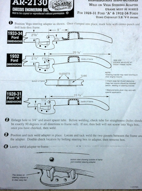

    I have installed a Vega steering box in an A frame. The front and rear axles are 40 ford. I have completely rebuilt the front axle. With no weight on the axle the wheels turn real smoothe When I put the weight on the front axle the wheels are hard to turn. The Vega box wants to twist the frame trying to turn the wheels. Caster is at 3 degrees. does anyone have any suggestions.

    Frame not strong enough to resist the twisting force caused by the Vega box. I would box the frame.

    Old instructions, is frame boxed and mount gusseted?
    stillrunners and falconsprint63 like this.
