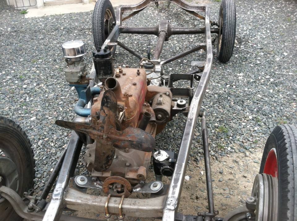

    I will try to post a picture.
  6. chucksue
    Joined: Mar 25, 2011
    Posts: 27
    chucksue
    from ill.
    Here is the box and engine.

    I have dual springs on the front not the transverse. I don't think that is the problem. I had to move the motor mount. That was where the Vega box had to go. Fuel pump had to go and I have an electric pump. Going down the road it steers like a dream. Shims go above and below the axle mounts that I machined to get the caster set. The mounts are cut so they capture the shape of the axle.

    To me by pics , angles are wrong ,drag link( cross steer) & steer arms to short , others will chime in now there's pics,

    I think you have too much Toe out.....LOL
    Serious are those "spring Mounts on the axle" temporary? I am no steering expert but with parallel leave springs is it advisable for cross steering? sI could see the force used to turn pushing against the shackles & bushings causing wear and a loose front end.
    Why use a 40 Ford axle & try to convert it from a Transverse spring to parallel leaves?

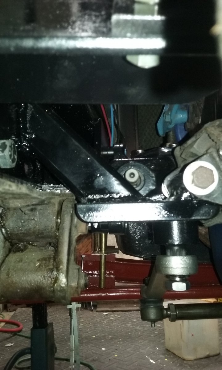

    This is a picture under the car. Motor mount and steering box with pitman arm. Bought the box from Speedway as a kit. I bought the dropped pitman arm.

    I see '37-'41 round back spindles with the as forged steering arms and a GM pitman arm and I run the same exact pieces on my '32 coupe with no issues.
    On the other hand, as mentioned by geoford I also agree and don't think it wise to run cross steering with your parallel leaves. Another concern are what appear to be bolts rather than u-bolts on the spring plates. Might just be the photo but those bolts don't look beefy enough.

    My advice would be to stop, just stop right there. The whole thing is a mess and shouldn't be on the road. Please, before you kill yourself or someone else, take the car to somebody who knows what they are doing. IMO the whole thing needs to come apart and be redone. By someone else, qualified and knowledgeable enough to do it right.

    I know yr trying Chucksue , But things do not Look safe for Highway use ,

    The way the box is mounted looks scary. Not to bash you, I've done some admittedly sketchy stuff at times, that if somebody had pointed out a better way, would have prevented me from continuing. Your set up falls into that category. I mean this in the best possible way.

    Bolts are 1/2 inch grade 9. The axle has one inch radius rods going back to the frame.

    Can't wait - but seriously need big picture pictures to see what is really going on. The closeups don't give enough information. Take a couple of quick shots and then get back inside next to the fire.

    This may sound dumb but the kingpin bearings must go under the axle or the friction under the load of the car will be a huge problem.

    I built this the other day. It fits inside the frame to stop the flexing. 2 x 4 tube steel 3/16 inch thick.

    I agree with Hackerbilt. Start all over with your Front suspension. Your bracket for the Vega box is scary. I've built a lot of Model A's & 32 Fords and have boxed frames with Vega steering with out problems. The transverse spring works great.

    Yeah, that was a bit harsh. I admire Chucksue for not getting his feelings hurt over the universal condemnation the front end of the car, and trying to figure out a better way, but I'm not sure the bracket he's come up with is going to fix all that looks like is wrong with it. It looks like to me that the frame will be prevented from flexing at the box itself, but the load will all be put on the frame beyond the end of the box bracket. Or, I could be wrong and it'll work...
