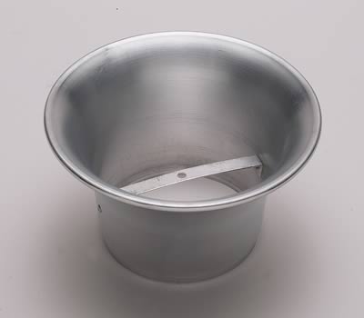

    Does anyone know of anyone is still making theses type of stacks. All i can find is the cheap chrome ones on ebay . This one is spun aluminum . I need another one for a cross ram on my drag car.
    Also while were on the subject does anyone know the pros and cons to running stack on a car ...street or race? Other than the obviouse no breather filament...

    Problem with most of the stacks made now is that they are mostly for 2 barrels. Im running a Elderbrock cross ram with 2-4s on my drag car.

    Summit has them 40 dollars polished aluminum

  13. These were made locally on the early 1970s by a guy with a lathe who knew how to do spinning. Back then I paid $15 each.
