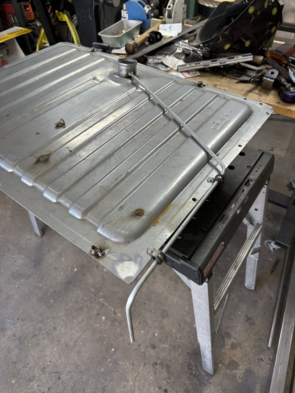

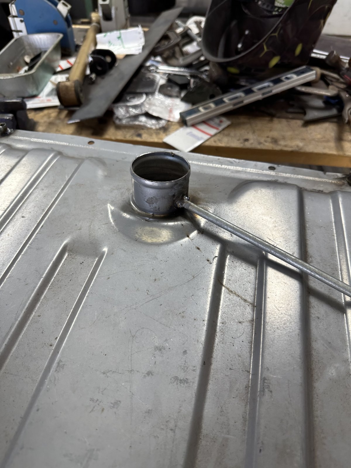

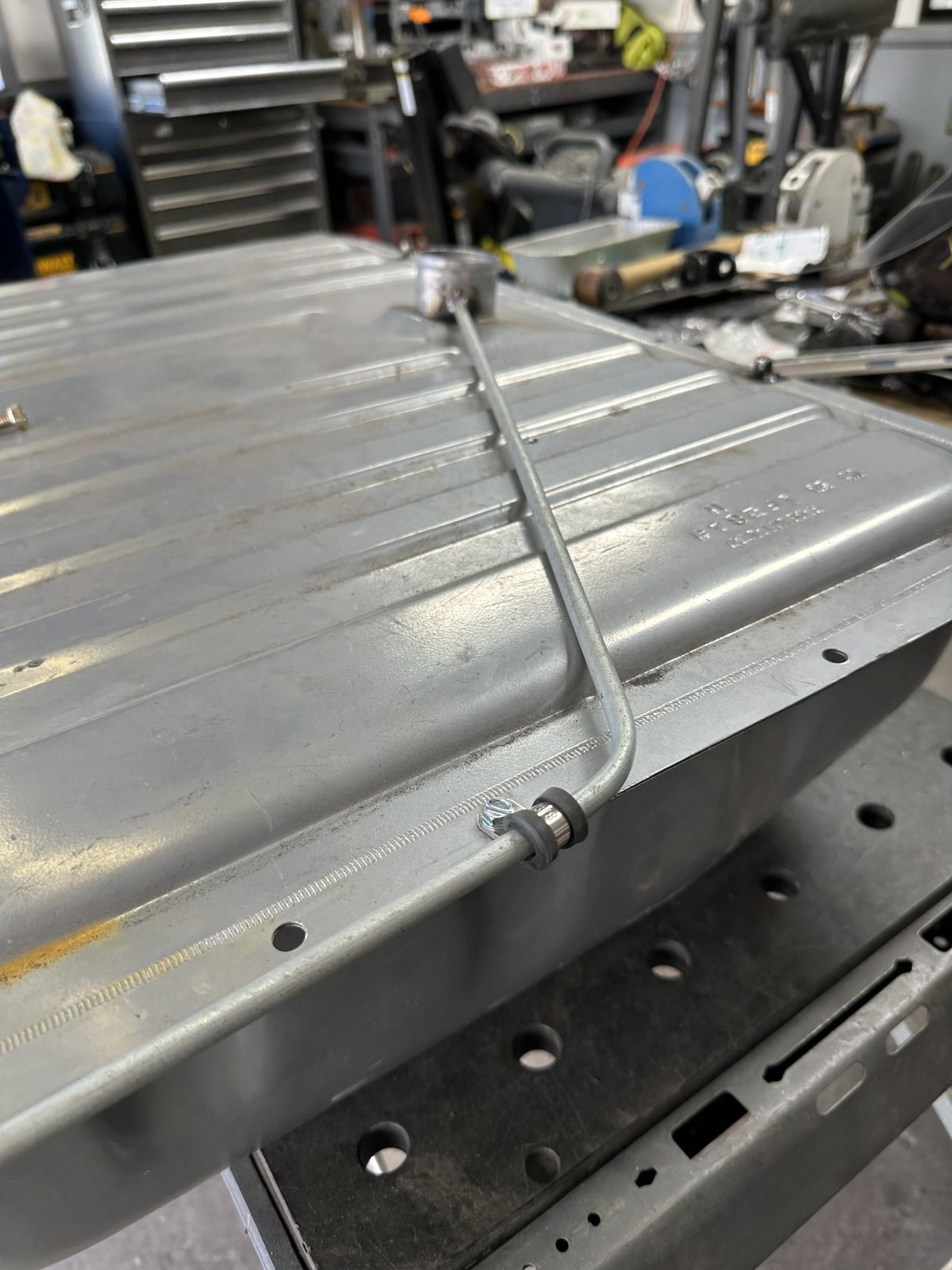

    My tank is not vented plus I wanted a rollover valve in place. So I welded a bung in the filler neck IMG_0597.JPG to screw the valve into and use a non vented cap.

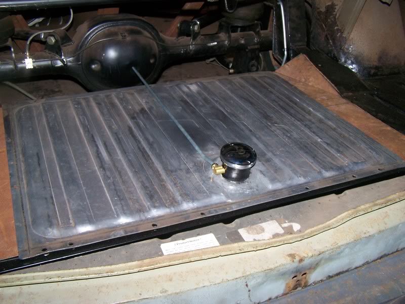

    alanp561 likes this.

    That's what I was looking for. What is that short filler neck that you used? Did you just drill and tap the fitting into the stub that's on the tank?
