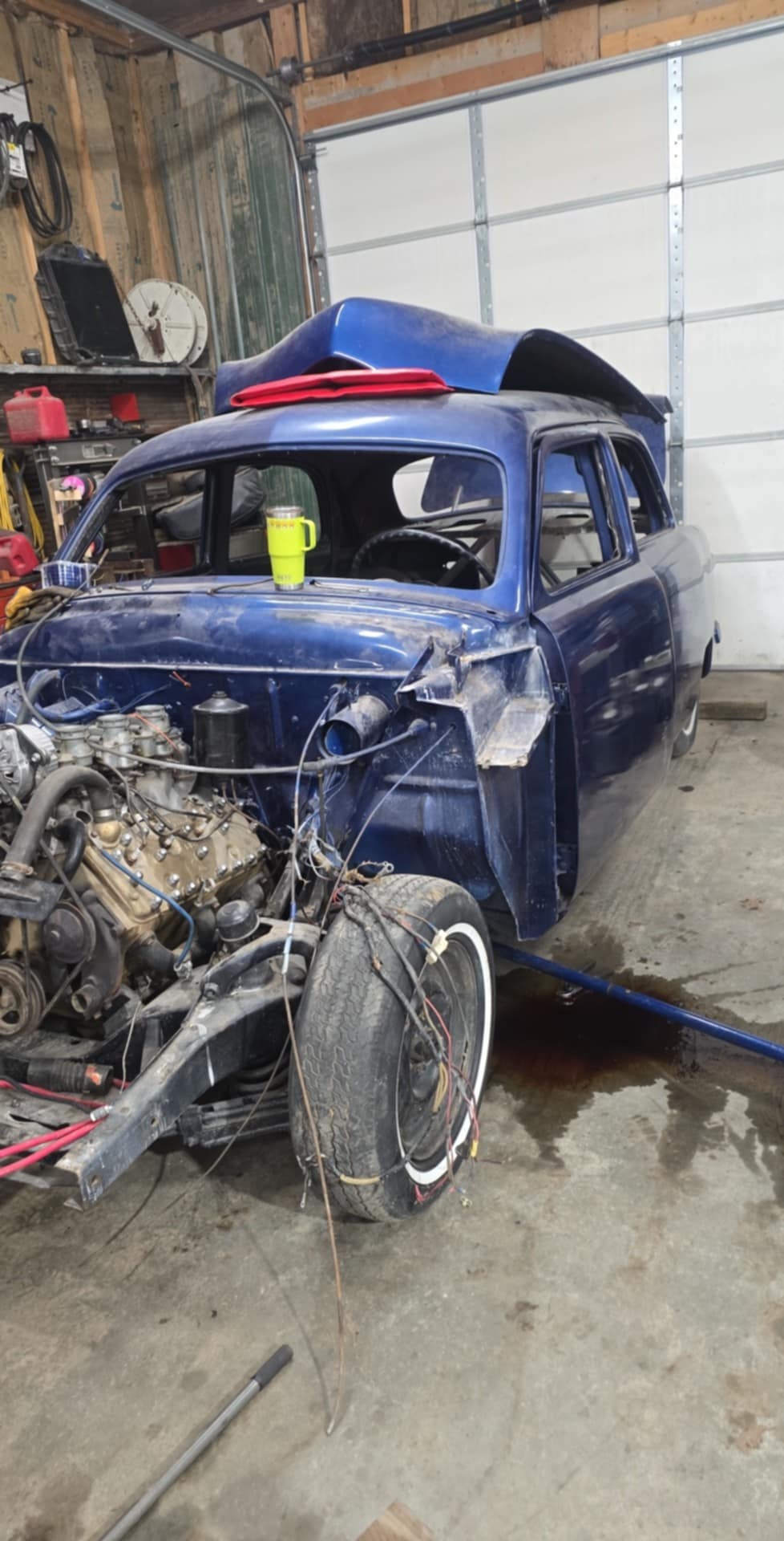

  23. It's still in pieces at the moment but I think I have ine
  24. As soon as I figure out how lmao
  25. As you are learning the quirks of the functions of the forum don't get discouraged. On a completely different car forum 13 years ago I signed and never figured out pics for a couple years. Generally the only way I got pics posted was to text them to buddies on the forum for them to post for me. In that period I pioneered several swaps along with several methods of repair(one is known as the "l67ss trailing arm mod"). And I was a young guy then from the generation proficient with tech. So don't think too much into it. :)
    osage orange and Okie Pete like this.
  26. If that is a Bondo buggy like someone else suspected it sure is a pretty Bondo buggy
    osage orange likes this.
  27. F-ONE
    Joined: Mar 27, 2008
    Posts: 3,700
    F-ONE
    from Alabama
    So far, the car looks really good.
    It looks like the work that was done is legit.
    An option for you concerning the filler.....
    The '49 had a simple filler neck going through the quarter. That might be an option for you. 50s and 51s had the filler door on the quarter.
    If the inside parts of the filler door are still there, I might consider replacing the filler door. If not, there's always doing it like the 49.
    With the front sheet metal off, this may be a good time to get the engine running since you have access.
    Okie Pete and The Chevy Pope like this.
