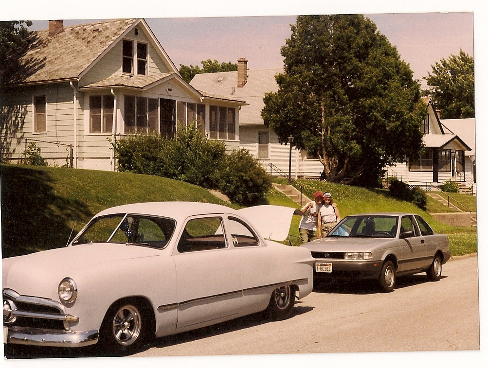

    I welded my gas filler door closed and used a tank from a 65 Merc Comet. Fuel filler was in the trunk. Never a problem with gas fumes.
    For door latches [my car was a 1949 with terrible handles/latches. !950's had much better latches/handles]] I hit u-pull-it for latches and strikers from an early 80s Plymouth Horizon. Sold the car before I installed any door handles. rockboxnscotty.jpg

  16. My 4 Dr Merc, I cut the top off and made a Carson top for it, kept the 4 doors, shaved the rear handles. Cut it up.
    Okie Pete and TrailerTrashToo like this.
  17. That is absolutely beautiful
    TrailerTrashToo likes this.
  18. You'll have to build a support for the door posts that connects right and left sides and braces them, I used square tubing top and bottom with vertical braces to connect the top and bottom and also weld the bottom brace to the floor. There are some web sites on "How to build a Carson Top" check them out. I used Early VW convertible side windows and regulators worked out well.
    Okie Pete likes this.
