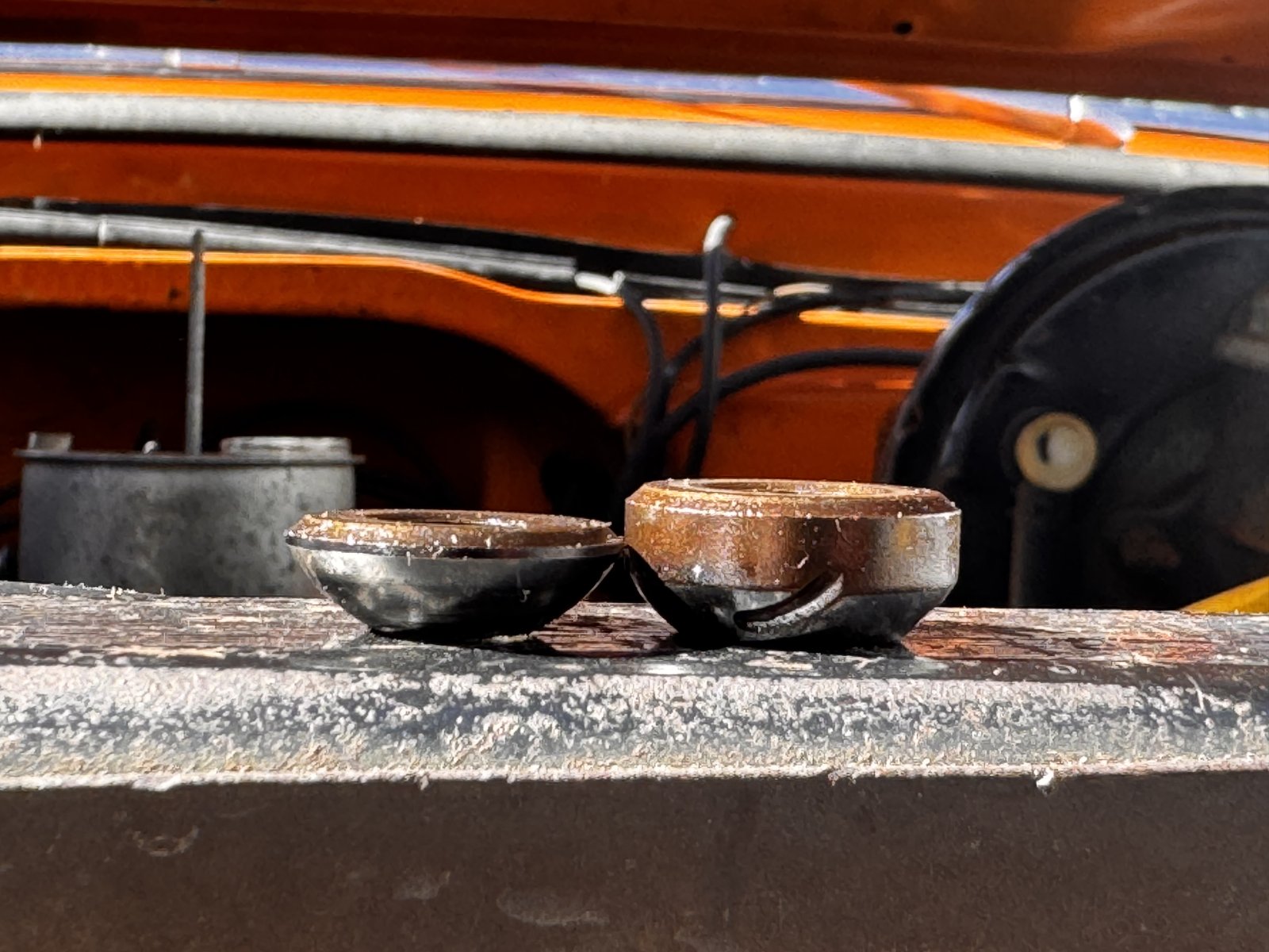

    1972 SBC 350 rebuilt 30,000 miles ago Was noticing a ticking after longer drives. Pulled valve cover a found a very loose rocker on #7
    Any ideas on what went on here, what to check? Push rod is straight, oil hole clear. Stud is same height as others

  14. What does the rocker arm look like? Thin??
    bobss396 likes this.
  15. Define_Normal
    Joined: Apr 18, 2017
    Posts: 37
    Define_Normal
    Pretty much identical in wear compared to the one next to it. Just shiny where the ball rubs. Need to take a real good look to tell. I weighed the two arms I took off and the trouble one actually weighed more by almost half a gram

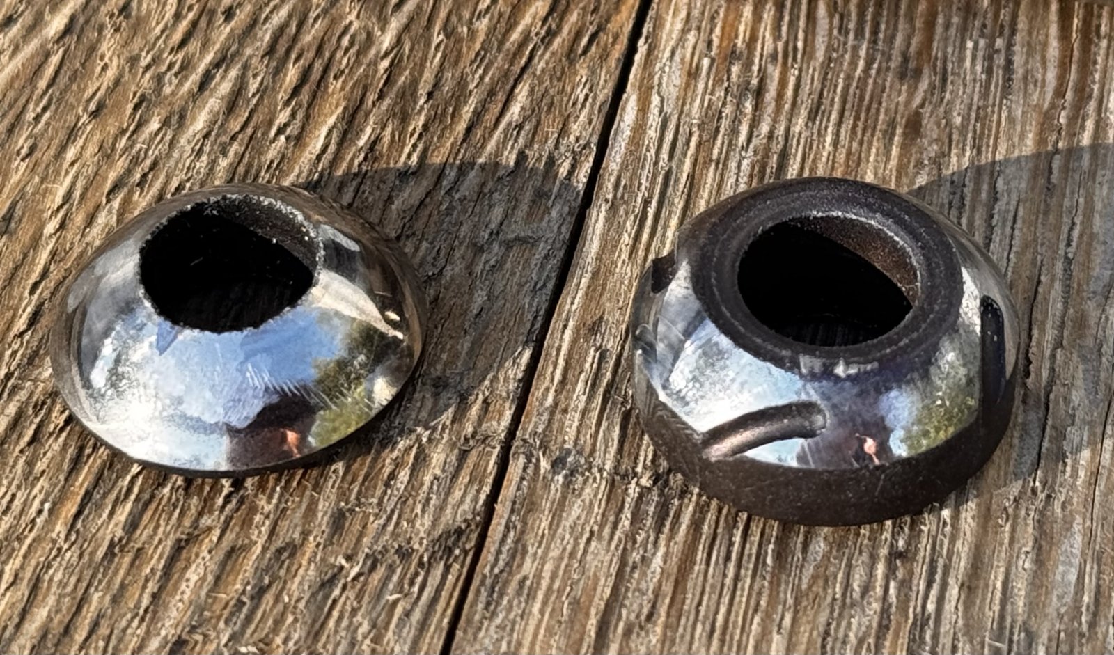

    If you know someone with a tester, rockwell the ball. If not rub a file on it. Could be soft
  17. Define_Normal
    Posts: 37
    Define_Normal
    Used a fine file and it was somewhat easy to cut, somewhere around middle hardness of things I’ve filed

    Drag a file across a good one in a non-wear area, see how it compares to the bad one. I'd be somewhat concerned with where all that metal has gone, I'd cut open the filter for a look. You could do a couple oil changes after maybe 100 miles.

    There should be some heat staining if it was starved for oil to the point of wearing that much material. The fact that it isn't file hard is a major red flag.
    I deal with contact wear on metal parts and bearings all day. Frankly i would be blown away that it wore so perfectly without smearing/galling. Dang near looks like it was short to begin with, but your other indicators suggest otherwise. I'm curious as to how the rocker making surface looks and how much glitter is in the pan.

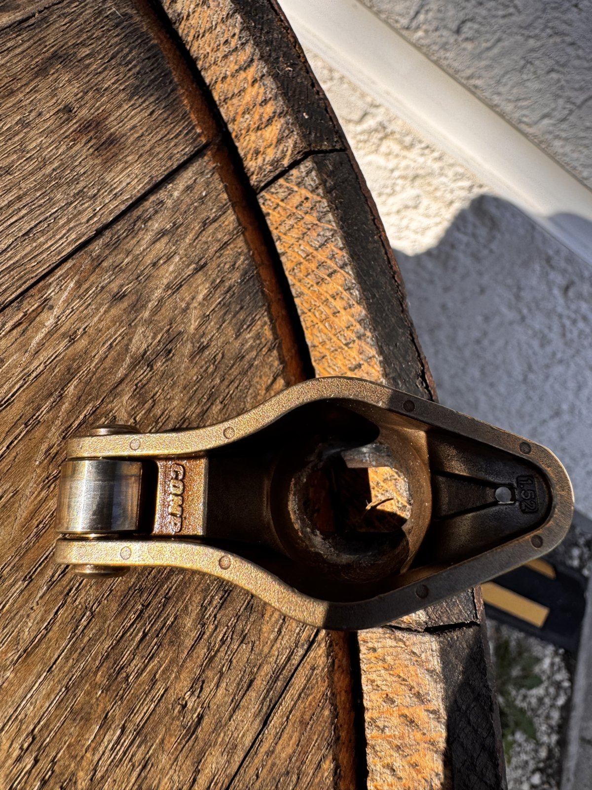

  25. Define_Normal
    Posts: 37
    Define_Normal
    Only have a pic of the under side of the rocker right now. Will get a pic of the other side.
    Rocker wasn’t dry but not dripping in oil either. The video I posted is the only pic I have before I took it apart. The hole in the bad ball pivot was very sharp around the edges.

  30. Define_Normal
    Posts: 37
    Define_Normal
    Here’s some pictures. The bad rocker is so close in condition to the good one I can barely tell which is which. The marks on the ball pivots are from my filing
