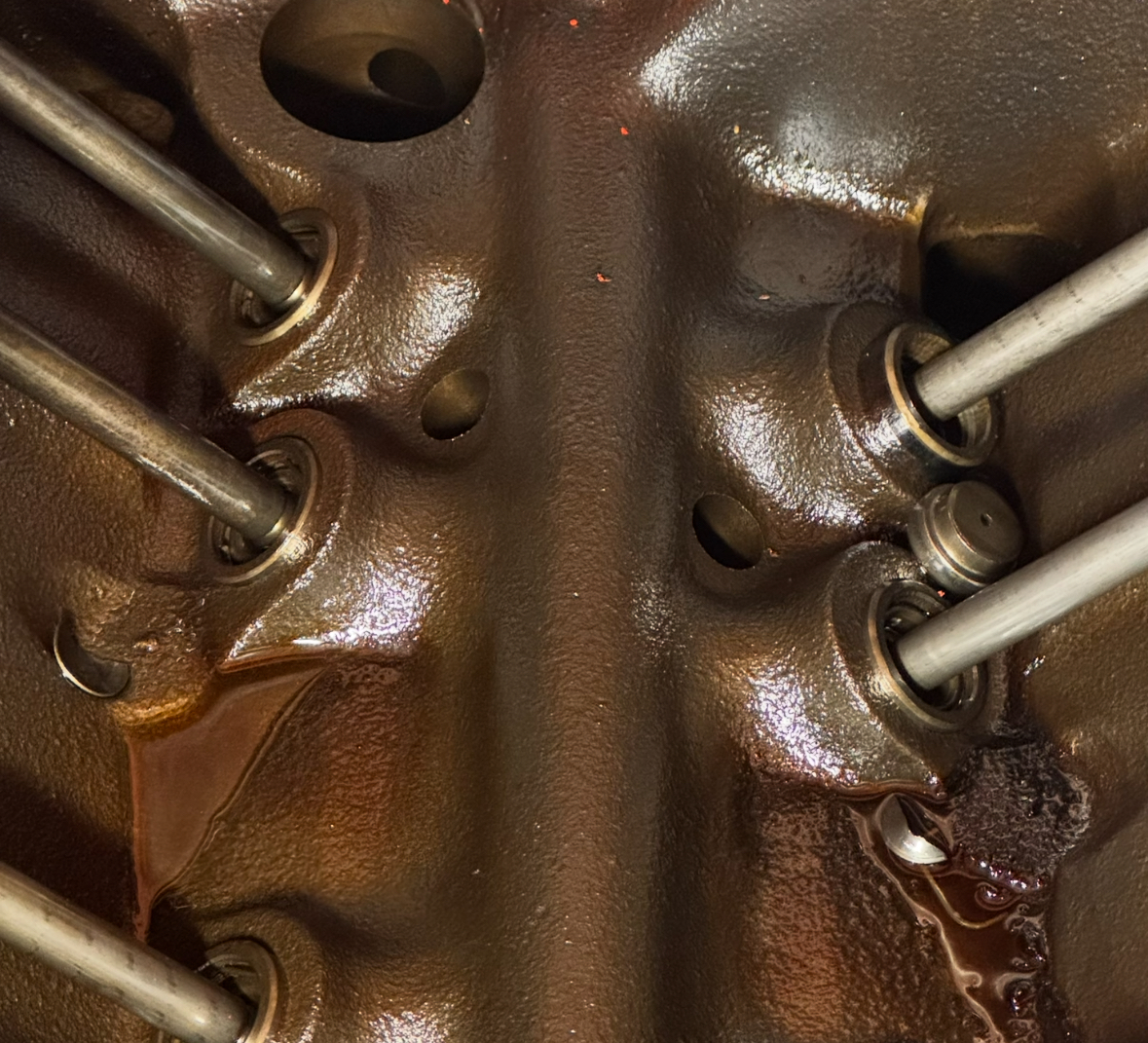

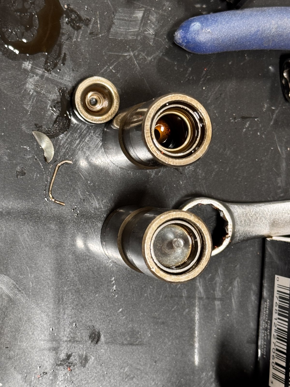

  22. Define_Normal
    Joined: Apr 18, 2017
    Posts: 37
    Define_Normal
    Found the problem. 4 lifters missing retaining clips

    Very happy you found it! And it appears maybe that it survived without major carnage!

  24. oldsmobum
    Joined: Apr 26, 2012
    Posts: 349
    oldsmobum
    from SoCal
    Do you know who made the lifters?
    Johnny Gee likes this.
  25. Define_Normal
    Posts: 37
    Define_Normal
    Perhaps. I will be pulling the motor to find the missing pieces
