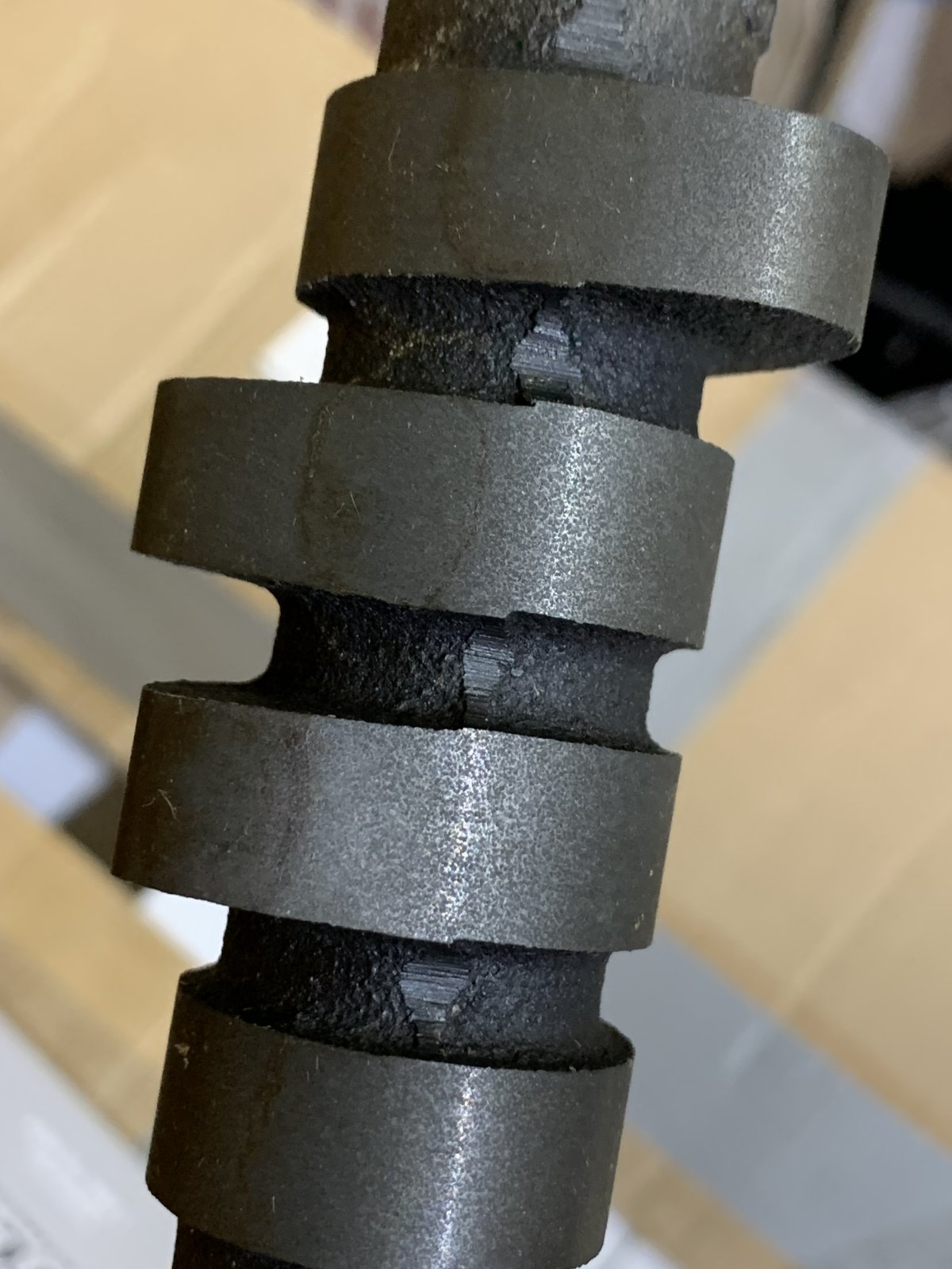

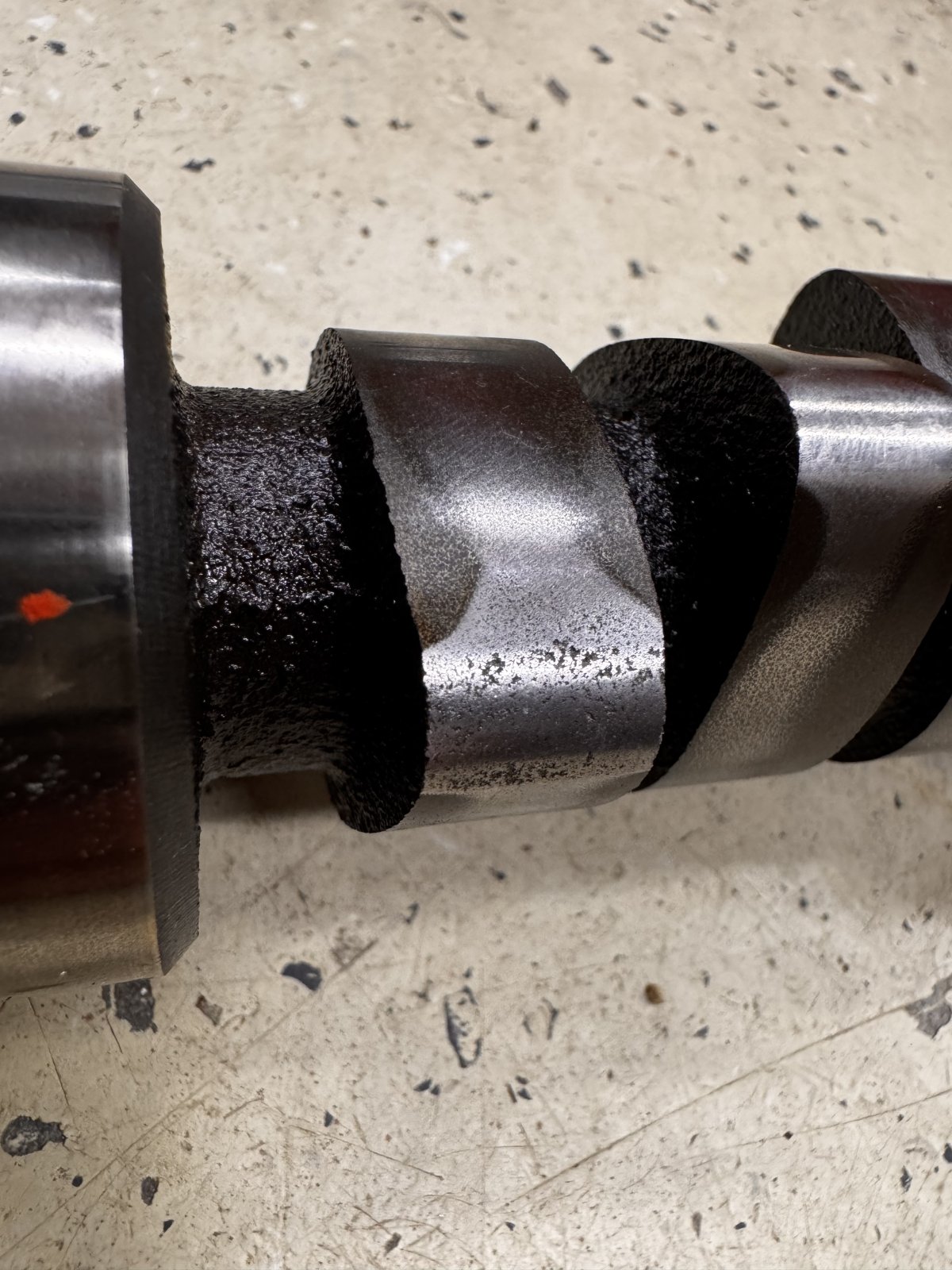

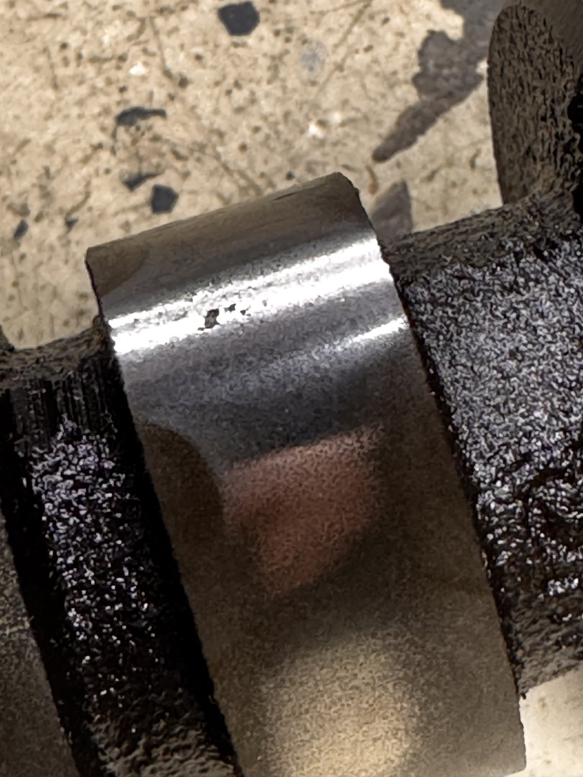

    IMG_1245.jpeg IMG_1241.jpeg F IMG_1242.jpeg I have heard good things about the comp dlc coated lifters, and even bought a set when I got a thumper cam. The cam to me looked like garbage and I wasn’t about to risk it trashing my engine. So went with Howard’s retro roller cam and isky/johnson hydraulic roller lifters. Not cheap, but I’ve seen a lot of issues with comp and morel retro hydraulic roller lifters with my extensive research, so coughed up the dough for them. I have seen great reviews on the hardened foot gm lifters summit sells and people swear by them on all the engine forums I’m on. $184 a set and haven’t seen anyone wipe a lobe out using them yet. I hope it’s possible to use flat tappet cams again because I certainly can’t afford another retro roller setup for my 283 upcoming build. Good luck with your build.

    Is the cam in your picture the one you thought "looked like garbage"? I'm ***uming that the finish on the lobes is what has you concerned. If so, the finish looks like the lobes have been "Parkerized". This is actually a surface treatment that protects the lobe finish and provides, at least temporarily, a thin layer of material that helps hold lube on the lobe surface. This can be especially helpful during the cam break-in period.
    Years ago it was common for many OEM and aftermarket cams to have this Parkerized finish automatically applied. Now it seems that many cam grinders offer Parkerizing as an extra cost option.

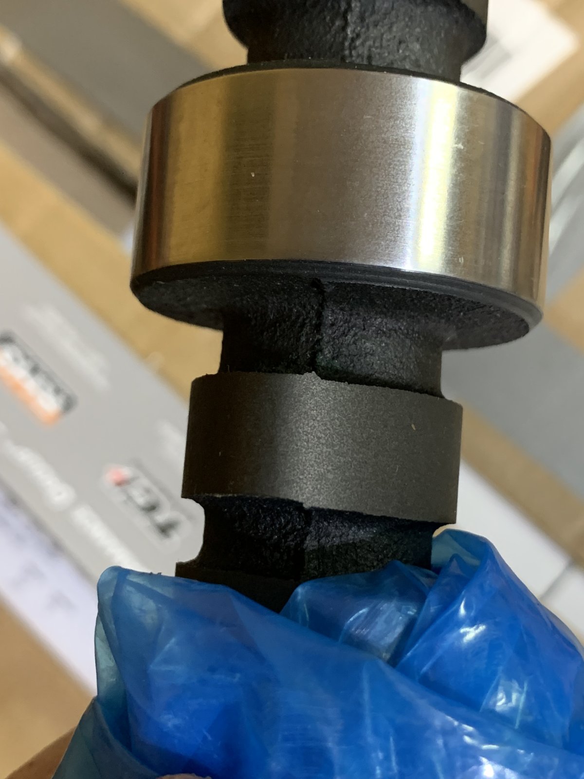

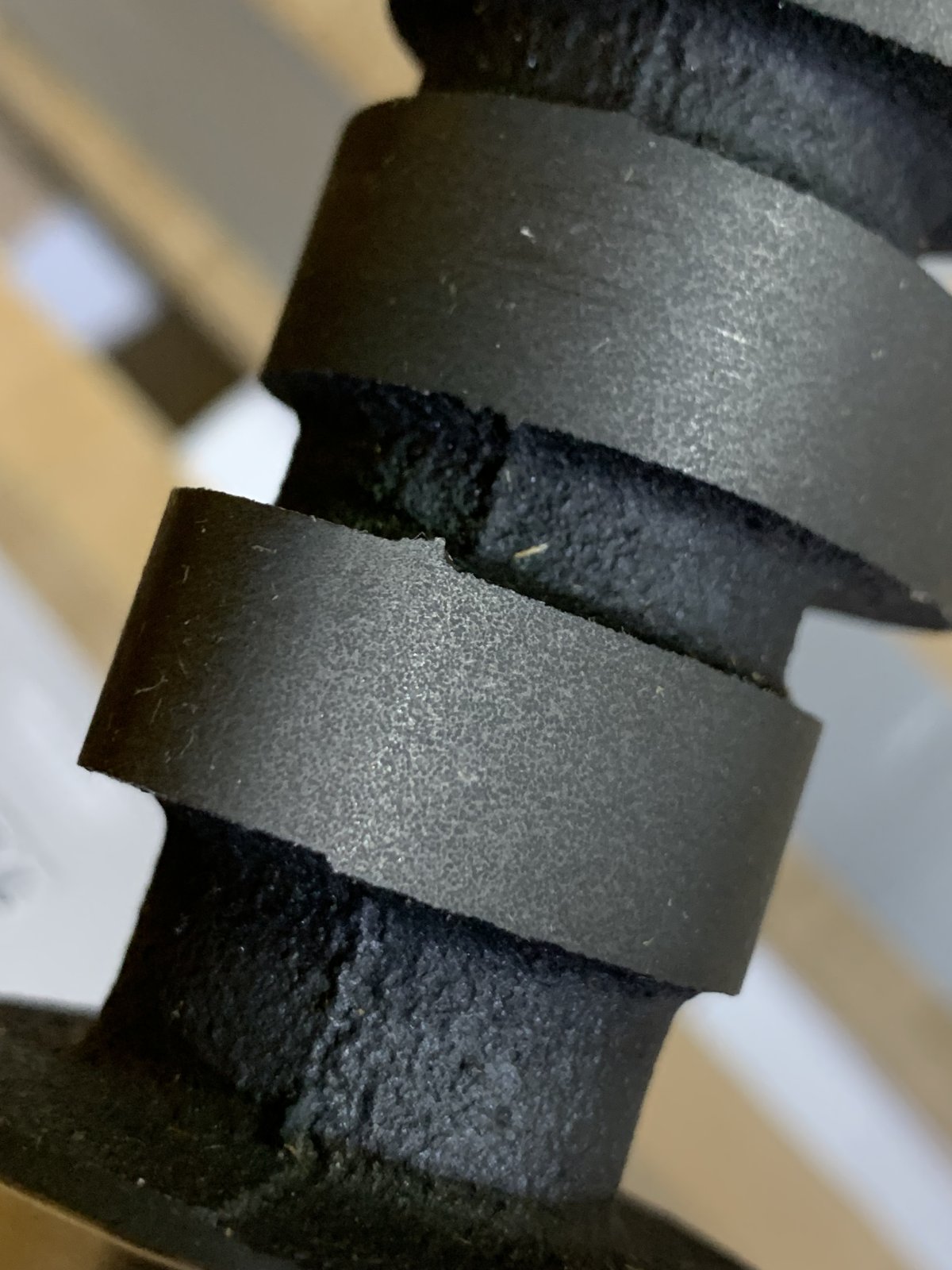

    Yeah I knew about the finish surface, I’m talking about the way the cam lobes look like they are cast off center to the other half and the sharp edges that would slice my hand putting lube on. I’ve bought a lot of cams from comp years ago and never had one look like that. I can always take the sharp edges down but I shouldn’t have to, I never did in the past. And the lobes always looked like one lobe not two cast into one, that someone shifted the mold as it was being made. They were always one straight lobe like a factory cam. Maybe I’m too picky in my old age, but these are not the comp cams quality I used to get and still have an old new xm 278 I’ll use before this one.
    jet996, Sharpone and ClayMart like this.

    What caught my eye was the Parkerized finish. I don't think it's applied as frequently on new cams as it was years ago and a lot of members here may have never seen it before.
    I hadn't really noticed that it does look like there was some core shift when the cam blank was cast. Now I'm curious to know how much of a difference it might make. Though I do have to agree that it looks sort of flaky. :confused:

    Yeah the sharp edges that I’ve never had on any cam I’ve purchased seem to be caused by the sections not lining up, like core shift. I had already waited 3 or 4 months before I was even ready to look at the cam and tried to return it, but the website said it had already been too long. Wall art maybe lol.

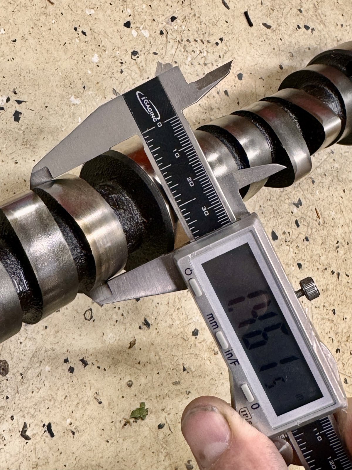

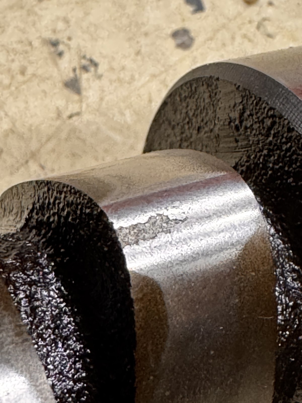

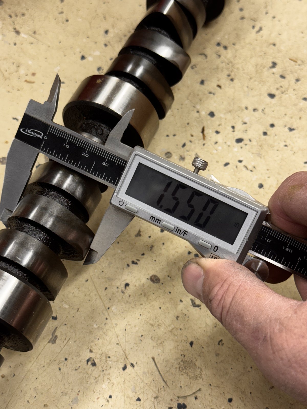

    Pulled the cam… IMG_0244.jpeg IMG_0243.jpeg IMG_0242.jpeg IMG_0241.jpeg IMG_0240.jpeg IMG_0239.jpeg IMG_0238.jpeg IMG_0237.jpeg IMG_0235.jpeg

    Yep... She's wiped. :eek:

    ****yzing flat tappet camshaft lobe wear patterns. Engine type and manufacturer can make a difference in wear patterns.

    I wouldn't regrind a camshaft that had worn out prematurely! If it didn't have a proper heat treat before it sure wont get better reground.

    Thanks the video. I found another I’m making my way thru. I’m wondering why just one cam lobe got significant wear on it, the faces on all my lifters looked intact at a quick glance
