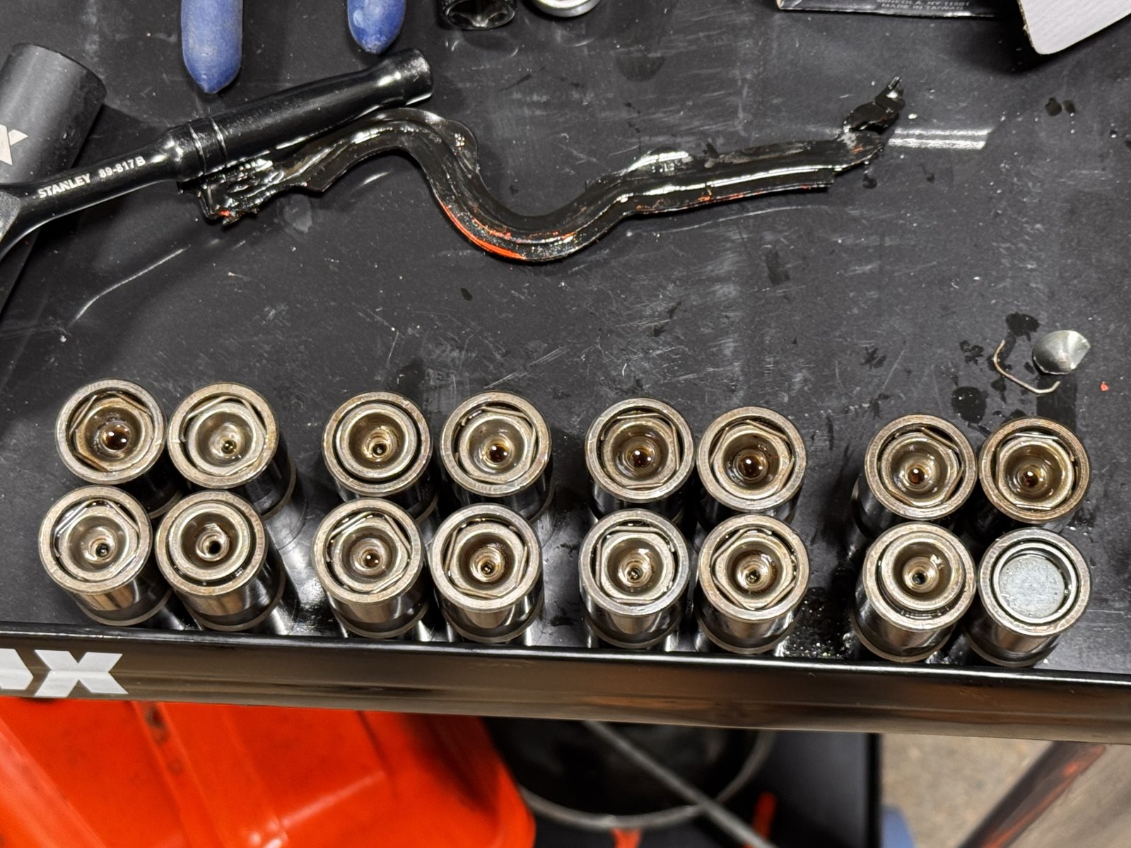

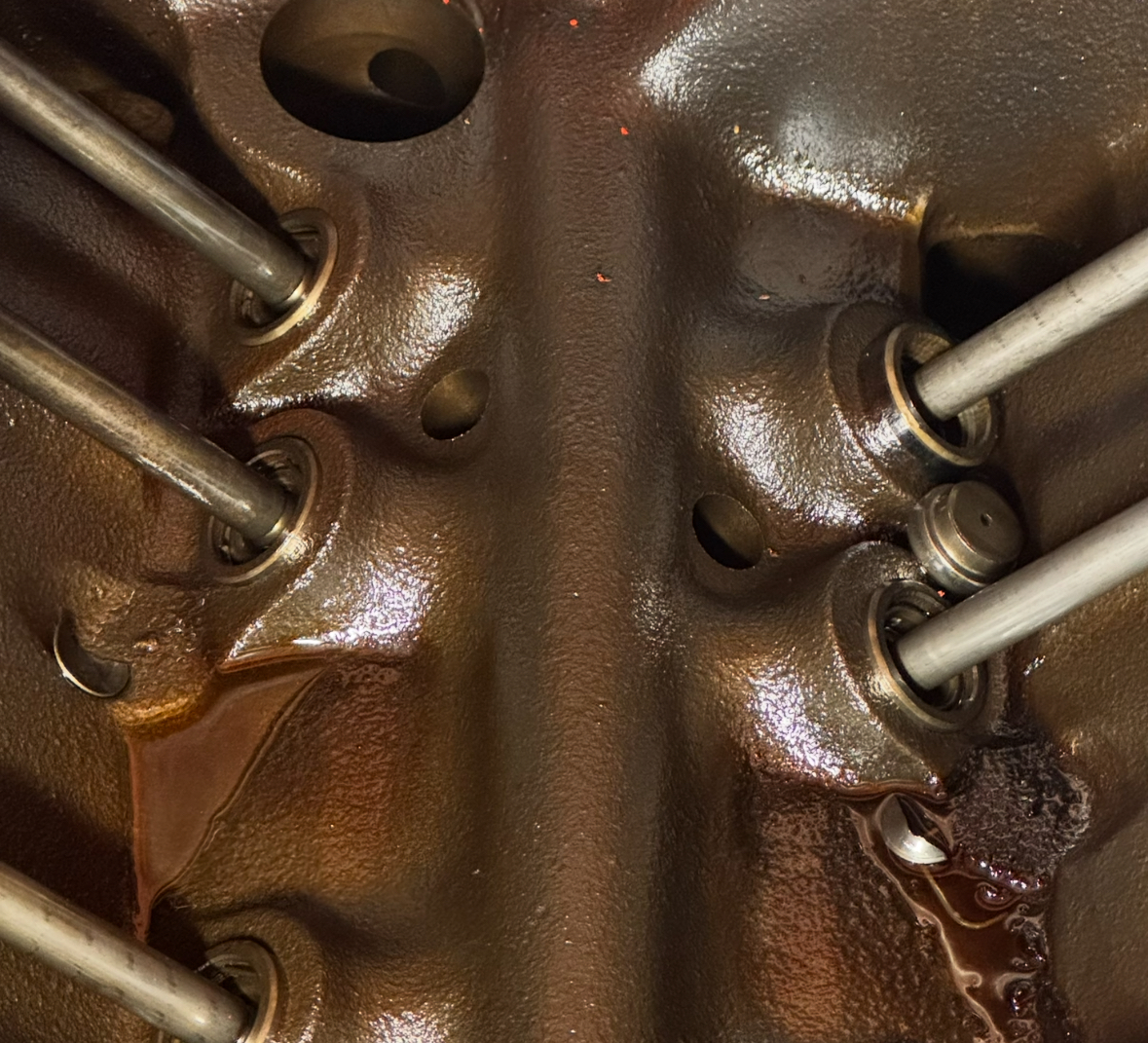

    I heard some ticking only after longer drives. Used a pipe stethoscope and it sounded like it was an exhaust leak. Changed the gaskets and noise kept up. I actually pulled a valve cover before the exhaust gasket change and everything looked fine, all push rods were tight. After the gasket change and some more miles I pulled the valve cover again to find the super loose rocker.
    I stripped the engine completely and the cylinders look decent but the rod bearings look bad, crank bearings aren’t too bad but I’ll replace them.

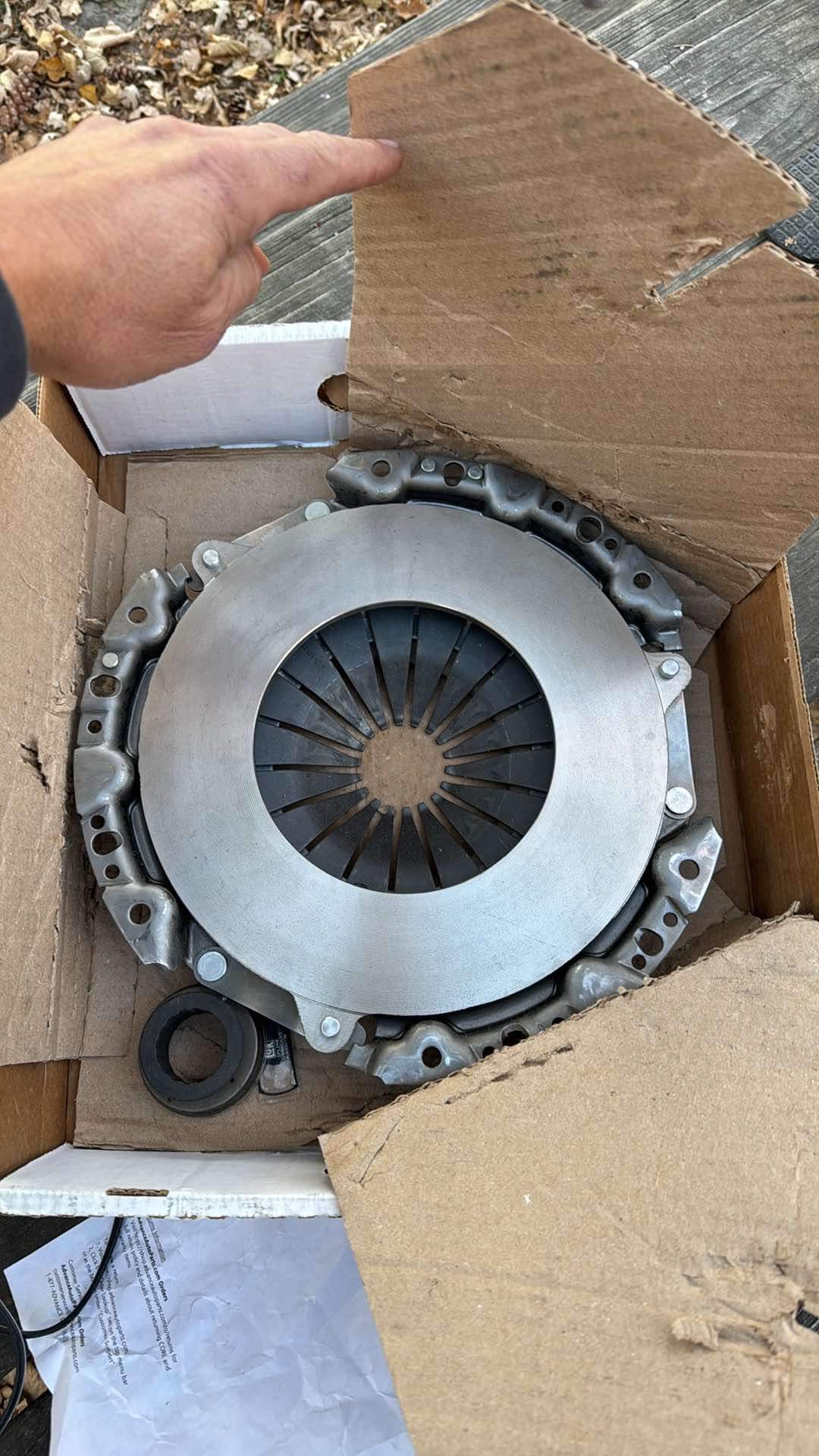

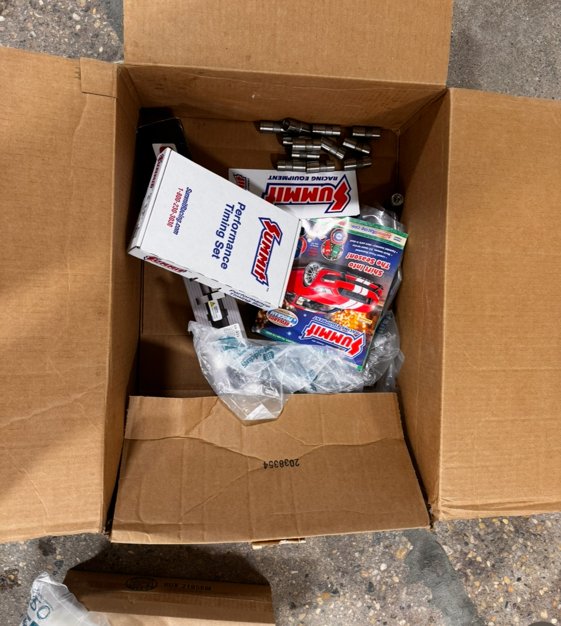

    New parts arrived
    includes, that new disc less clutch set you’ve been hearing about
    free range lifters, with convenient easy to open unsealed bag

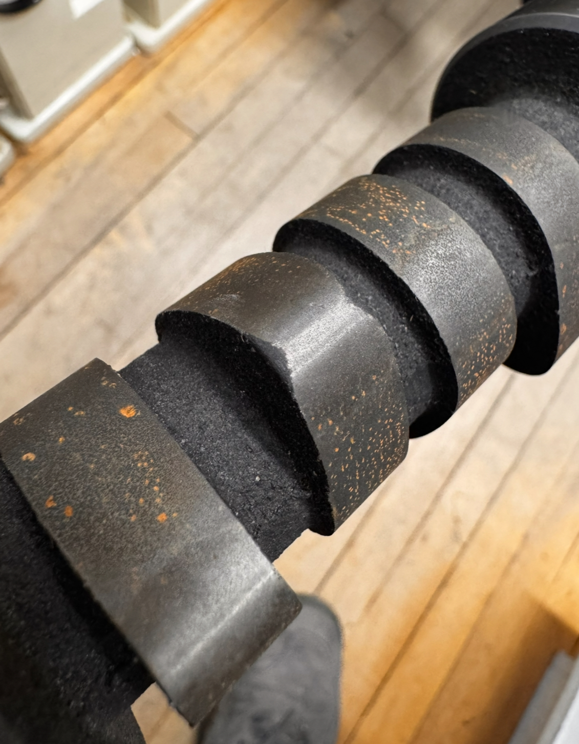

    and patinaed cam shaft

    Summit should be ashamed, they have sunk to the depths of the Hoffman Group.
    Unboxed lifters and zero quality control on that camshaft, really??? And apparently the supervisors have no control over the employees or management has cut back dramatically on packing materials.Those that have been ragging on Speedway can now add Summit to the list.

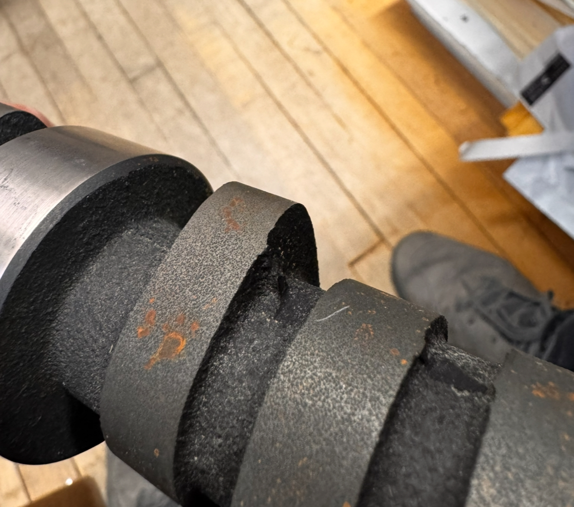

  7. GlassThamesDoug
    Joined: May 25, 2008
    Posts: 1,954
    GlassThamesDoug
    That be one ugly camshaft....

  9. Apparently Summit has run out of warehouse space and are now storing their camshafts outside o_O:eek::mad:

  10. 427 sleeper
    Joined: Mar 8, 2017
    Posts: 3,369
    427 sleeper
    I think I would be temped to send that cam and lifters back. It doesn't look like it will survive break-in. Maybe I'm just paranoid, or maybe I'd just prefer my brand new parts to not have rust on them! The nose of the cam lobes already look half worn out! :eek:

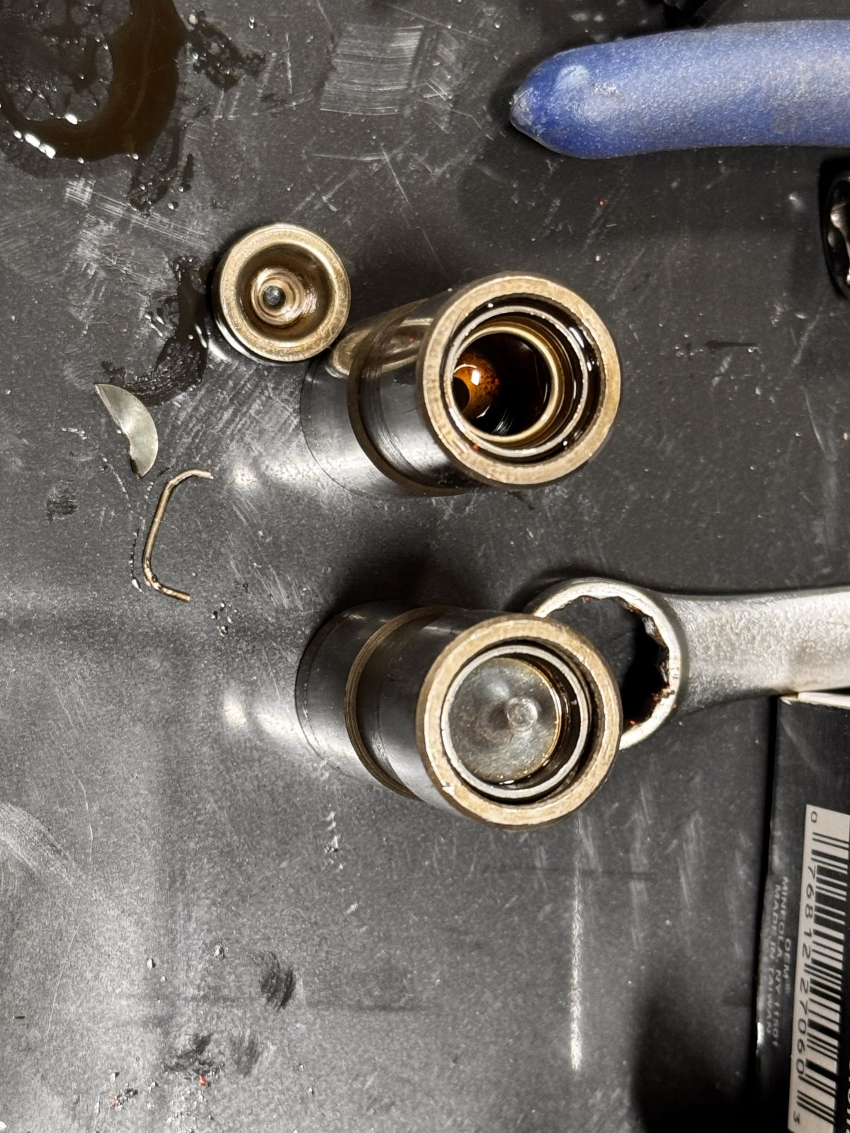

  11. Define_Normal
    Joined: Apr 18, 2017
    Posts: 37
    Define_Normal
    Lifters are marked up form hitting each other. I’m surprised they were all there going by the m***ive hole in the side of the box.
    I don’t think I’d be comfortable using that cam either. I’m wondering if this is why there is one wiped out lobe on the cam I’m replacing, it’s the same cam part number

    In ‘08/‘09 I bought a Summit cam/lifter set for a 460 Ford. Cam was in a box, oiled up, plastic kinda sealed wrap, lifters were in boxed, with individual separators.
    I am shocked the lifters were just loose like that.
    The cam as well.
    edit: I wouldn’t be tempted to send things back, I’d just do it.

  19. Define_Normal
    Posts: 37
    Define_Normal
    Summit was pretty good to deal with, gave refund on cam and lifters, didn’t even have to send them back.

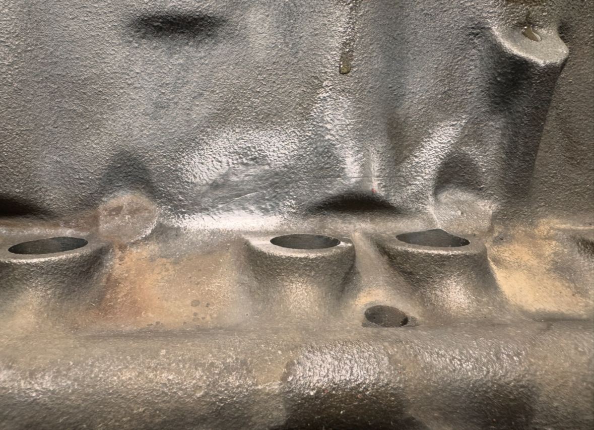

    I found a crack in the water jacket during dis***embly which could have possibly been the cause of my issues although a drop of coolant in the rad or coolant in the oil wasn’t noticed. Just working on lock s***ching it closed, hopefully that works
  20. 2OLD2FAST
    Joined: Feb 3, 2010
    Posts: 6,062
    2OLD2FAST
    from illinois
    If that's a 350 block , toss it & get a different one , not worth the cost of fixing .
