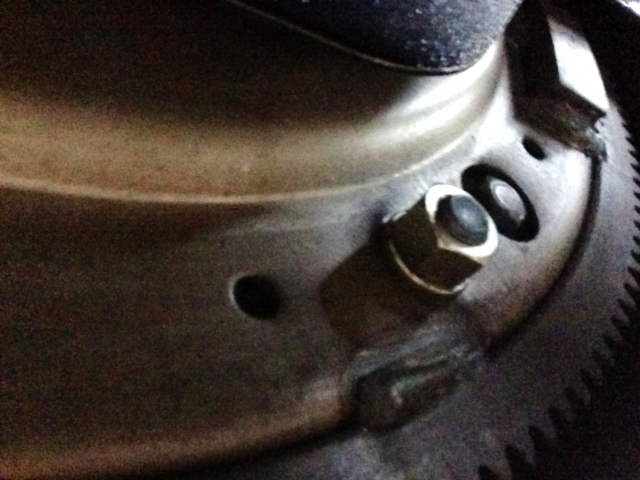

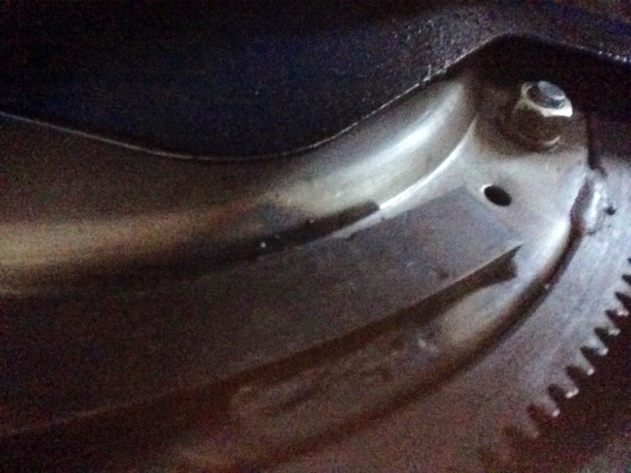

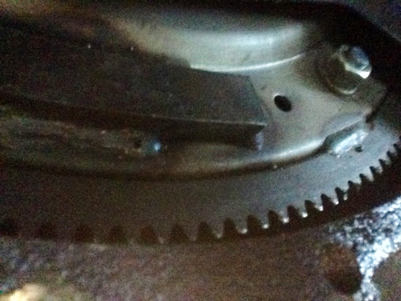

    here a few pics .. this is from dust cover access..you are seeing the side looking towards the front of the truck.

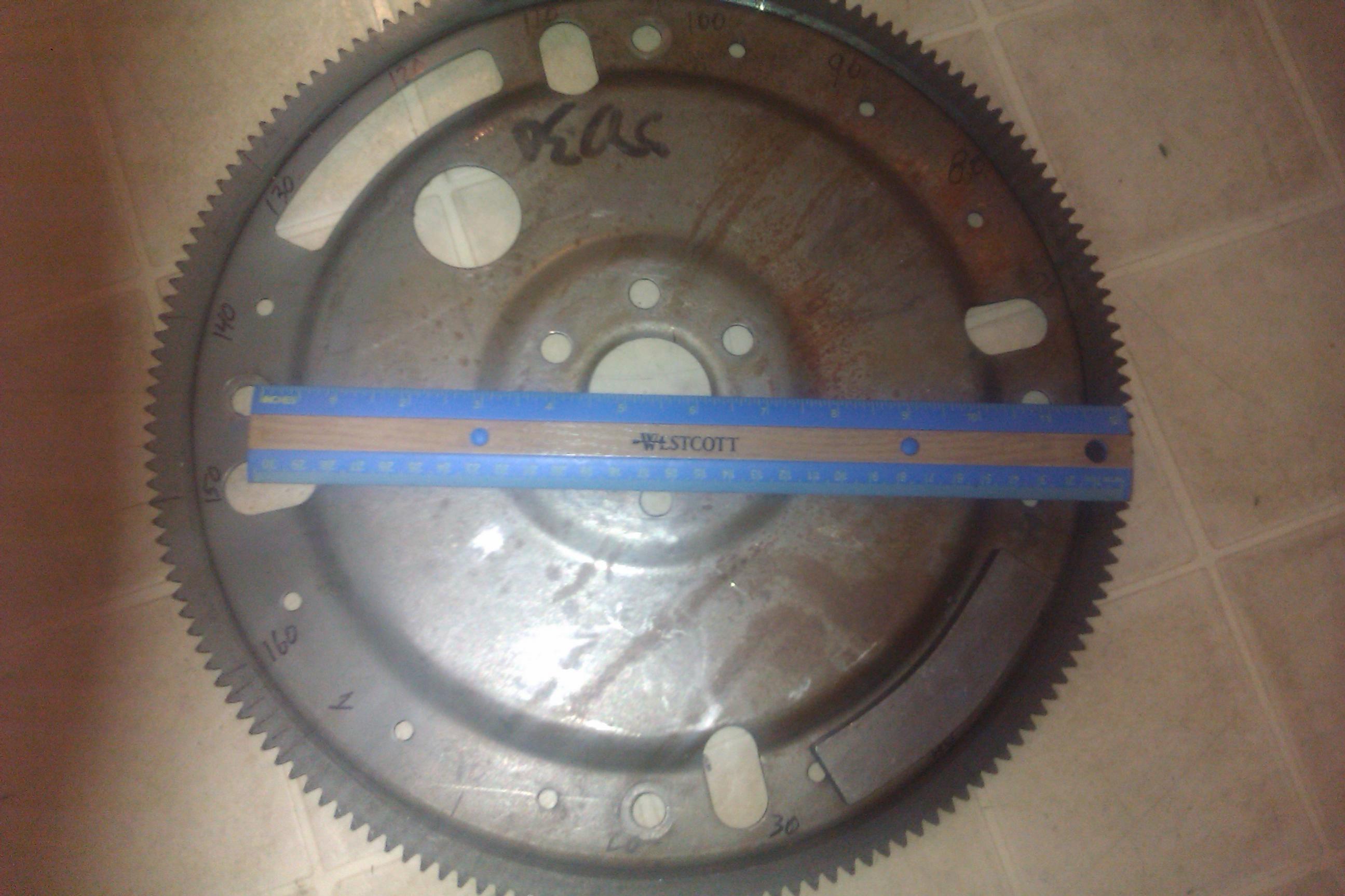

  18. The 50oz/inch F/P will also have a large cut out 180* from the welded on counterweight, does yours have this cut out? This should help eliminate some of the guesswork. TR

    Something looks funny about that flex plate. It looks like the counterweight weld in the first picture extends to the ring gear. Also the radius of the counterweight is too large for its position.
    So I wonder if this is not a stock flexplate, and the counterweight has been installed/sized wrong.
    To check for the proper location of the counterweight, turn the engine so that the counterweight is at the very bottom (six o'clock) position. Now note where the TDC mark on the damper is. Post this, and I'll mock up an assembly from one of my crank/flexplate/damper assemblies to see if it is in that same position.
    bradlovesjunk likes this.
  20. I posted a pic of thee correct F/P. I see that the O/Ps flex plate looks almost home made because the counterweight does not seem to have a curve or radius, so I somewhat agree with you. It could be the picture I don't know. But ultimately we need to cut out opposite the counterweight. TR

    broken and worn teeth on the ring gear.seems like it would be a good time to replace anyway.

    amazing thing is that is a NAPA replacement for a stocker.. I see what you are saying about the teeth.. this truck may have about 7k miles on it. like I said earlier if the motor comes out ok.. and its the plate.. im going to invest in an AOD and put my 3.70s back in.. at that point I can put in a new clearly marked 50 oz quality flex plate.. open to recommendations.

    Mine looks nothing like this.. it looks like
    this somewhat.
  28. Last edited: Feb 17, 2013
  29. X2
    Its obviously fucked up in a few ways if adding washers makes it 92% better vibration wise.
    That weight looks goofy too.
    Even if you change your trans in the future , I'd change the flex plate now.
    What about OEM instead of off shore " should be close enough to 50 OZ. just add washers if it isn't" junk ?
  30. Beanscoot
    Joined: May 14, 2008
    Posts: 3,550
    Beanscoot
    The B&M flexplate does not have a clear counterweight, at least to me. However, here is a Hays flexplate pictured on the Summit site with no cutout, just a counterweight balanced at 50 oz-in:
    Compare that to the counterweight on the suspect flexplate. It certainly appears that the suspect unit has the smaller (28.2 oz-in) imbalance weight.
