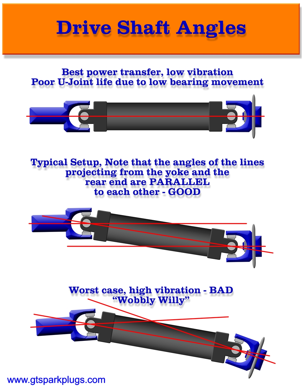

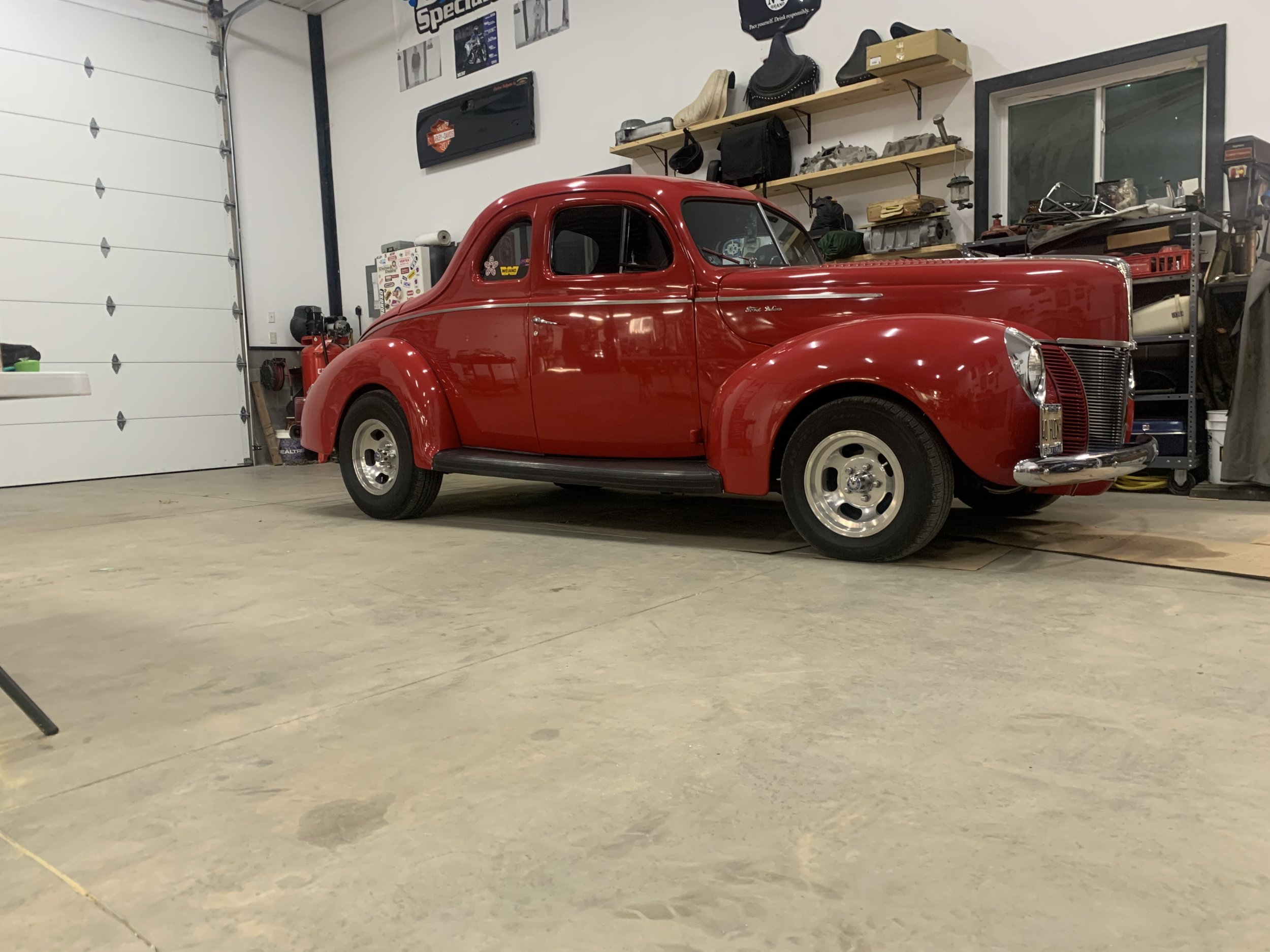

    40 ford ,56 Chevy rear end. 327/4 gear Replaced rear springs and perches. I thought I had the pinion angle right ,but maybe not. Pinion angle off give good vibration?
  2. Rear axle angle?
    Engine angle?
    Driveshaft angle?

    Yes. An incorrect pinion angle can give a vibration. 55mph is also roughly the magic number for out of balance wheels, so might be worth getting that checked out early in the investigation. Also check that everything is tight after your spring swap. And why were the springs changed? Tired perhaps? Maybe their condition was masking an underlying condition?

    Well I shimmed rear end 2 deg down. Helped a lot. Also found that the engine is surging or hunting at higher steady speeds. Don’t know if it’s the dual point or carb. But I do have another distributor I was going to install.

    I was taught that a small amount of angle increased U joint life . Is this a fabbed drive shaft ?
