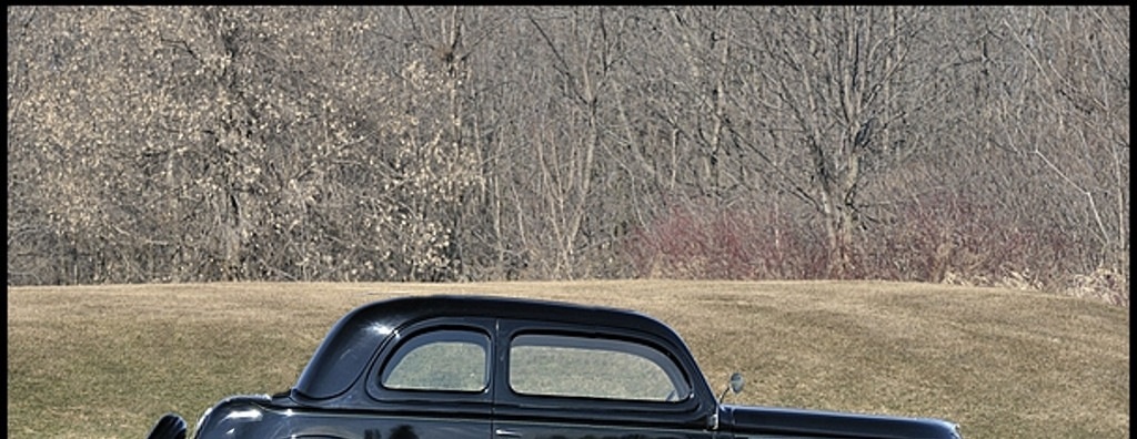

    Here's a very nice '35 Vicky that a young guy used to bring to the Anti-Donut breakfast in Huntington Beach from time to time. The metal work was done by his dad, who was from somewhere in the Northwest:

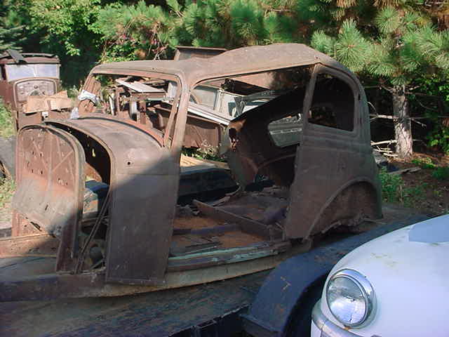

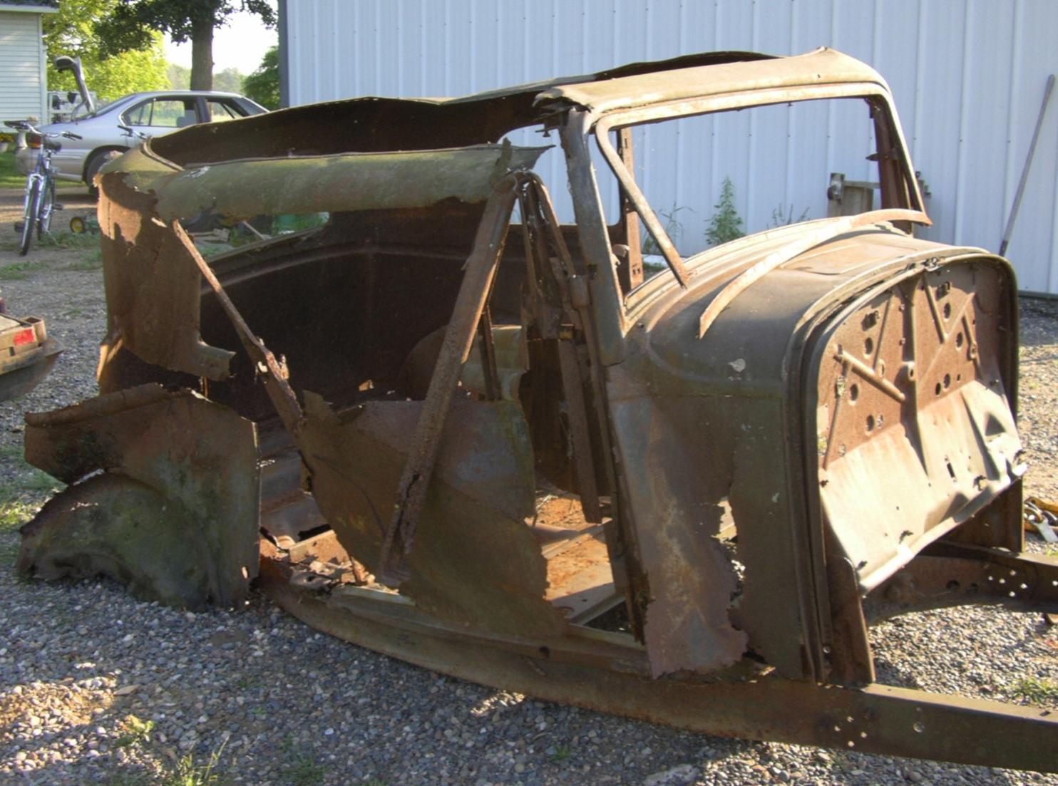

    Maybe ill have to do some hunting, im sure i know a bunch of guys that now the Samsul brothers, I have wahts left of a vicky and would love to do a clone, maybe the ch***is still out there and i could have a really good start to it!
    Heres a few more pics of mine, i was on my way home from picking it up and a deer jumped out from the treed and jumped right in front of the vicky on the trailor and nailed the cowl, messed it up pretty bad, what can your do!

    Do the vicky and the 2 dr sedan share the same doors?
  11. titus
    Joined: Dec 6, 2003
    Posts: 5,206
    titus
    Nope, different, i think the length is a little different and i know the height of a vicky door is just a tad shorter.
  12. big duece
    Joined: Jul 28, 2008
    Posts: 7,073
    big duece
    from kansas
    So, a nip-tuck-chop would cure that.
  13. edwardlloyd
    Joined: Aug 2, 2003
    Posts: 2,074
    edwardlloyd
    from Germany
    Looks like you were in for some metal work anyway. Ch***is looks good. Tudor doors can be modified to fit. But that is about as bad as they get before disappearing completely!
  14. The37Kid
    Joined: Apr 30, 2004
    Posts: 32,743
    The37Kid
    I think the '32 Vicky Cowl is unique as well. Bob
  15. I'm not sure on the 32s
    But the 30-31 is Vicky only doors. They are longer, slant windshield, and there's plus minus 1.5" factory chop vs other model A s depending which one you measure or where you measure. The belt lines are the same so you can make a A Vicky door with a slant windshield set of doors. 4 dr Slant window cowl can be chopped to Vicky size.
    I've seen Vicky back half joined up to a coupe doors and cowl, and a 4 dr doors and cowl and it looks a tad off.
  16. titus
    Joined: Dec 6, 2003
    Posts: 5,206
    titus
    The main cowl itself should interchange with the vicky, its the upper section of the A pillars and roof that attaches a the seem above the windshield pivots where i would ***ume the hieght change would be.
    i still have whats left of the cowl from the viicky but only have was good, at least usualbe for measurements.
    I have a tudor cowl, tudor doors, tudor B pillars and a tudor right quarter adn tudor subrails and tudor roof that all will be modified into a stock unchopped vicky, or so thats the plan. i do have the rear subrail section from the vicky that will be grafted onto the tudor subrails. I am actually planning on roughing in the body this late winter or fall so i dont have a bunch of junk laying around!
