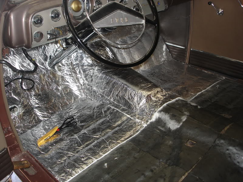

    Thanks to Kiwi Kev I have a 3.00 gear set for the rearend.

    I don't remember the name of that shinny peel and stick sound deadener stuff but I think if you spray a sound deadener / rust inhibitor on, it will form to any shape with no air spaces (that trap moister) and is just damned easy to do ! Carry on.

    Thanks ned...I think lowes has it.

    lobucrod on here sells it.

    I used some black stuff called Q-Pads by Evercoat. They are extremely easy to form to the floor with a heat gun. Then over that, I used some MightyMat that is also very easy to work with. Here you can see the Q-Pad and the MightyMat over it. I can really tell the difference in the temperature and sound deadening.
    The guy sells MightyMat on ebay for a decent price http://cgi.ebay.com/ebaymotors/MIGH...ptZMotorsQ5fCarQ5fTruckQ5fPartsQ5fAccessories
