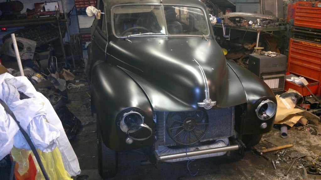

    Bit more done. i have one export red lense and i am in the process of tinting the orange on one other.
    Not the best painting by far but just need it watertight.

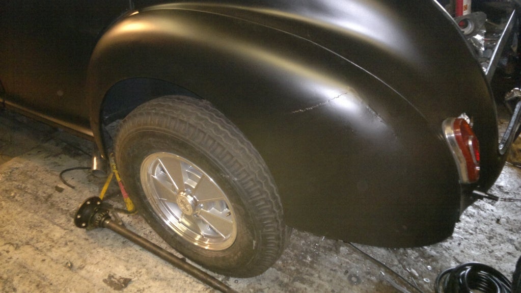

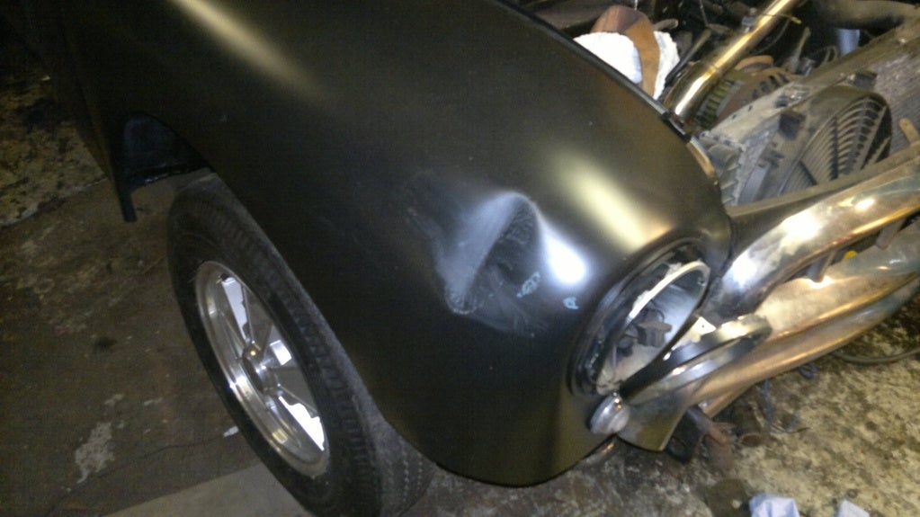

    Had a slight dumb moment today, the gas bottle has not been sitting in it's proper position,ie, on the back of the welder and all the welding has been just down one side, so i go to move the welder and the bottle stayed where it was until it tilted and wobbled but to late, the front wing luckily took most of the shock and then it bounced on the floor ******ing the gauge. lucky the panels are not the best ones.lol.
    Also gave the rear wings a blow over, i left the dents and warts for now as i want to source better ones later on.

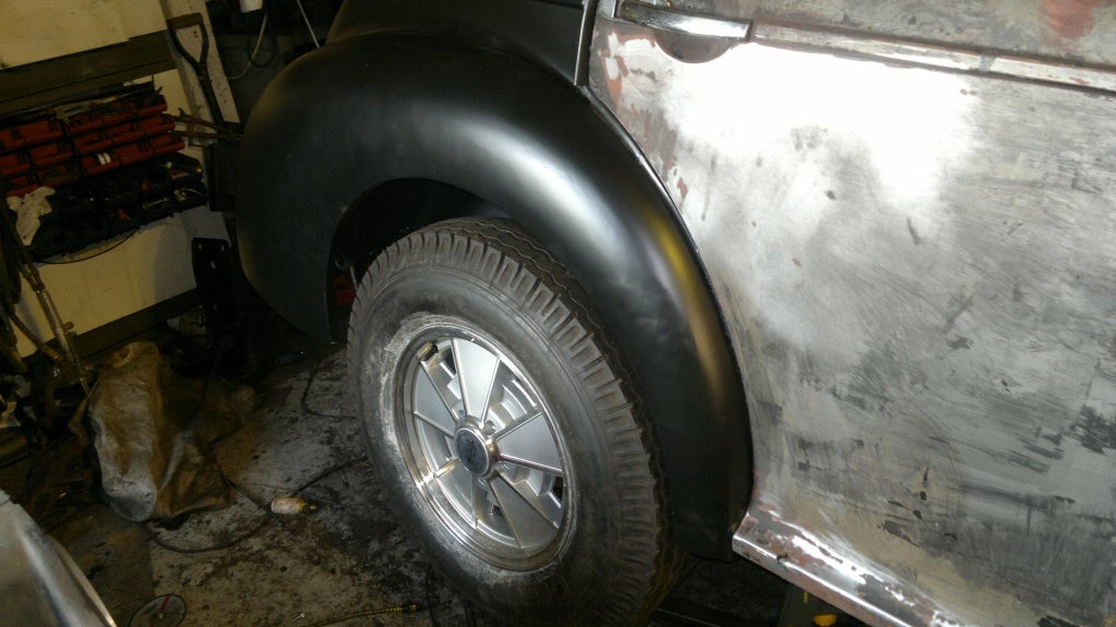

    Missed a couple of weeks but had a bit of time up there today, little jobs always take so long.
    The twin coils are now mounted so the wing had to come off and on again.
    The rear wings are bolted on both sides.
    The exhaust is all bolted up and also heated the the front out let to bend back abit because I want to run the same back tyres on the front.
    The rad is finally all bolted in,so basically i was just bolting stuff on.lol

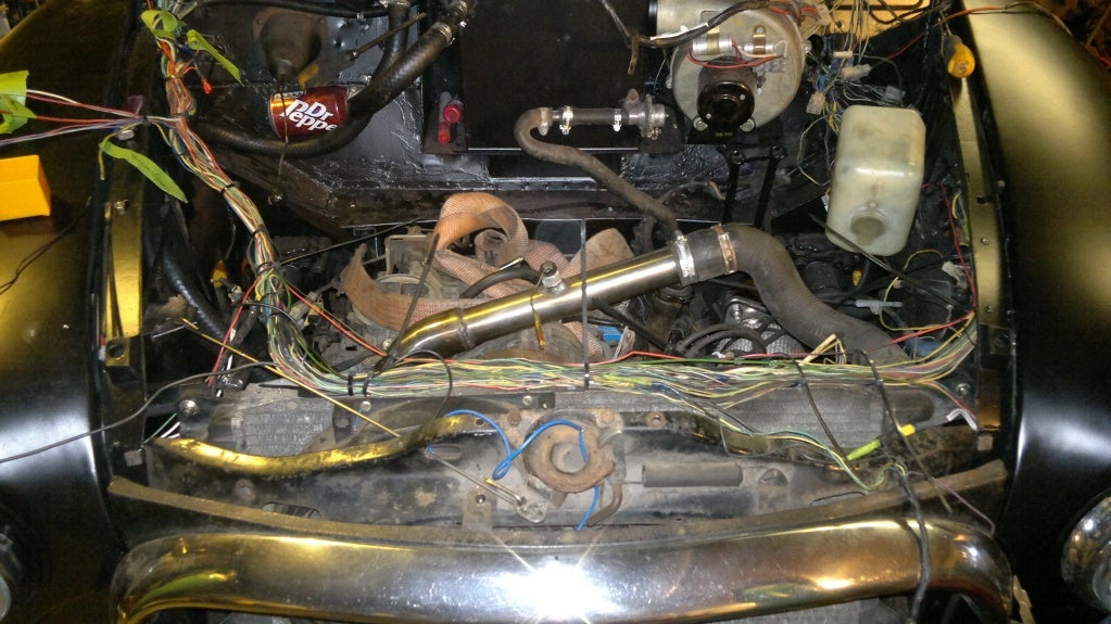

    A crazy mess of wiring, I am using the mazda loom to make life simple, well hopefully anyway. the loomtape has been taken off and the bulk head throughs have been cut so now its just sorting where it all goes under the bonnet. I have deleted some so far including the pop up headlights so the plan is to connect all the bits i know then look in the manual to see whats left and cut out whats not needed.
    Some areas will need shortning so all this will be done at the same time. Also i am only starting with the wiring under the bonnet then the wiring to the rear of the car and last but not least the inside of the car, as the steering column is the mazda one that should be okay.

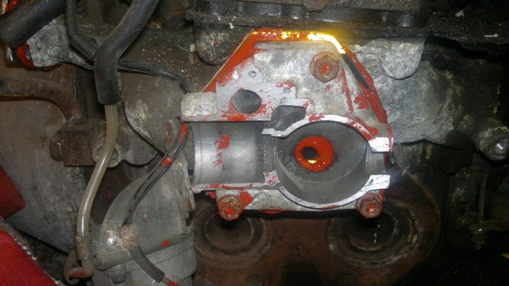

    Hi, the front tie bars from the outer torsion bars to the front xmember as it would have been will now go to the new engine cradle as this is removeable is not in the picture. Also still need to make the brackets.
    Also as can be seen in the picture is the inner wings are not symetrical at the ch***is. one side is wider than the other. Why i do not know.

    Here you can see the engine mount/ tie bar mount, unfinished in the picture, there are two gussets to go on the vertical tubes either side with a bolt through the ch***is to stop forward and rearward movement , but you can see how the tie bars will tie in and in the postion.

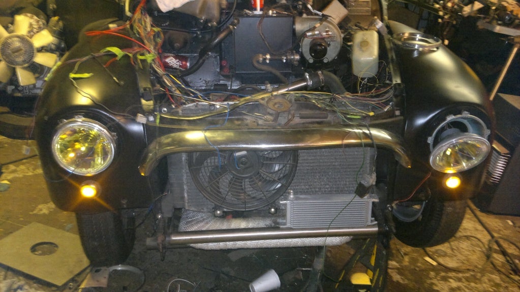

    well not much to report, just got up there today and a mate pointed me in the right direction with the colours as i am colour blind, so once the wires that i was unsure of were marked i carried on.
    I have got most of the front loom shortened and going to where it should.
    The rear lights are wired plus the fuel pump wiht the fuel gauge as well.
    inside all i have managed to do is connect the column
  30. vin likes diesel
    Joined: May 9, 2007
    Posts: 203
    vin likes diesel
    Well, i have now got some electrics after a few problems, one being that the plugs to the column switches 2 of which are the same so my wiper plug was on the head lights vice versa.
    side lights all round
    indicators and hazards lights
    main and dipped
    electric fuel pump
    number plate light with third brake light
    all dash lights.
    Thats about it for now
