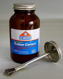

    One of the best items to put over any surface, to protect and seal is rubber cement. If a good layer of rubber cement is put on top of a metal surface, it will protect what is underneath. Then, when one is finished with the surrounding spray or body work, etc, then the rubber cement can be rubbed off or peeled off.
    The neat thing is that most rubber cement cans come with a brush and now, you can brush it on the plate.
    Once the plate is covered, then dry, spray what you want. The surface of the plate is covered with rubber cement and protected.
    Jnaki
    upload_2025-5-11_4-20-15.png There are tons of brands and some are found in most biug box stores or art supply stores. The brush is handy for all applications. The tube versions, one has to use your finger or a spatula to spread out the rubber cement.
    When you are finished and the surrounding area is dry, then the rubber cement can be rolled off of the plate to stock appearance, again.
    Fair warning:
    The aroma coming from an open container of rubber cement is powerful. If you are finished with rubber cement, cap it asap. Or put some clear stretched Saran Wrap over the top(and seal the open area) if you are doing a lot of spreading with the brush.
    (The aroma will fill a two car garage fast and inhaling it for a long time is hazardous to your health...)
    Afterwards, the brush can go back in and cap the bottle for the next time of usage. YRMV
