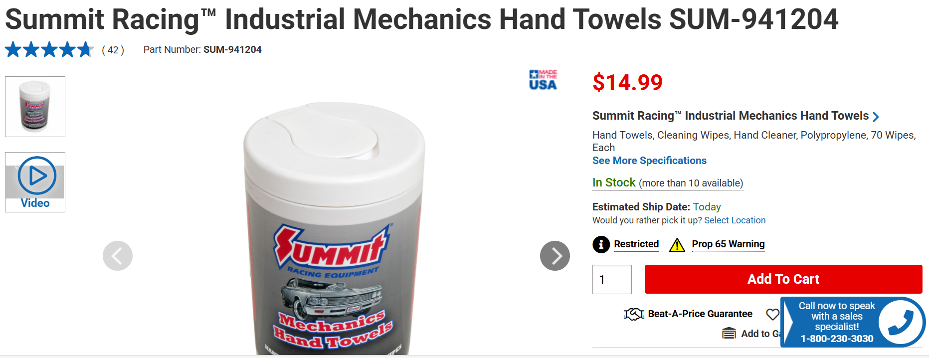

    I love these! They clean my hands even after painting cars. They clean my tools, and they will clean that plate likely. One side is abrasive, one side not. Orange smelling. I have them in my trailer, in my shop, in the house.

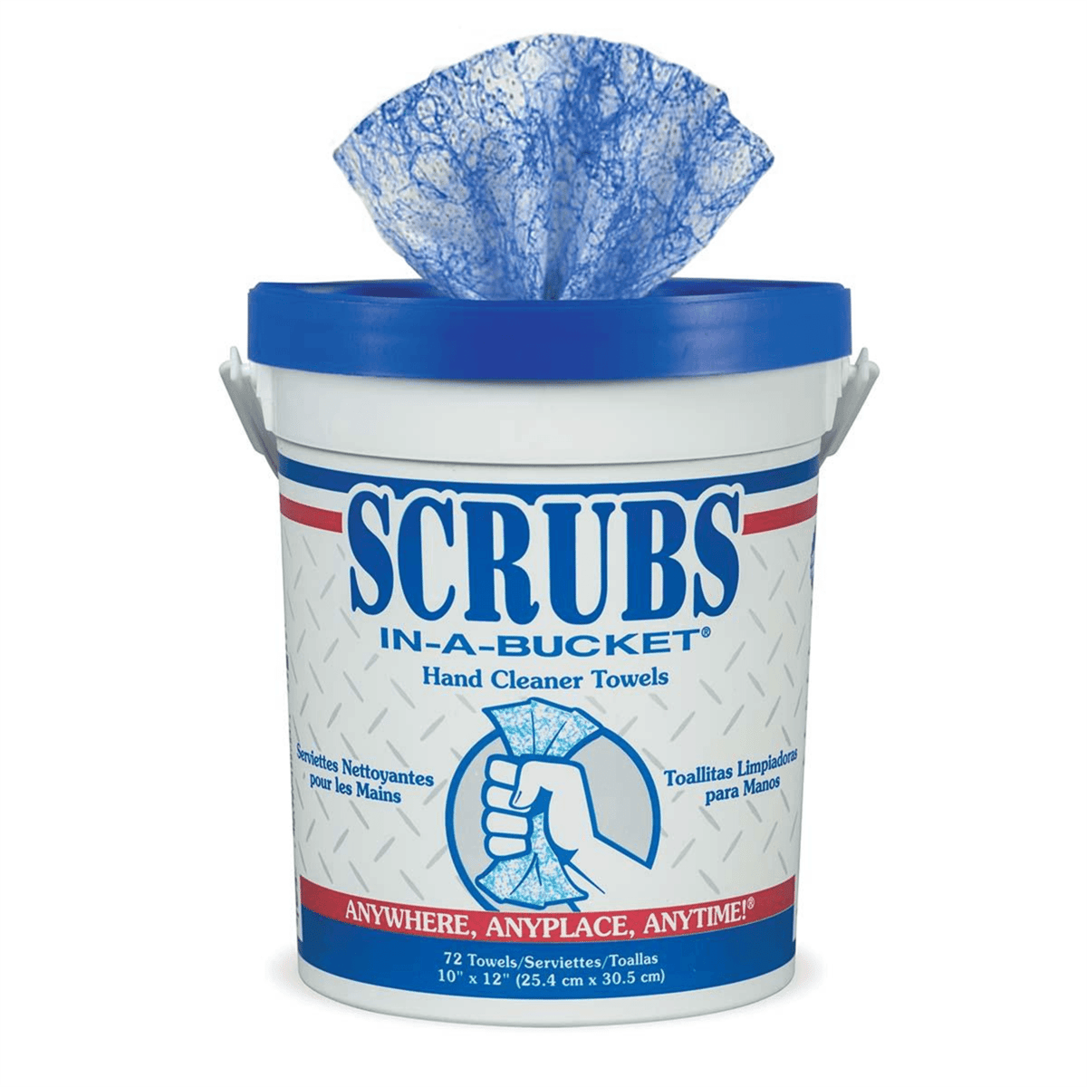

    Good idea @Bandit Billy. My go to is Scrubs-In-A Bucket so I'll definitely give them a try.
