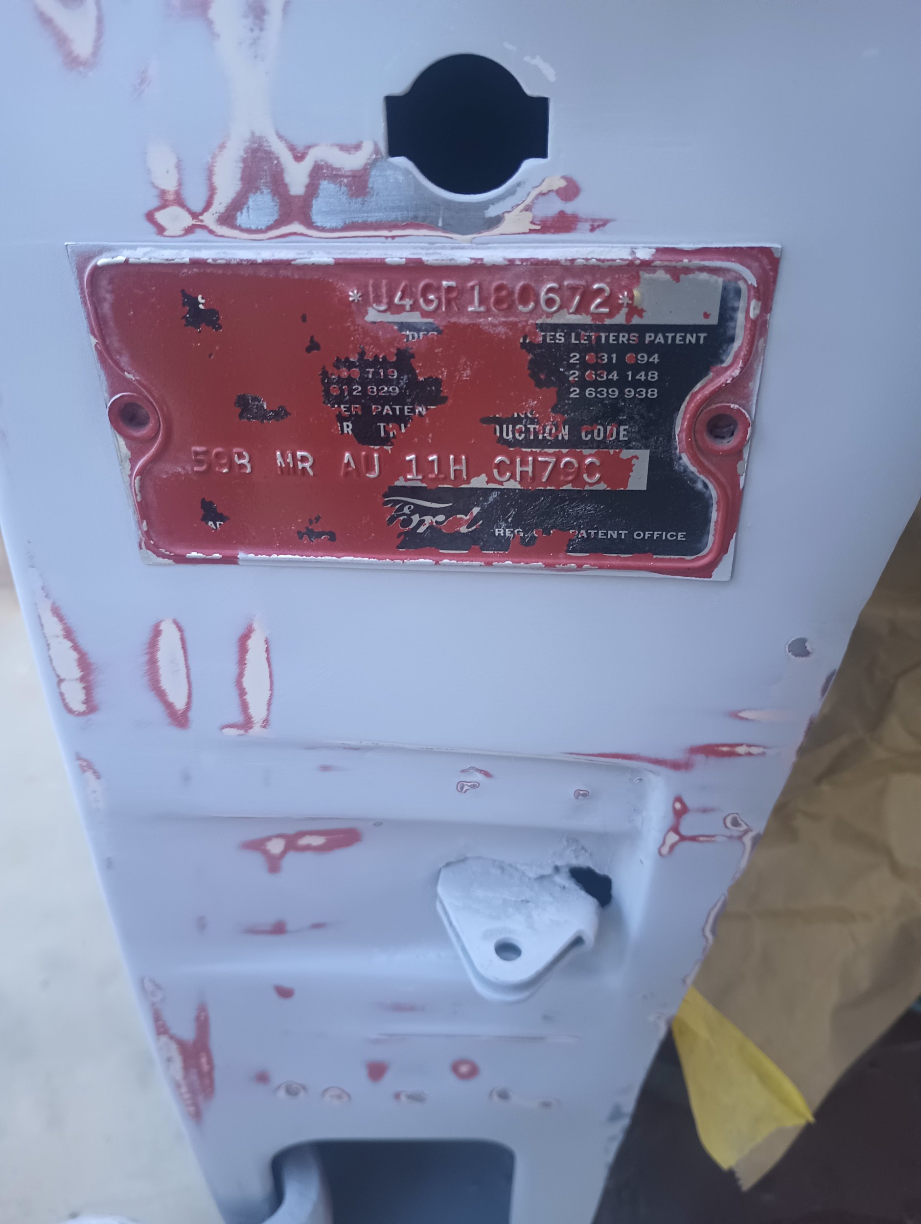

    Never thought I start a sh*t storm with this. But the hand scrub didn't work so Gorilla tape is currently on the plate and we'll see what red paint gets removed when I go to the shop in a bit. Photos to follow.

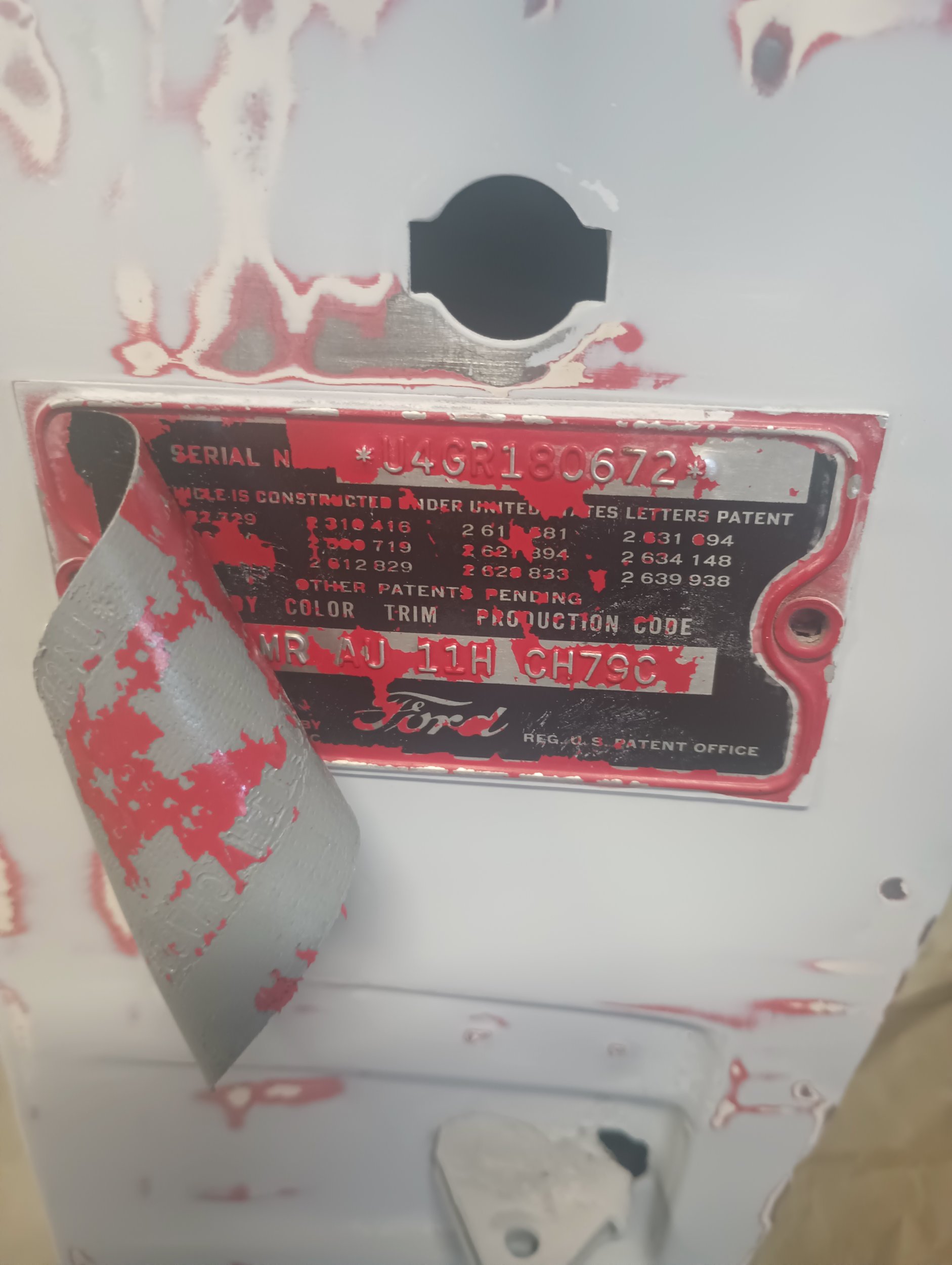

    Before and after photos. Applying another payer of tape. Will let it sit in the 90+ temp today and see if there is anymore progress.

    It’s working. I like to use aircraft paint stripper. I have successfully removed paint like that without affecting the underlying paint. But keep at it and you will get it where you want it.

    Do it a few more times, and then ignore it.

    Tape technique is working great, and not hurting original paint / anodizing at all.
    Make sure you mask it anew before the new paint job!

    Wow, your tape results reminds me of removing a price tag from a newly purchased and valuable swap meet part (why the hell do sellers put sticky tags directly on paint??!)
    Anyway, I think at this point you could use a Q-tip and acetone to carefully remove paint from the VIN number area and the embossed perimeter, where there is no underlying black.

    finger nail polish remover light on a rag. try a corner ist. should come right off
