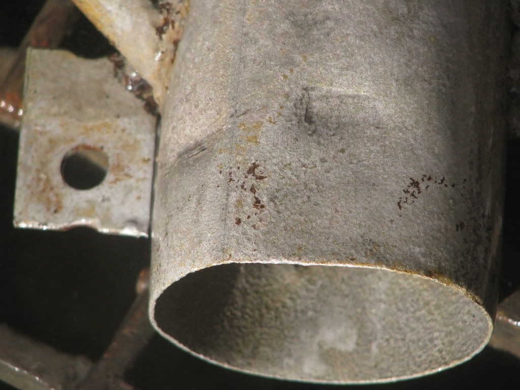

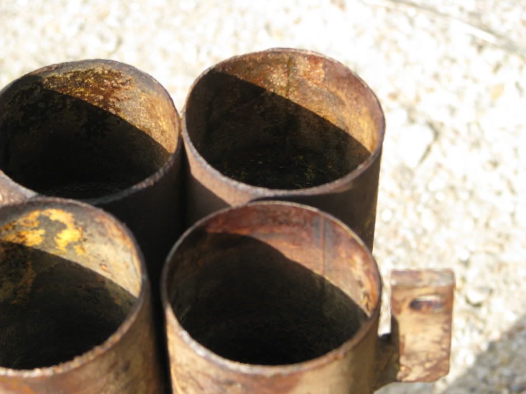

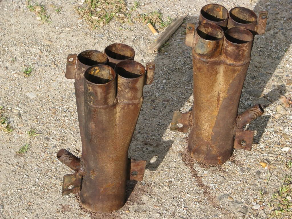

    Figured i'd put my experience in here. Got some $75 swap meet headers last year that had slip on collectors so i chucked them in the rubbermade tote with 5 gallons of generic grocery store vinegar and the brake drums off my 67 chevy van axle.
    The drums came out great- they'd grown orange fuz all over the machined shoe facing, and it came off great with no damage in about 4 days. Sorry-no pics.
    The collectors were left in a total of about 8 days due to life getting in the way of my grey matter. This may account for the rough texture in some spots, but i'm not bothered by it at all. Well not much...:rolleyes:

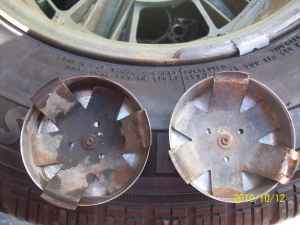

    Do any of you know if it will react with stainless? To be specific, I had a stack of Pontiac Rally IIs and the bottom wheels center cap spring steel got a bit fugly. I saw mention that it may mess with springs how so? Thanks!
