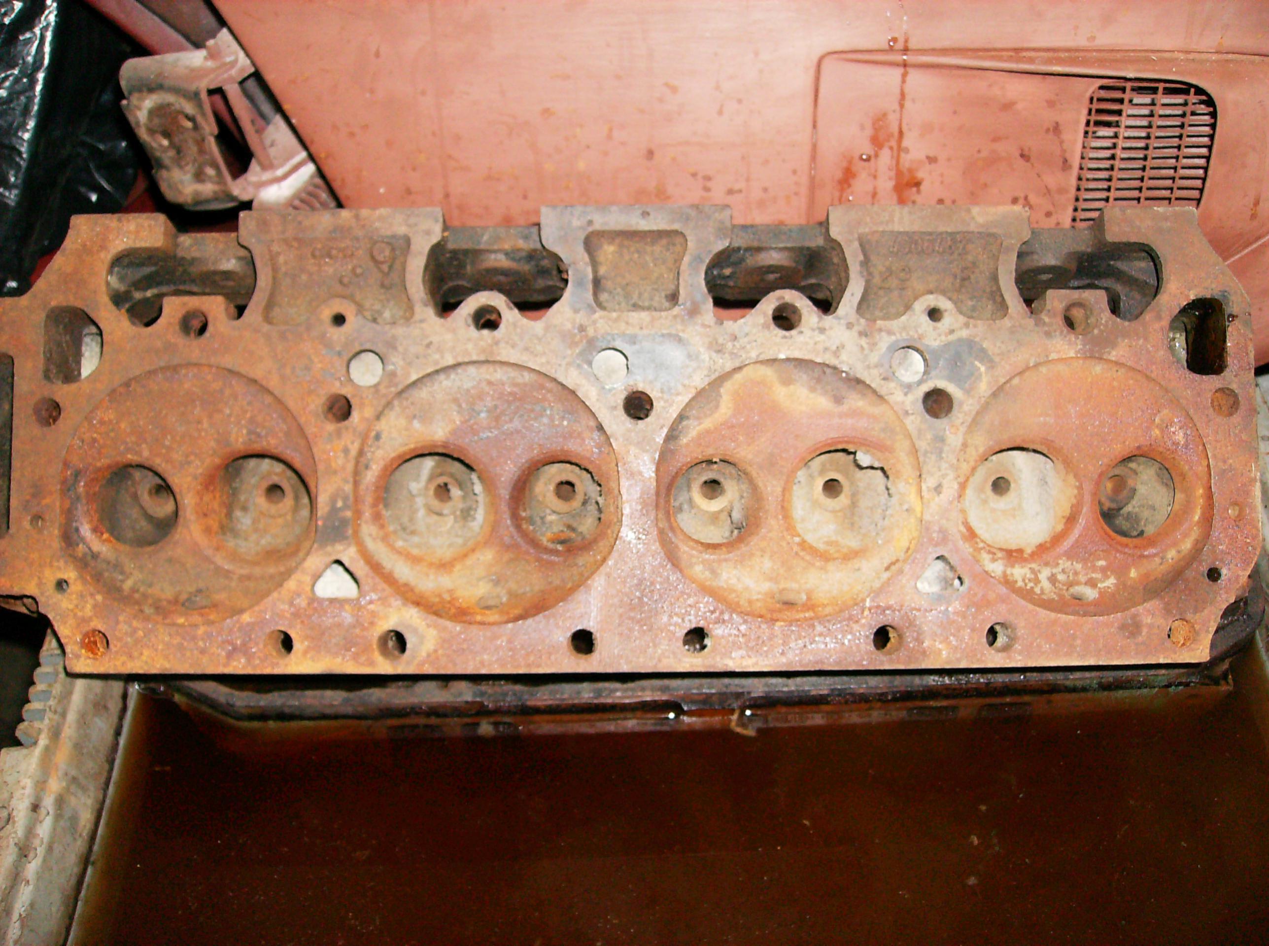

    This is my Dodge 440 Head. It has been sitting in the corner for some years now.
    My buddy on the H.A.M.B. ask me to try this experiment with the vinegar.
    I am hooked now.

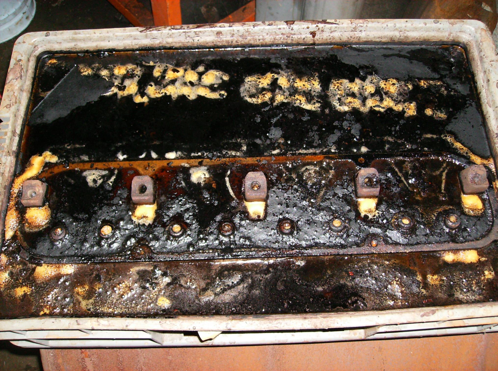

    Rusty Head , Head sitting in the vinegar on week 2 and after spraying the head off with hot water. I used a Arm and Hammer Soda solution to wash the head in..One 5gal bucket of water and add about half of box of the Soda..Wash head in this solution to neutralize the vinegar.
    I sprayd the head with PB Blaster to protect it .Until i use the heads I will put them in a tank of kerosene. These heads are now ready for a port and polish job.
    Thanks to my buddy RAY C's son for asking me to complete this experiment.
    More to come I am hooked.

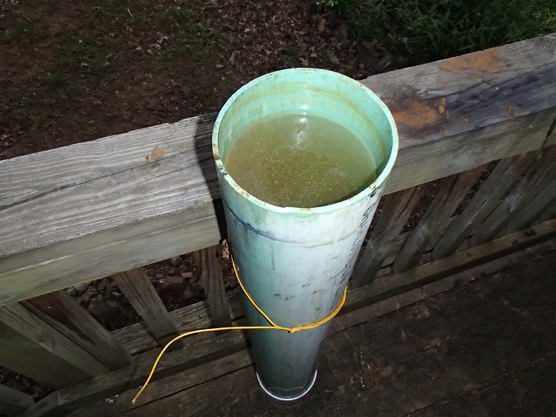

    I just made the PVC vat last week an submerged my '61 Plymouth Bumper Grill guard in it. Yes the vat has a lid to keep the vinegar from evaporating. The back side of the grill guard was heavily rusted inside of this guard. I let it soak a week and took course steel wool to the inside after I pulled it out of the vinegar. I then washed it in hot soapy water and rinced and let it dry in the hot sun. I then painted it with Rustoleum. Vinegar will not hurt the chrome.
