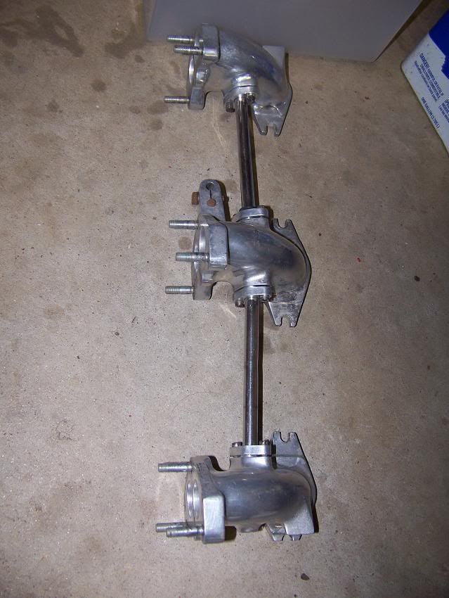

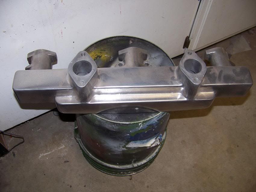

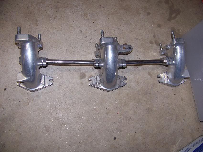

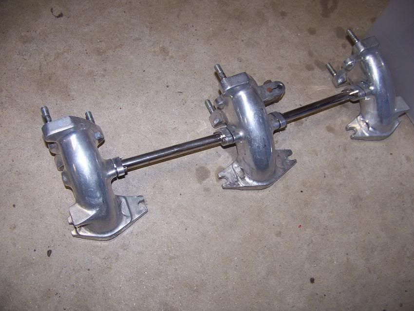

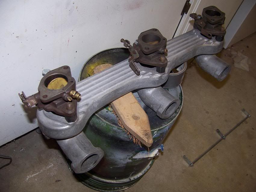

    Alright thought i would share most of our inliner intakes.
    First up nicson dual carb. Got it for 200 after letting the seller keep the carter carbs and traded 3 holly 94 parts carbs and one carter. Has a pretty sweet story on it too. The seller ran out of gas after comming back form a show(he deals in intakes) and this guy walks up to them gives him gas and asks if he was interested in some stuff he had for sale. Took him into the garage to a awsome 54 chevy truck with a 235 with a split stock exhaust manfold(with the heatriser cut out) the nicson dual carb intake and wayne valve and side cover. He said he was going to trow it out since he will make it a prostreet truck:( Anyway the seller we bought the stuff from was smart enough to take all the parts
    Old mcgurk(early with no name casted in). Got this intake from the same seller that we bought the nicson from. First we bought an ellis from him but it wasnt for a 235 so we traded it back in after sandblasting it and cleaning the carbs. Cleaned this one up alot. Dad sand blasted it.
    Ok this is the last one we have from the same seller. Also a nicson but a triple. Got it for 200 bucks(just like the dual carb). Dad polished it up nicely and its now sitting right at home on my 58 chevy truck.
    Ok now we move on. This one came from a hamber Stovebolt. Old no name mcgurk(more castings were done back in the 50s with various companis selling it) We got it with a linkage and 3 air cleaners. The bases on it now were for a mock up we did. I think we bought it for like 450 dollars not quiet sure anymore.
    This is our harper. Also came from a hamber. 450 bucks i think with 3 94 parts carbs(traded those off). Its in awsome condition and dad was very happy when i told him we had a chance on one of his dream intakes
    Here is the intake that got it all started. This i think was owned by a hamber but we got it off of ebay for 235 bucks. Its an old mcgurk 270/302 gmc intake. I was looking around on ebay for the 235 mcgurk tripples and found this. I thought the ports looked the same so i bid on it. Got outbid but mom and dad kicked in alittle and it was mine. Got it home and found out it didnt fit. Then found out it was kinda for my dream motor a 270/302 gmc. So no i have the intake but no motor:D Anyway it makes a great wallhanger.

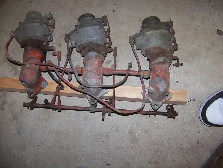

    Now here is alittle twist on all this. Dad and me went to the big 3 swap meet this year looking for as many rochester one barels as possible. We came across this. Asked the owner what it was(this was sunday hadnt seen it saturday) and the guy was like u know what i have been asked this questions so many times i am sick and tired of it. I want 100 bucks for it. So dad looked at me. Well it had the carbs linkage good condition. Dad offered 60. Guy thought about it for alittle and was like u know what i dont wanna be asked the damn question anymore u got a deal. Took it to our friend(the seller where we bought the nicsons and the dual no name mcgurk) and asked if he knew what it was. He said he talked to the owner on friday. One friday he wanted 350 for it so he offered 100 bucks but the seller said no. Our friend didnt know what it is either. Went home and posted it here which got some clues to its orgin. Found out it could possibly be a boats intake. Did alittle more searching and found out its a intake from a chris craft boats intake. We think it was worth the money. I will modifie it alittle to get it to fit a 235(i will have to slant the bends back to get the carbs to sit straight)
    We got one more intake at home but dad took it to work with him so pics of it will come later on. The other intake is a thickstun swirl intake bought from a fellow hamber also.

    Well, there ya' go.
    Like my father used to say, you learn something new every day.
    Nice editorial, WITH PICS, on your intake collection.
    Did you find out exactly what engine the Chris Craft intake fit?
    If the name you came up with is marinized, I might[]/i] be able to decipher it for you, but it would just be off the top of my head.
